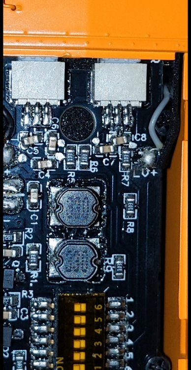

  10. I might try that, I wanted to check lest I cause damage by doing so. I'll report back if it persists. Though I'm somewhat doubtful it's the drive train as it sounds more like coil whine, but I'm happy to be proven wrong. No issues that I can see not that I'd notice without comparing, just adding it on the off chance it was related. I'm not familiar enough with the circuit board layout to tell what they're for. The blacked out traces makes it difficult to tell if they should be connected or not.
  11. I'm just wondering if I should be concerned about a high pitched whining that my 121 has started making. It only occurs running cab first. 121 high pitch whine.mp3 It was in the middle of running in cab first when the high pitch whining began. It was running in on a H&M Duette but also occurs when run with a HM 2000. There also appears to be a short between two capacitors. C7&C8.
