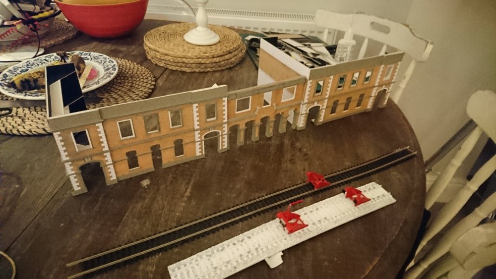

*Dusts off the cobwebs in here
Last Christmas Day 2018, I managed to make a hames of putting two ice cubes into a glass, which resulted in a severed artery and tendon in my left thumb, and any right handed modeller will know that it's the "clamp" hand. In the middle of it all, the London North Western Railway Group announced a competition on RMweb mid way during the year, and since one of the primary parts of the layout is the LNWR station (latter called the LMS Building), I thought it a fine excuse to jump in with the same gusto I had with the two ice cubes.
Once the hangover wore off, I realised that there was a minor issue of making loads of plastic things, and I'd have no time for it, but the odd half hour here and there in CAD saw things develop a bit, to the point that I think I might have designed the whole thing in N, rather than 00, as the buildings are substantially larger than my original sketch. Uncle Arthur gets the blame on that front, once more.

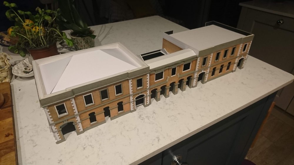

So the only true "downtime" for modelling arrived just after Christmas, there was nearly a week of quiet, and the physio said if I didn't start to use the thumb properly, I'd be stuck with a stuck hinge for good, so it made sense to make a start.

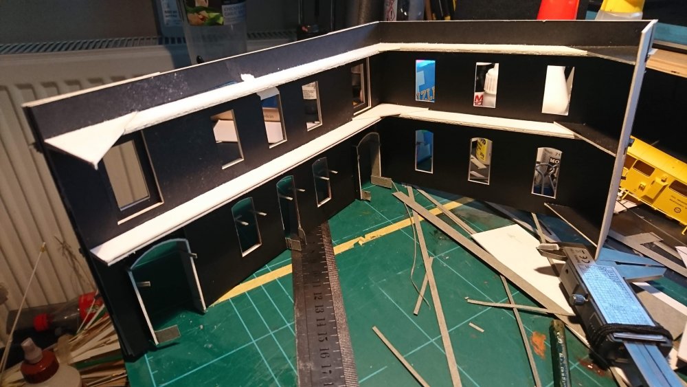

The central part is the lynchpin to the whole thing, with LNWR clock tower above, so I decided that would be the best start, and I chose to avoid that evil material Wills' Sheet as I like having working fingers. So it's all card, printed photos of the real brickwork, warts and all, along with grey mottled card for the stone..DSC_0213.thumb.jpg.2114ddd5452bf3496c1726f6495723ab.jpg

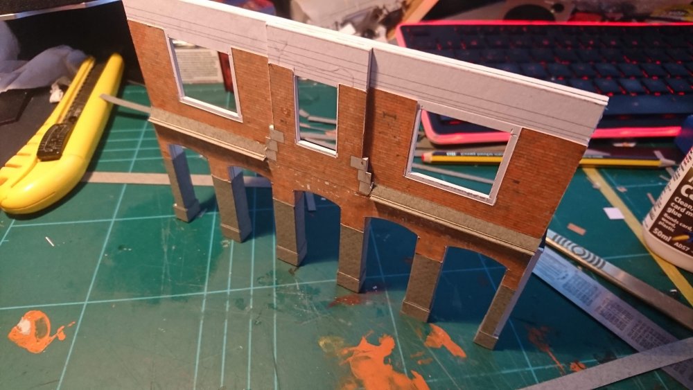

One of the things I should have done in some buildings before was properly spend time reinforcing it internally, so plenty off cuts were put to good use.

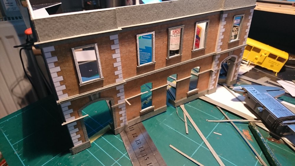

Apologies to anyone upset at the mangled plough, I did that in a professional capacity! There are multiple levels of card used to build up the various stone details at each level, particularly as they go around corners...

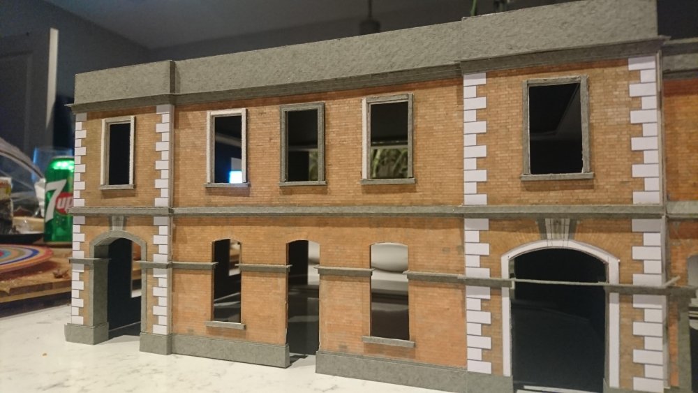

Excuse the fuzzy and the bits of buffers...banana for scale...
It's pretty tricky to see the various levels of stonework, but the joints need to be expressed and the front weathered with charcoal and chalk dust to make the detail pop...
This is where she is at the minute and she'll go into cold storage shortly until next year. I'm going to try to get the last of the stone detail on before then, and it's been a great bit of fun, even if aul thumby is sore as frig, but the Physio insists...
Richie.
(P.s big thanks to @warb for the inspiration to get started again, and I missed the deadline for the competition! )
