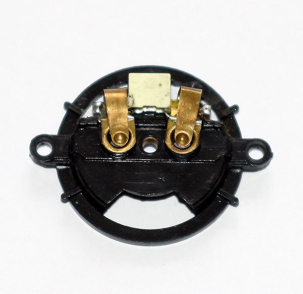

Hi guys,
I'm going to be starting the switch-over of my Lima 201 to digital running, using a Digitax DH126. I'm going to fitting leds to replace the existing bulbs and also fitting red leds for the reverse lights.
Any thing I need to watch for? Is the capacitor fitted to the engine requried?
Bill

If you're talking about the capacitor that is installed across the motor contacts (the white square in the photo below) then yes, it should be removed before fitting a decoder as it will cause running problems.
Also make sure the loco runs as well as possible on DC before installing the decoder. If it's runs poorly on DC it will ten times as bad on DCC!
Power pickup is a problem on Lima locos, there is only pickup form one side on the motor bogie and the opposite side on the rear bogie. It may be worthwhile installing extra pickups on the rear bogie.

Its converted now and running fair to OK, I checked on the cap and its recommended to remove it which I did. The pickups, yes definately need more.
The 201 running in DC was pretty good but DC seems to be more forgiving than DCC, I now see why people say the old Lima motors weren't the best. I'll fit the lights in a week or two as the wife wants her table back. I ended up stripping the engine down to it component parts and doing a rebuild...cleaning and adding a small drop of oil where necessary. That helped . Its very poor on slow speeds and only when the notch hits 1.5 to 2 on the controller does it move. But once going it tears along and runs extremely well.
I remember a thread on here where somebody had fitted a motor belonging to a CD-Rom unit to Lima BR HST and that made a massive difference to the Loco.
Compared to the other three engines I've converted so far its actually a pretty poor runner . At this point its either rebuild the motor, static display or ebay and I save up for a MM Class 201 , 141 or 081.
I also converted an Athearn F7A unit and that runs like a fecking sports car and to me it seems to run better than it did on DC. I even fitted the led as the MARS light, I bought that unit 14 years ago in Canada along with a B unit , an SD40 and some freight cars. Far different motor though.
Worse comes to worse I'll jsut convert it back to DC running and sell it. I'll fit the chip to another loco.
Been fun though.
Bill
