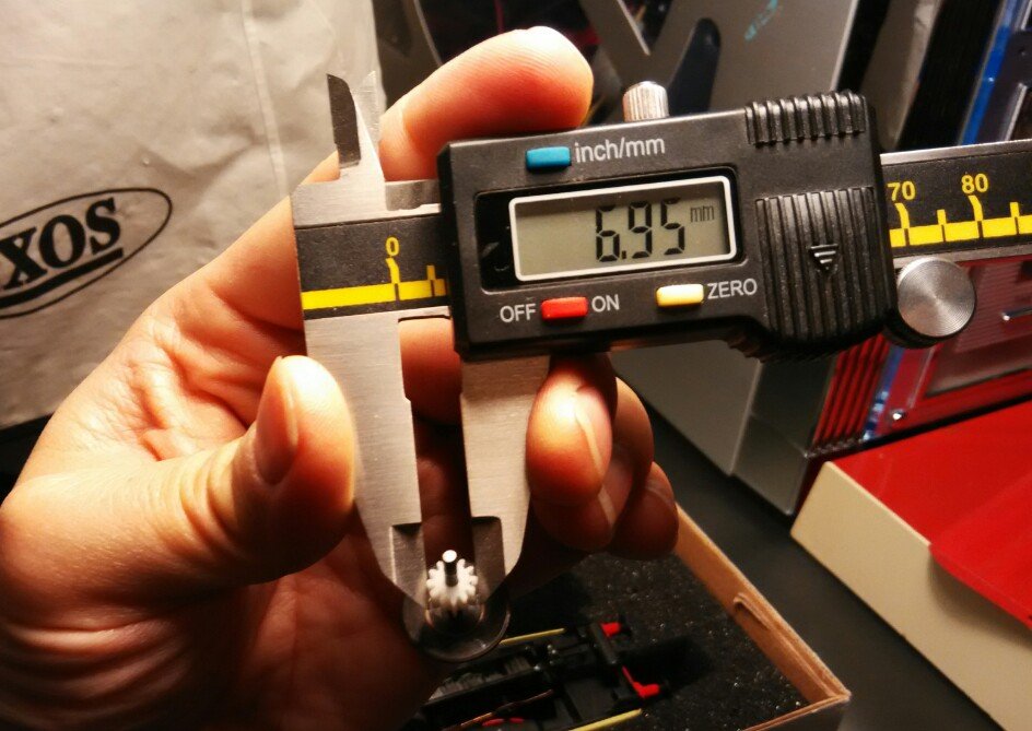

The Heljan cog has 12 teeth, and has an overall diameter of about 6.95mm. Not sure what DP or MOD type it is, though.....
Edited by Horsetan
more detail

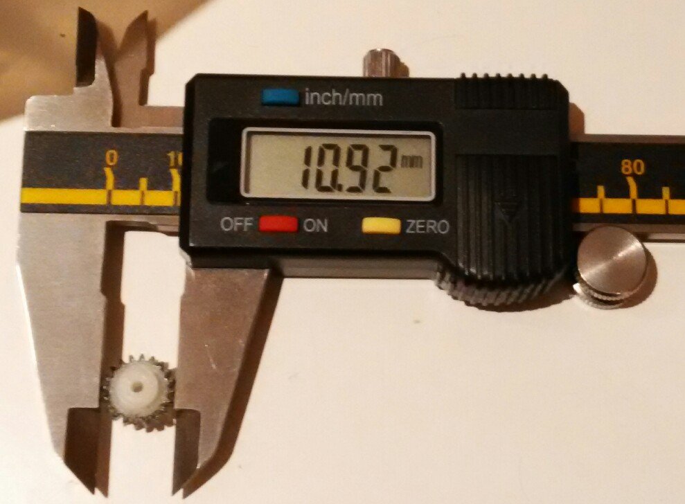

The large Heljan cog (the initial stage driven by the worm) is 10.92mm overall diameter, and has 20 teeth.
Bill Bedford reckons all Heljan gears are 0.5MOD.

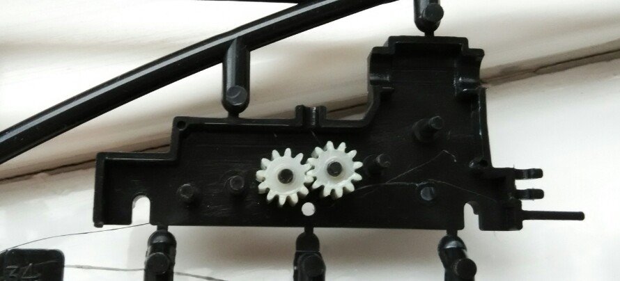

(Ten hours later)
Think I've found a couple of other sources of the 12T and 20T spur gears; not too expensive.

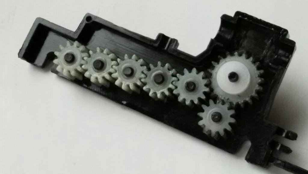

Original Heljan Hymek geartrain looks like this:
....whereas the room left for a centre axle on the Sulzer bogie looks like this:
A bit close to the idlers.

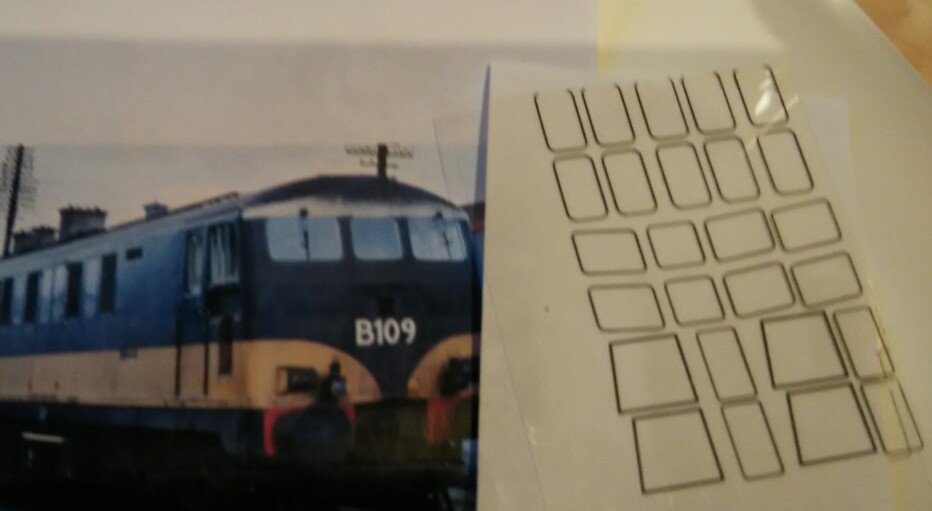

Sorry Horse, I got the gist of your question wrong. Yes, they are rectangular windows with curved corners, rather than rhomboid.
In the first few kits I built I used CD covers to make the glazing panels by cutting strips, then small rectangles, then filing the edges, and push fitted them into the cabs so they'd finish flush with the opes. Any gaps around the edges were easily filled in with a bit of filler.

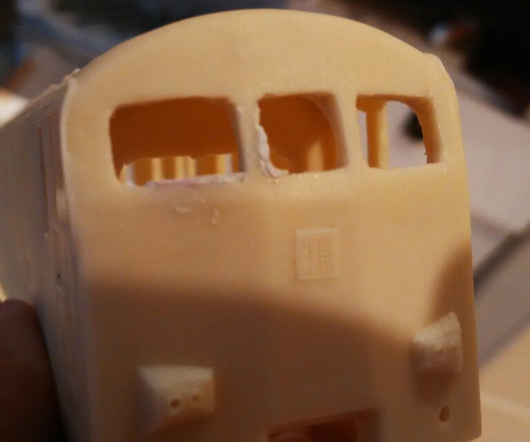

Started on the body, with a bit of filling and filing of windows and frames:
The thing I'm confused by are the cab front windscreens: the SSM cutting guides suggest the outer pair are slanted, but all the photos I'm seeing suggest that they are perfectly straight:
What are people's opinion on the two vertical creases beneath the centre windscreen? I think they need to be sanded down. From what I can see, the Sulzers had a gentle curve on the front panel..
Link to comment
Right so, a rhomboid shape and not a regular rectangle?
The central window would be RECTANGULAR but instead of being vertically orientated would be in a plane that tilts toward the locomotive (from bottom to top) as the 'flat' lower front of the locomotive angles backwards at about waist height in the cab (kinda like any car windscreen, (if it were flat))
However, it looks like the lower centre of the cab of the only part that is vertical and perpendicular (vertically and transversely) to the long axis of the locomotive. It looks like each side, right and left of the center front panel also angles towards the locomotive (from centrally to the side). The distance between the central and side window frames appears to remain constant between (say,) the top and bottom.
Hence, (while remaining parallel to the centre window edges, from the front and angling away from the central window on each side) the non-central windows are not parallelograms but QUADRANGULAR in shape. The tops and bottoms of these windows are parallel to each other and only the central side of them is parallel to the central window vertical edges.
Now, if theres a curve on these panels, everything I just said is wrong for the non-central windows. So hopefully whoever designed the kit also came to the same conclusions.
And since the corners are rounded all these shapes are approximate
While all of this might be evident on the prototype, I doubt you would appreciate it scaled down 76 times, so it's likely the window will appear as a rhomboidal parallelogram with rounded corners (side are unequal length), not a rhombus (equal)
Sorry, I may have driven you completely mad now
Edited by DiveController
Link to comment
Horse, you'll have to strike a line across the front using something curved and file the window openings.
It's on my workbench somewhere but I haven't a clue off hand. But trust me - each window in their local axis is a curved rectangular shape. On a world axis they'd be "odd".
Engineers would not have gone to the trouble of designing complex multiangled shapes without 3D software in the 60's.
Did BR do it with the windows on their sulzers?
Rounded rectangles...
Link to comment
Just to add my tuppence, those windows were the devil themselves to model. Definitely an offset rhomboid of types.
Not helped by the fact that the lower face of the loco is faceted but above the windows is compound curved. You are only now noting the fun and games I had back in 2012!
Link to comment
