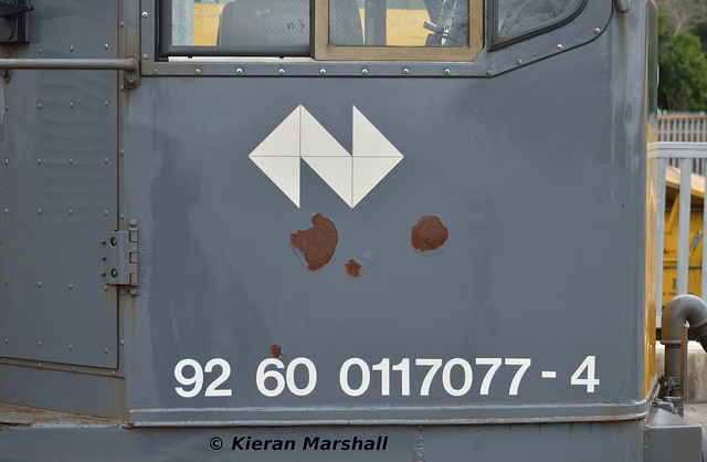

Yep, great refurb. This is what 077 was like after two years
And note that both 077 and 071 went back into the works before other members (such as off the top of my head 075 in the silver/black livery).
I'm not saying the end of 071's is immediate, but they won't do trains to this weight (as has already been stated they struggle with the 942 tonne Taras)
