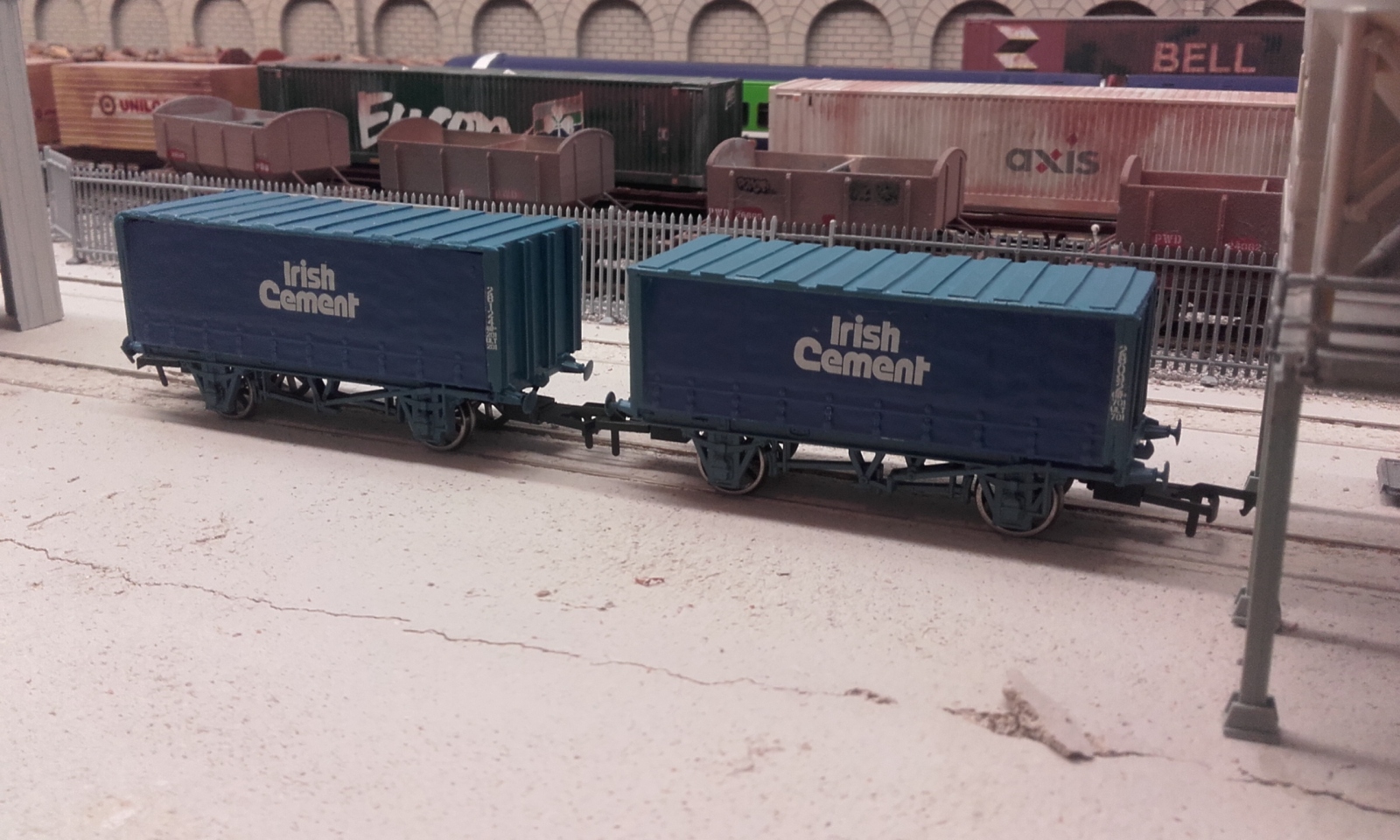

MikeO & Mogul
Hope this helps

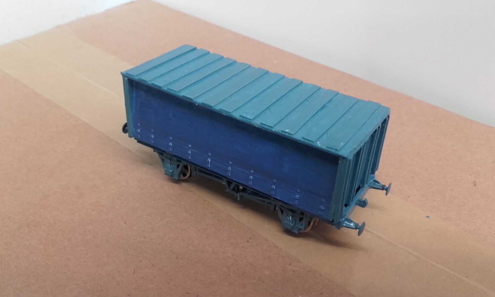

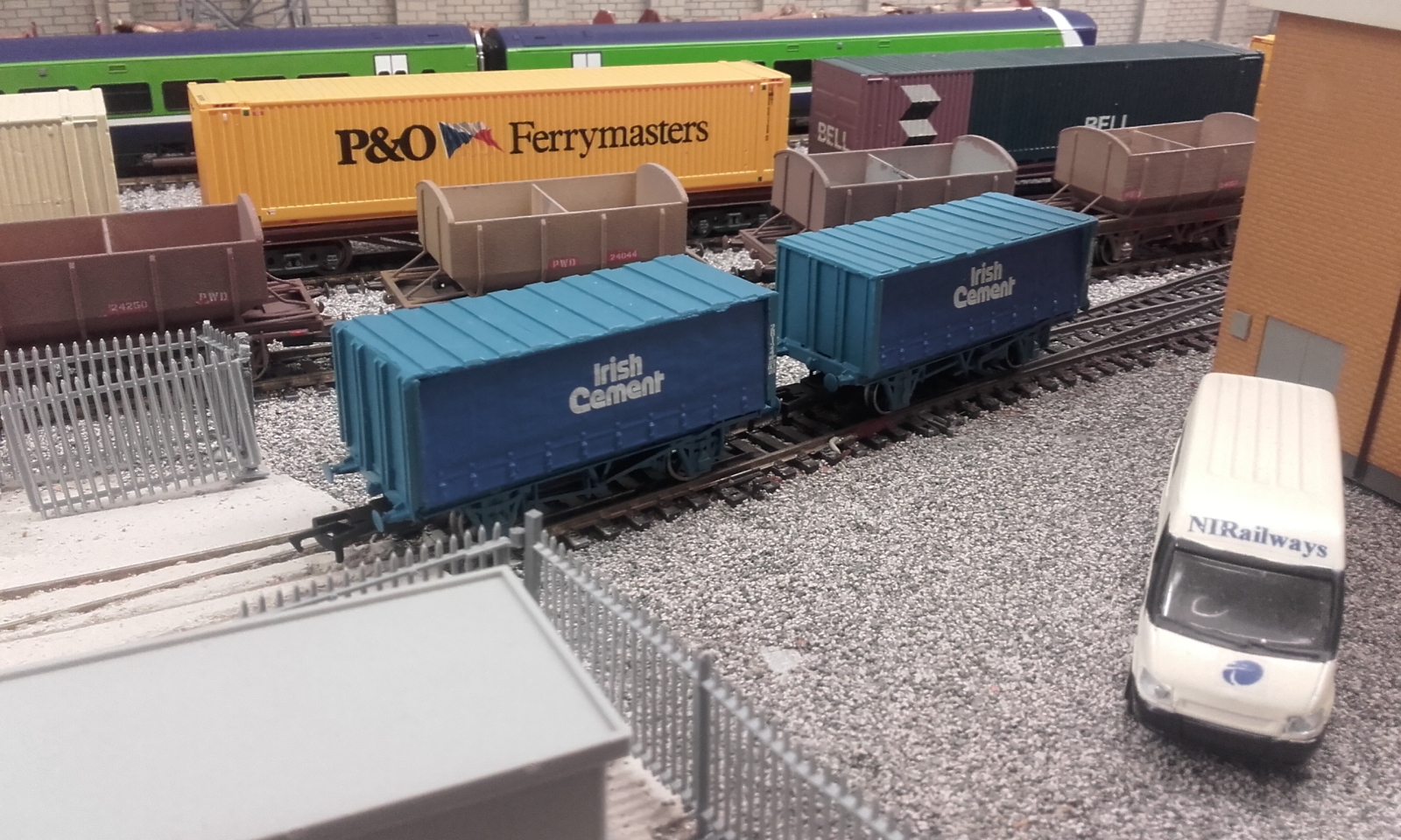

Chassis is a Dapol 21ton hopper type.
Both buffer beams cut off, a further 2.5mm was removed from each end of the chassis and the original buffer beams refitted, giving an overall length of 80mm (excluding buffers)
Body is 40 thou plasticard cut as follows
Roof 80 x 32.5mm
Ends 20.5 x 32.5mm
Floor 80 x30 mm
Roof ribs are cut from 20 thou plasticard 4mm wide
Curtain sides are cut from a Hornby R234 curtain sided van body you will need a piece cut containing 10-12 buckles on. £1.99 buys two bodies
These are available from
Des Ellison
110 Rosehill Road
Burnley
Lancs
BB11 2QX
Transfers are from Railtec
Paint's are Humbol French Blue no14 and WW1 blue no 109
Phone:01282 |832 754
Email:desmond975@btinternet.com
Edited by The Derry Road

TDR
Thanks very useful information. This will in due course allow me to build one or two. the information about the use of a Dapol 21 ton hopper chassis may also allow me to build a proper sized Lyons Tea wagon. The one I have made is a little too long as i used a 15ft wheel base chassis.
MikeO

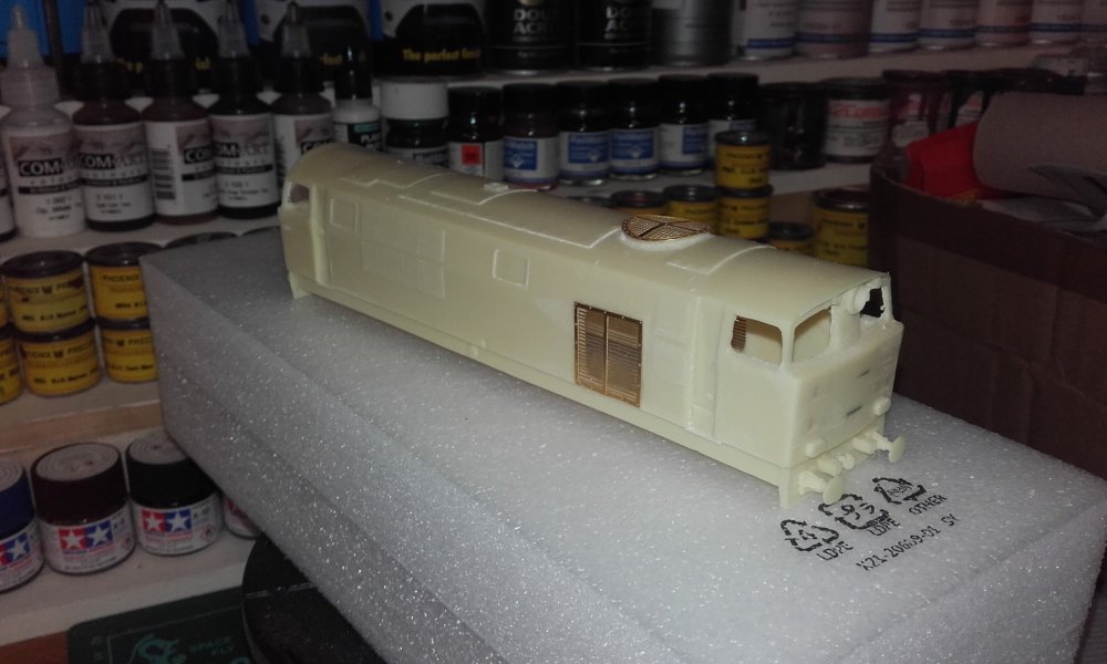

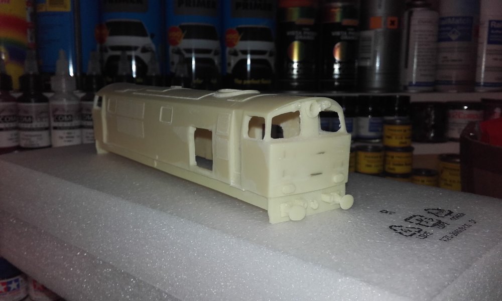

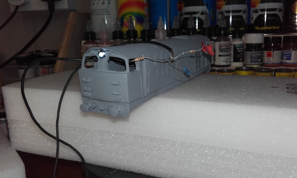

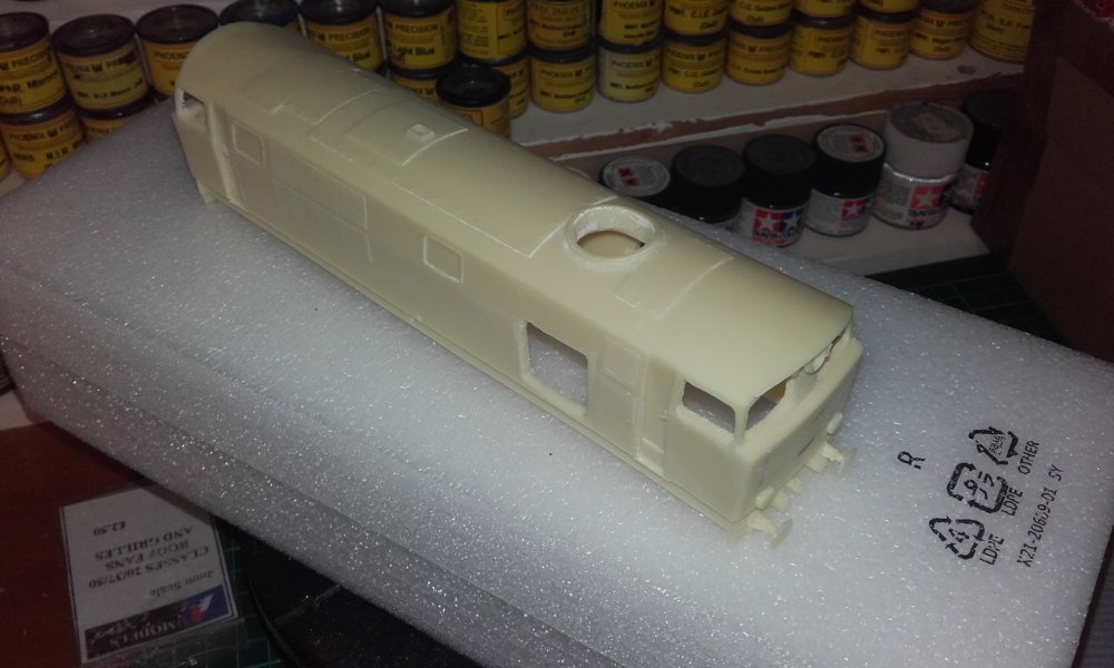

Just started this morning the second NIR Hunslet (DL) number 102 FALCON, to be in NIR light blue with Bachmann class 20 DCC sound chassis (same as maroon version posted two weeks ago). The main difference is this body will have, molded hand rails removed along with roof and side grills, and replaced with brass ones. also considering head and marker lights TDR

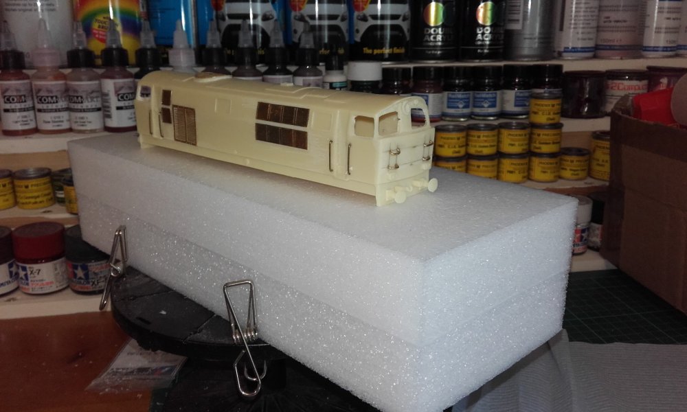

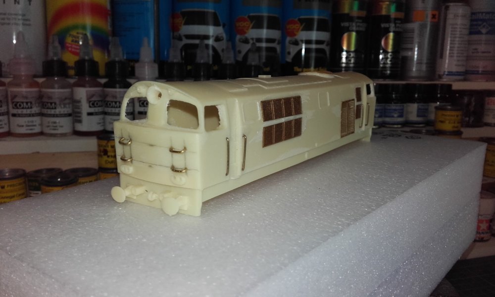

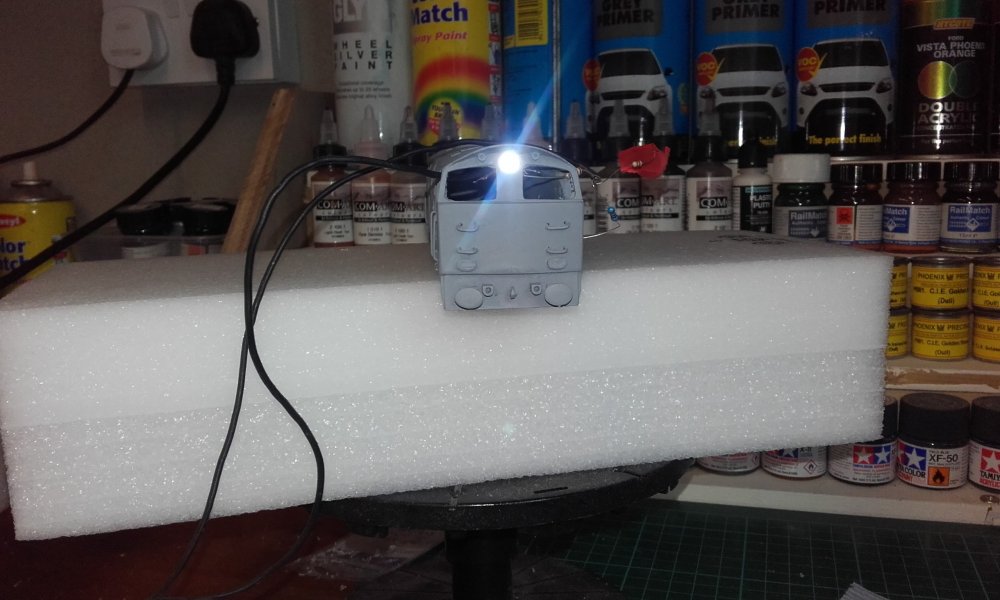

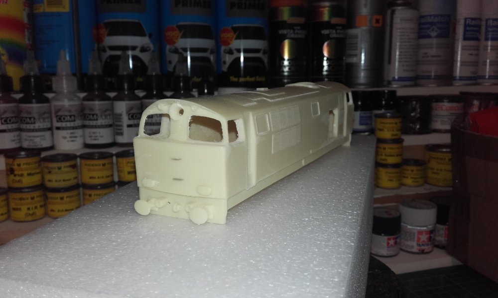

A few pictures showing the progress thus far on the hunslet, moulded side and roof grills bored out, removed and new brass one in their place. I have also removed the hand rails hopefully fitting replacement brass ones tomorrow, on both cab fronts and doors. Head lights have been bored out and tapered from inside to outside to accept LED lights. I’m still wondering about fitting marker lights, I’ll sleep on it tonight. TDR

Any plans to open up the blank side windows? I'm in two minds about that with my 104 Class, the moulding is fairly thick there, maybe just darken the blank and float some varnish or something into it as 'glazing'
