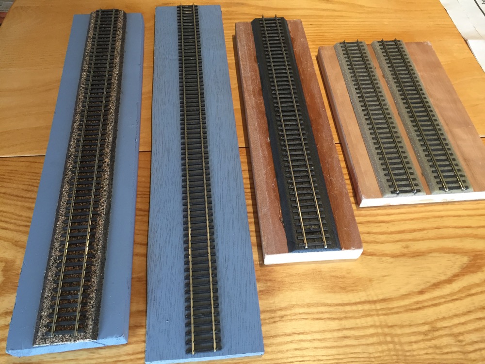

First up I cut four wooden display boards which after the experiments are finished I will convert to display cases for stock. Then laid and glued various track bed materials, and pinned track to the boards through the track bed ready for ballasting. Then ballasted using the usual 50/50% water/PVA mix with a few drops of fairy liquid.

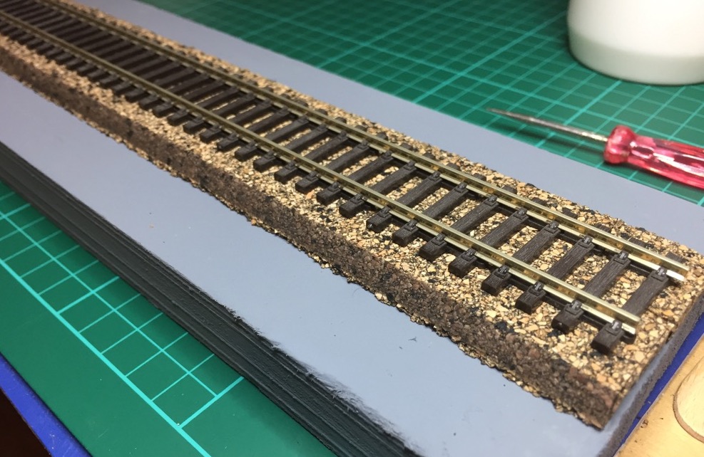

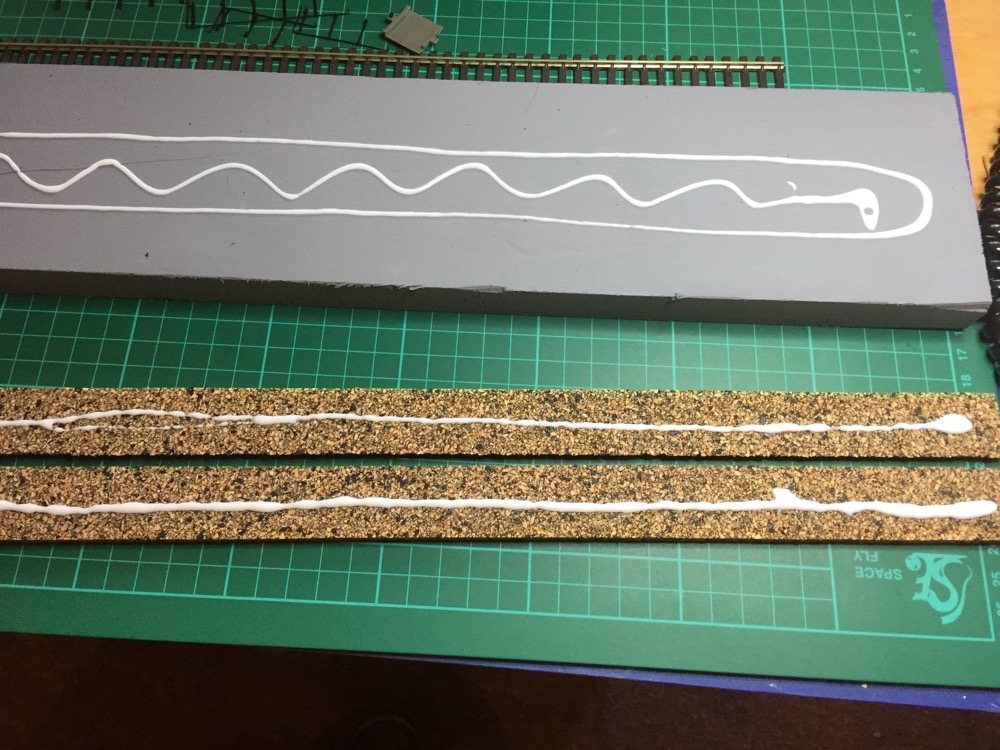

Javis 5mm cork trackbed is pre-cut down the middle with sloped shelf. Also makes it easy to bend trackbed around bends. Glued with PVA to baseboard.
The colour of the cork is an advantage because any thin area of ballasting is less obvious afterwards

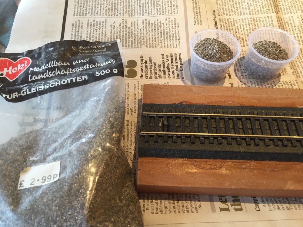

Woodland scenics dense black foam 5mm track bed. Also pre-perforated down the middle for ease of bending on curves. Glued to baseboard with PVA

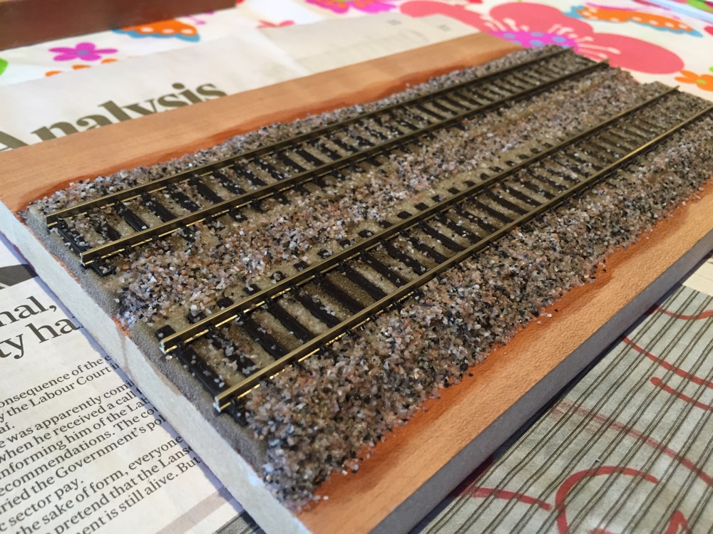

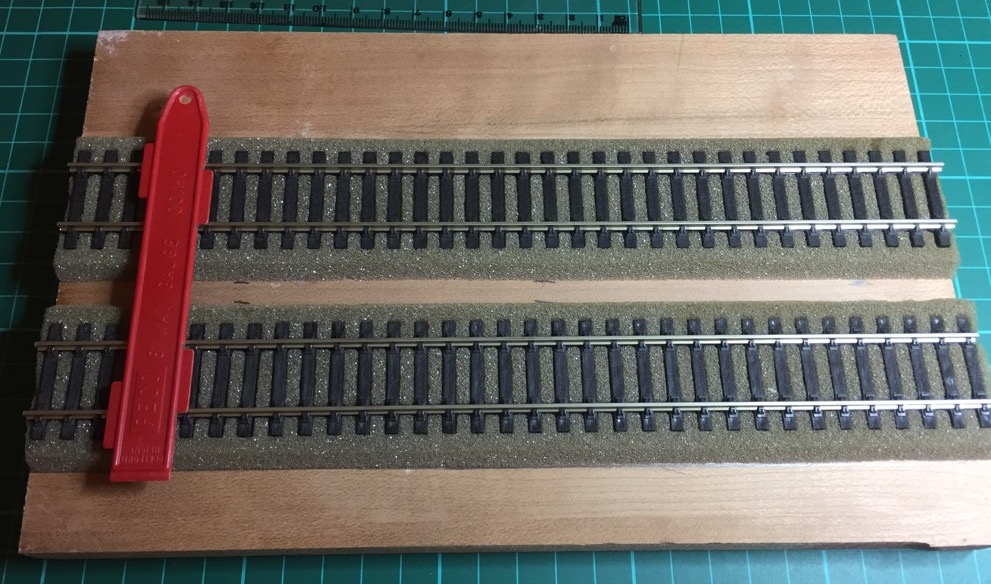

Finally twin track on Peco foam underlay which will be augmented with supplementary ballast. I have a lot of this already laid on the layout for past 20 years and it has not perished, so I want to see if it is possible to augment with some ballast material. The underlay was lightly glued with PVA to base board.
Four samples on respective track beds BEFORE ballasting

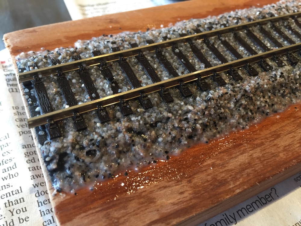

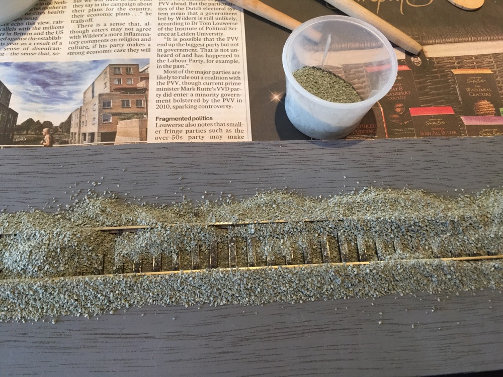

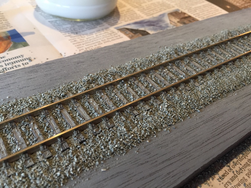

No 1 - First up Javis extra fine granite direct to baseboard, spread dry by hand and gentle paint brush. Then spray with water so the PVA will absorb and penetrate the ballast all the way to the base board.

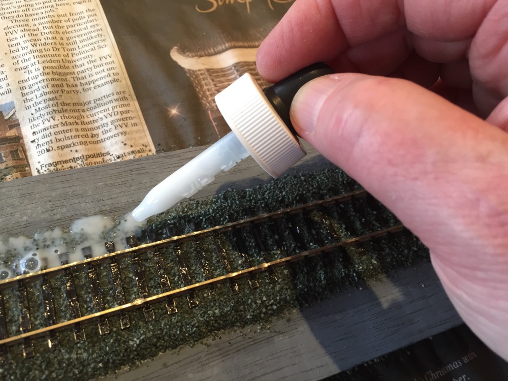

Medical dropper lid was great for putting 50/50% PVA mix on the ballast
PVA applied and waiting to dry, rails wiped clean with fingers and kitchen paper.

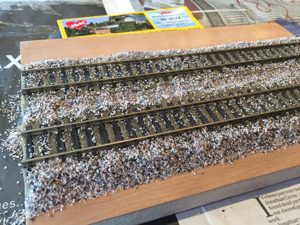

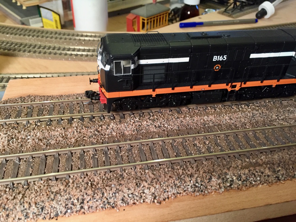

No 2 - Next was augmenting existing Peco foam underlay track bed with medium Heki ballast in a colour that would be compatible with the Peco foam. First I spread the ballast material filling the gaps between the twin tracks and the outside shoulders of the foam underlay and sprayed with water (using fine spray bottle so not to disturb the ballast)
Then use the eye dropper bottle to deploy the 50/50% PVA mix. As I worked on this I realised that fine grade of ballast would have been better.
No 3 - Next was woodland scenics 5mm preformed track bed strips with Heki 3072 medium sandstone/beige ballast
The steepness of the 5mm woodland scenics track bed meant that a lot of ballast was needed to cover the shoulders, or alternatively paint 100% PVA to the shoulders before dropping ballast onto it. I felt the medium was a little coarse and fine grain would have been better. Also I didn’t like the three colours in the mix (i.e. with some white and black mixed in).

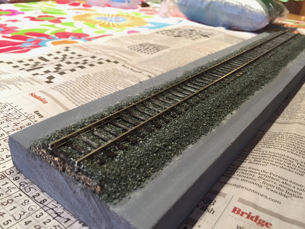

No 4 - Finally Javis 5mm preformed cork track bed strips ballasted with Javis extra fine granite chipping. Apply the granite dry, shape and spread with fingers and brush, removing surplus, then spray water in prep for PVA absorption, then apply PVA using eye dropper on all of the ballast.
PVA applied waiting for it to dry for 24hrs. As this piece was done a few hours after the rest I think the PVA/water mix had started to dry and separate so the PVA did not dry 100% transparent like the other samples. I should have stirred the mix between coats.

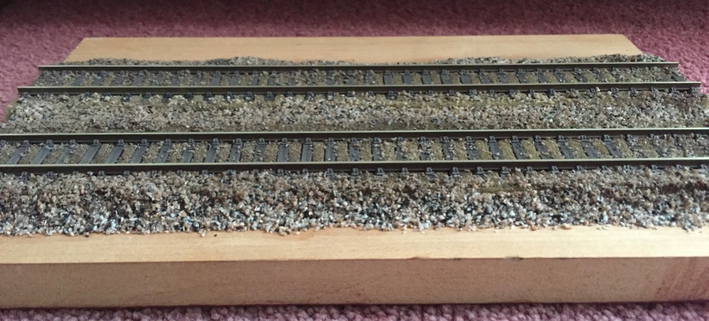

The results almost dry before weathering with spray paint. I will also put some static grass on the edges for the display cases later.

  • Like fine granite ballast and its dust covers sleepers nicely for weathered look

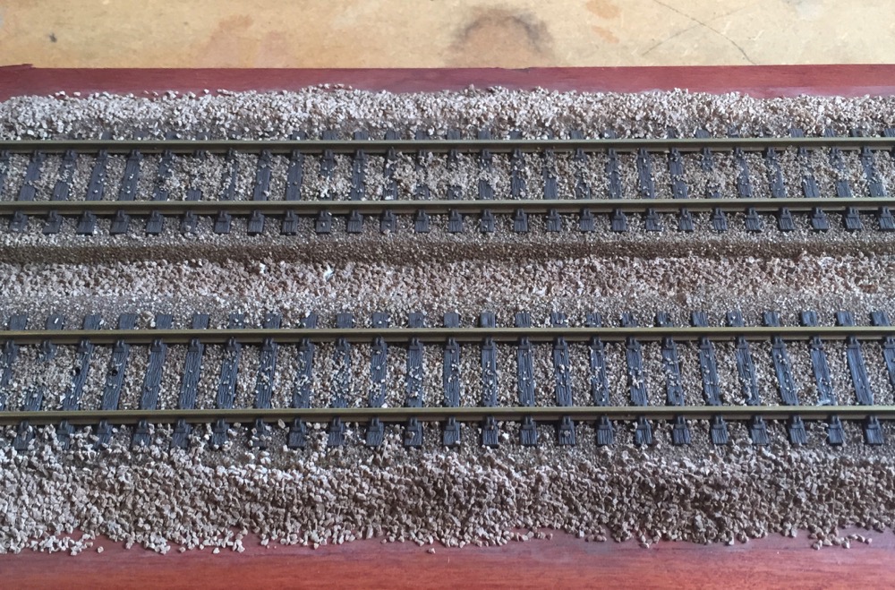

Experiment no 2 finished by weathering track with a light spray of RailMatch sleeper grime on rail sides and track. The Peco foam underlay has blending in better than I had expected and the spray made all the difference. Also after the spray the medium grade ballast doesn't look as bad as before.
Both of these are virtually silent btw.
Next up will be woodland scenics fine buff ballast with the Peco underlay and another with medium for comparison.

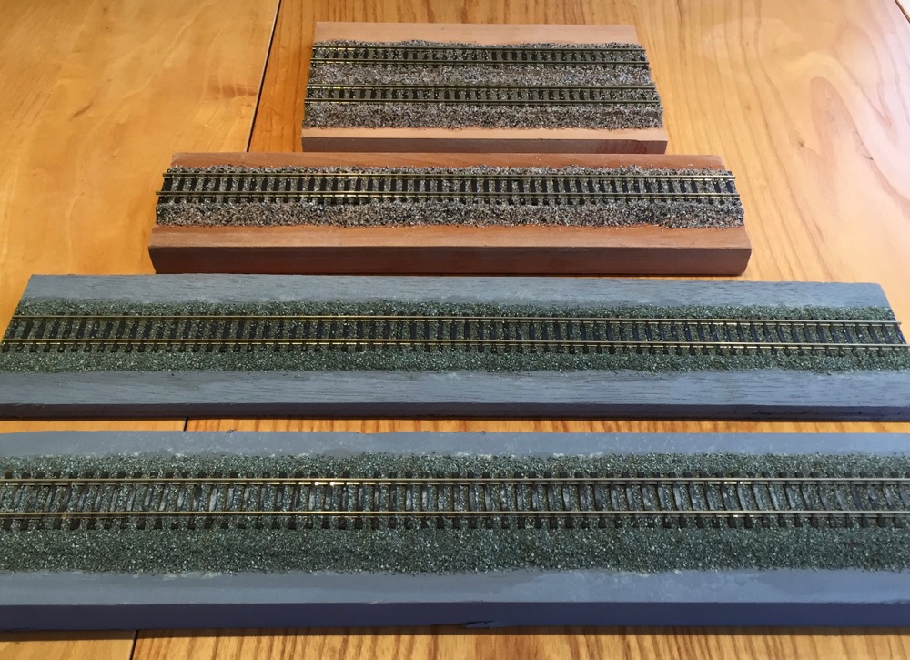

Some pics of samples with better light
A busy weekend ahead . . .

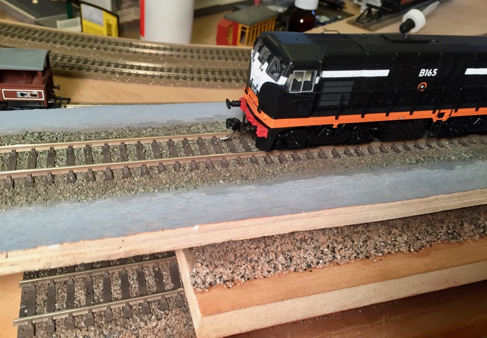

Some ballast experiment samples weathered a little and with static grass
Javis fine granite chipping direct to baseboard
Foam underlay augmented with heki ballast
The static grass applicator cost only €15 on eBay back in 2015 and seems to be a Chinese copy of brand name products that retail in excess of €130.

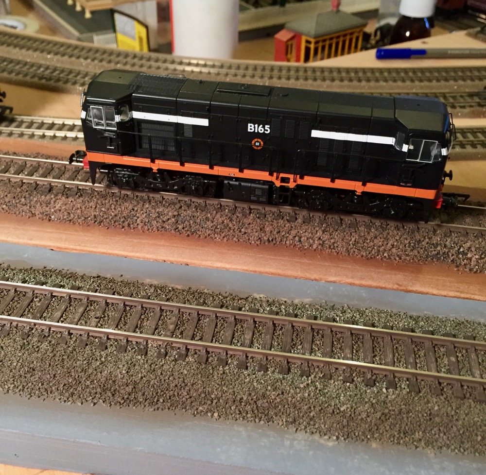

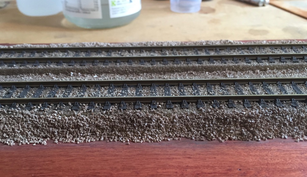

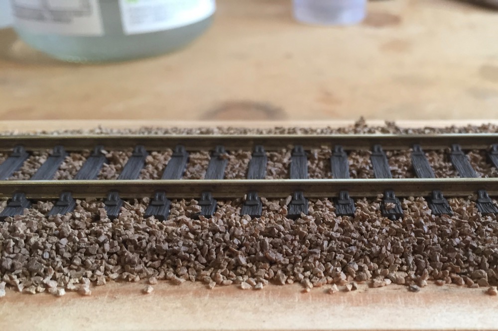

Next two experiments.
No 6 - 3mm closed cell foam track bed, woodland scenics medium buff ballast, gently weathered and rail sides sprayed with RailMatch sleeper grime.
No 7 - Not happy with this (next two pics) - existing Peco form underlay augmented with Woodland scenics fine+medium buff ballast slightly weathered with railmatch sleeper grime. A bit of a mess and was difficult to keep ballast off the sleepers.
I was leaning towards augmenting the existing Peco foam underlay as a compromise because of its incredible sound proofing, but have decided it has to go.
A few more trials to do, but right now I am favouring the 3mm closed cell foam track bed as a replacement with woodland scenics medium buff ballast (which initially is too bright, but fine when weathered with sleeper grime). 3mm cork is still an option, but I have decided against both the 5mm track bed options (woodland scenics and javis cork) as they are just too high. Tried woodland scenics N-guage foam, but the closed cell foam Junctionmad has sourced (thanks btw) seems to have better sound proofing and is easier to cut with a knife, also seems to return to shape better when squashed.
Other decision is that I'd prefer a warm brownish colour tint for the ballast rather than modern grey, which while more authentic seems a little less attractive visually in indoor lighting.
