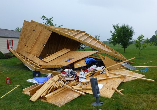

I'm looking out the back window here one last time to make sure everything is tied down before this hurricane thing hits, and what pops into my mind? Tonys new shed!!! After all your hard work I hope you thought to put a few bolts in the ground! Stay safe out there lads and Tony, I'll say a prayer to St. Theresa (Mannion) for the safe passage of your shed through Monday!
Link to comment
:bishopbrennan:
