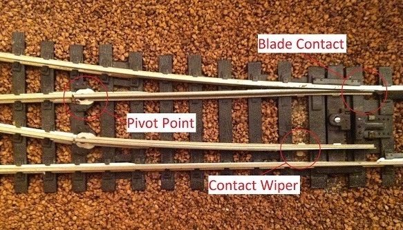

If you're relying the 'contact wiper' to make/break the electrical connection, then you can find that they aren't 100% reliable, but they can be made to work better by a little judicious bending with a small screwdriver, so that they make better contact with the fixed rails as the position changes.

I had this recently on my test track, and it was back at the frog (?) where the two rails meet with a insulator supposedly keeping electrical connection separate. If I threw the points one way, all was fine, the other way, the 141 would stall, as it shorted. I'd check to ensure there's no oil or electrical connectivity at the frog itself. I had to slip in the tiniest shim of acetate/clear plastic to ensure proper electrical order and keep some distance between the two polarities.
