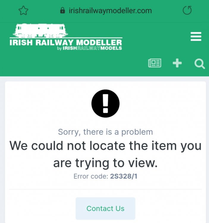

I can't view the 'man cave' clip-  must be some issue on my end-  just keep getting an error-  l will have to just imagine 😀😀

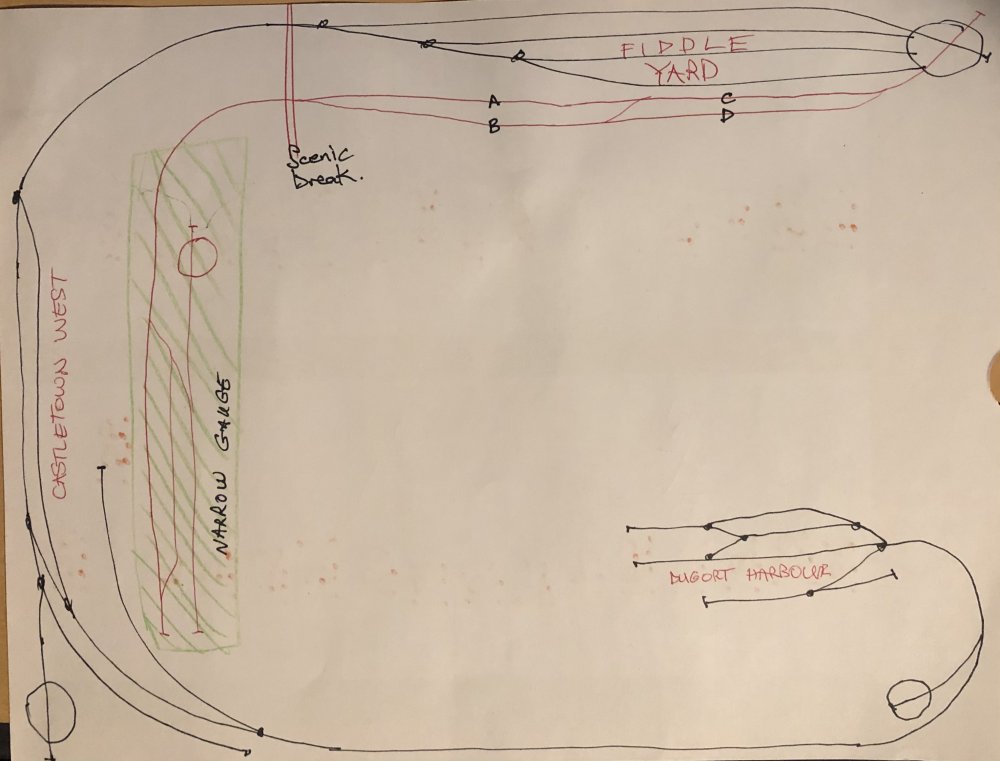

So, an update, with background.
I moved house last autumn. Lurking in a well-known premises in Edenderry was "Dugort Harbour", a small terminus in a setting of both scenic and operational similarity to the likes of Baltimore, Valentia Harbour or Westport Quay. Space was limited to about 11ft x 3ft max, at the end of a room. The train would leave, vanish into a tunnel and appear in a small fiddle yard. Trains would be short one or two coach things, or a short Loughrea or Foynes type mixed.
So, delivery from Edenderry was paused, pending the new house, with the probability that once in, it would be installed in one of the bedrooms.
Enter, stage left, PJ the loft conversion man. Long story short, there's now an attic room which I posted a vidjo of the other day. This is a much bigger room, with planning permission from the Domestic Authority for a full possession of it. I attach below a very rough sketch; the longest wall is 19ft, and the other two 14ft each. I know, I know, metrication.... bear in mind, O Younger Folk, that I went to school in the north, where distances are still measured in quarts, and time is measured in perches and roods; AND it was almost sixty years ago, when blue steam engines..... enough!
I've heard comments before about how house moves interfere with layouts to the extent that a perfect one for one house simply will not satisfactorily fit into a new one; now I have that issue. Had Dugort Harbour not been started, I would now have it an entirely different shape, but it is what it is, so I have had to arrange the way the attic room will be with its current state in mind. Luckily that's do-able, so once it is delivered I'll show pics to illustrate what I mean.
So, the plan now is to extend it. Due to initial space constraints it was designed with a run-round loop which could barely hold four bogie coaches and a van, although a local train rarely reached that length anyway, so all good there. Thus, in extending it, there's no point in any other station being much longer, as a train despatched from there to Dugort would not not fit in the platform.
I wanted to apply a broad principle that "less is more". Artistically, we've seen the superb results achieved by some of the layouts that feature here regularly which are set in rural locations. What makes these look so realistic is as much - if not more - the wide embankments, hedgerows and sparse "clutter" (as opposed to the necessity of this in an urban setting) - as the accuracy of locos and appropriate rolling stock.
I want to show a rural setting of the mid-50s to late 60s period, with enough steam engines to operate the entire thing with steam only, and realistically. Thus, I do have enough steam engines to operate the whole thing, but also for a later period, A & C class diesels, finally 121 and 141 types. Anything later I'm not interested in personally.
Carriages similarly; from a few old wooden bogies (and six wheelers eventually), and some laminates and Park Royals and appropriate vans - the point being that the whole layout can be operated as if it's 1956, 1963, 1966, whatever.
Such a terminus will have looked very shabby indeed, the sort of place where  if you turned up there you'd be compelled to wonder how long more before CIE would close it. This, of course, makes one scenic item simpler; it's easier to put weeds on a platform than convincing-looking people!
Looking at the plan below, you can see that the train will leave Dugort and head round a sharp curve - this is necessary due to the shape of the room and is just over 2'6" radius - sharper than I'd like, but it'll have to do. Childhood layouts were 6' x 4', thus a curve of under 24" radius. It then travels along a nine-inch-wide "shelf" along the wall, which will be in open countryside, before rounding a curve at the left-hand bottom corner of the drawing, into a somewhat busier "Castletown West".
This is suppose to be a bit like Skibbereen or Cahirciveen. It's a terminus in a way, but the Dugort bit was a Balfour extension in the 1890s, aimed at traffic which never materialised. Now it's a bit of a backwater.
The purpose of this is for variety in operation. Moving on to the fiddle yard at the top right, which is meant to represent the "Big Shmoke" (Cork or Dublin), a main line train leaves there, heads to Castletown, which is somewhat inspired by Westport, or Newcastle West, or the two south-west destinations above. When it arrives, a branch train takes over and toddles off down somewhat indifferent track to Dugort, which might have been about four miles away.
This will allow a Woolwich to arrive at Castletown in the steam era, and a dirty J15 takes over for the branch train. However the goods will work straight through - two more dirty J15s (I've three). In diesel days, a similar working pattern with an A on the main line passenger, a C on the branch, and 121 / 141 types gradually taking the passenger over and displacing the A to the goods.
So we have operational variation, but not too much clutter; the whole thing will look rural.
I will keep posts updated as it develops, if anyone's interested. It's going to be a challenge, as it's years since I've done anything this big. Some I'm doping myself, but I've had to "sub-contract" other stuff.
I haven't mentioned the red lines on the diagram, nor the green rectangle yet.
The fiddle yard has these red tracks too. They are 12mm gauge, of H0 scale 3'6". This will enable me to develop a small adjacent layout to indulge my interest in South African and Indonesian steam. Not a diesel will sully these tracks.
When Dugort Harbour was ORIGINALLY planned, the intention was that it would be portable. Long story, but as you can see this isn't happening.
A chance conversation with a fellow enthusiast of Cape gauge stuff recently got me thinking, so this green rectangle is a portable board of 15" x 7'6" (in quarts) which rests on supports but may be lifted out when I'm operating the Irish layout. It shares the (fixed) fiddle yard, and I am talking to "those who know" about a dual gauge turntable in the fiddle yard. This will represent a Western Cape branchline somewhere on the edge of the Karoo, in the 1960s - 70s period.
The beauty of South African lines is that many branchlines, even those which saw but one mixed train a day, lasted right until closure as late as the mid 1990s without ever having seen a diesel; so, perfect for steam fans even into the modern era with 2.8.4s hauling goods trains with modern bogie container wagons - same stuff you'd have seen at North Wall in 1995. This one WILL just be a terminus-and-fiddle-yard thing.
What's with all those turntables?
Steam engines and 121s, that's what. In the era I'm dealing with, 121s rarely if ever ran in pairs, and on most branches, CIE turned steam engines. On the South African Railways, while it did happen the odd time, tender-first working on lines like the one shown were almost unknown.
The narrow gauge thing will be limited to maybe 15 items of rolling stock - a typical train of the appropriate type might have had two four wheel wagons, two bogies and one coach. Locos will be two 6J class 4.6.0s, and IF the IRM "A" class budget doesn't have the damn house back on the market, maybe a 19D. Lottery win needed, maybe another 6th class derivitave of the 6J kit. If anyone has any idea where I could get a 24 class....do ping me.
