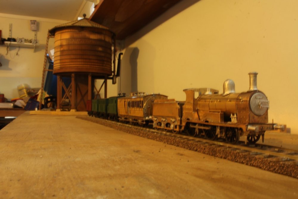

Finding space to do anything in our garage has been like a 3 dimensional chess game, no sooner than I completed the baseboard framing for the Irish broad gauge layout than it became covered by other unfinished products and models.. Thankful these days there has been some progress. Progress with other projects finally freed up space to clear the traverser and about 12' of baseboard, while the N gauge will probably be returning to the house by Christmas.
Anytime between 1890 & 1963? 650 Class and perishable (6w bk3rd, horsebox and string of meat vans. I will have to find a permanent home for the watertower😁.
1960s Night Mail, heating van TPO 3 fitted H Vans, to connect into the Galway-Dublin Night Mail at Athlone or Mullingar

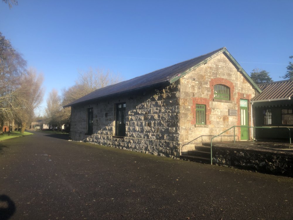

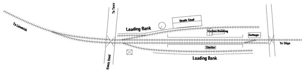

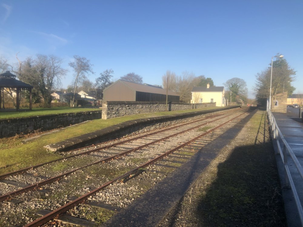

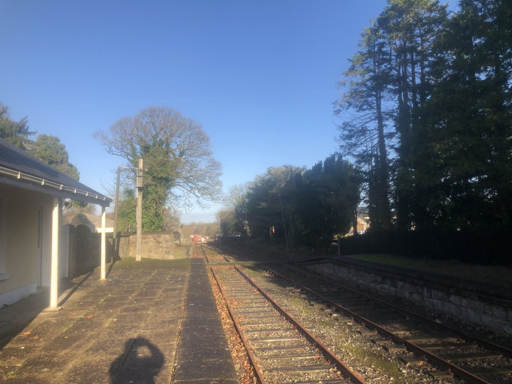

Although my main interest is the Midland I settled on Kiltimagh on the Burma Road mainly because of family connections, the compact and attractive nature of the station. My father was born in Ballinamore (nr Kiltimagh) and spent most of his childhood there before moving to Galway in the 1920s.

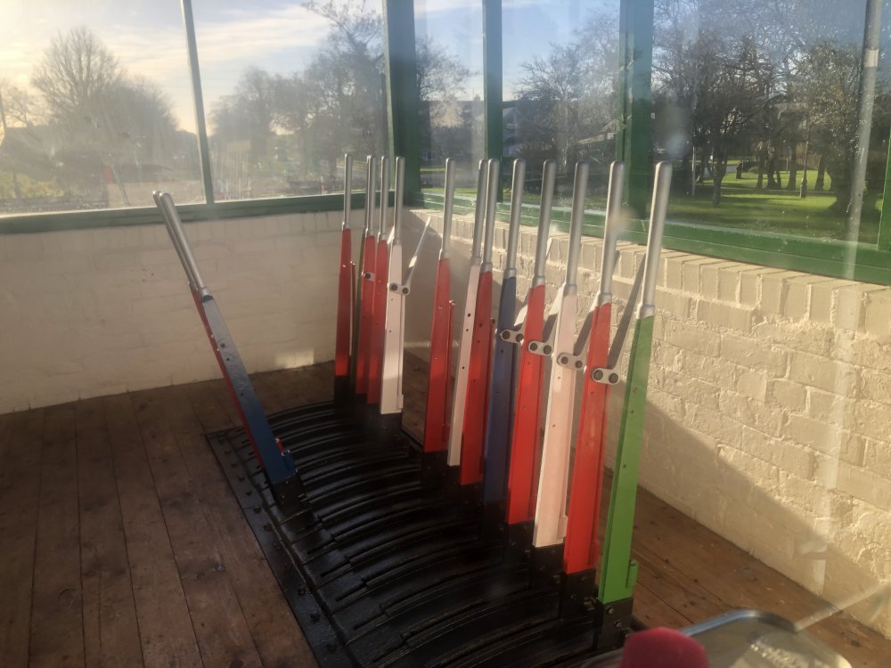

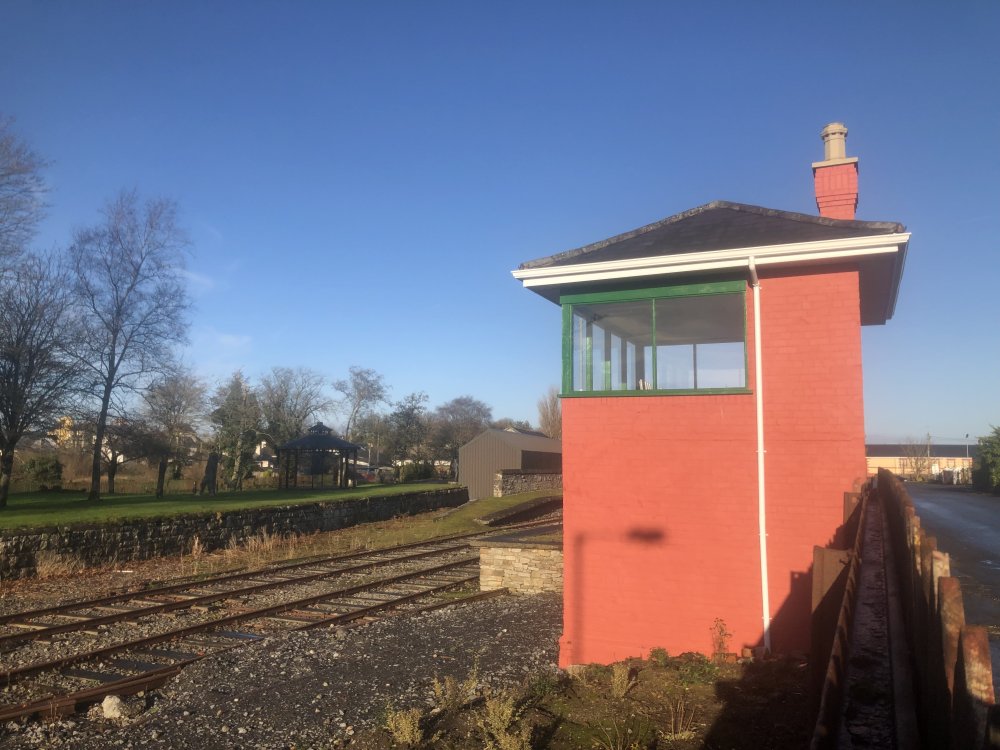

I was struck by the sight of the signal box guarding the level crossing at the south end of the station as we drove over the crossing on our first family holiday in the West when I was about 10 or 12.
I had my first decent Grice around the station during my summer holidays in 1982. Gradually surveyed the station on three visits between 1996 and 2018 and have been working on drawings of the buildings and structures since around 2004, I am not exactly a fast worker!
I had the signal cabin laser etched by York Model Making, but decided to "scratchbuild" the remaining buildings in ply or mounting board with Wills Scenic Sheet walls and etched window frames and architectural details to my own design, I will probably follow Andy Cundick's or Simon deSouza's example and slate the roofs in paper rather than the Wills Scenic sheets.
Although the 'facilities" passing loop and two siding loading banks and good shed are similar to other 'large" Burma Road stations the tracklayout is unusual with the station hemmed in to the space between the two level crossings with both siding running behind the platforms as opposed to the more elongated layouts at Swinford, Tubbercurry and Collooney South with the goods facilities largely separate from the passenger station.
The line through the station is on a down grade in the Sligo direction, a fatal accident occurred during WW1 when a North bound ballast train ran through the station and collided with a Southbound goods or Cattle train, the short stub siding at the Sligo end of the loop was probably provided to prevent loose coupled goods trains running away during shunting, gravity shunting is featured in a Video of the line in its final years. A 001 Class and a couple of vans arrive at the platform from the Limerick direction, followed shortly afterwards by some vans for the yard arriving by gravity, followed by the rest of the train when the signal man re-makes the road for the main. I hope to model the down grade but would be challenging to re-create the gravity shunting.

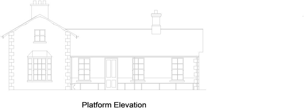

The station building appears to be a standard WLWR design used at several of the smaller stations between Ennis and Collooney Junction and on the Clonmel-Thurles line.
I forgot to measure the width of the gable end during the 2003 survey and had to make some adjustments to the drawing following the 2018 visit.

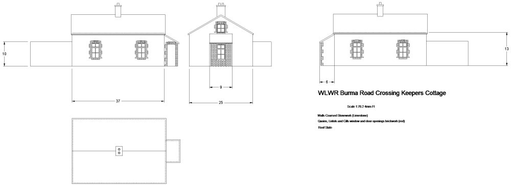

The buildings featured a nap rendered finish with stone quoins, I prepared a set of etched window frames one-two years ago and recently prepared a set of decorative bargeboards and quoins.
I measured up most of the buildings in 2003 before moving to New Zealand  and re-checked some of the dimensions during an Irish holiday in 2018 but forgot to measure up the crossing keepers cottage.
This lead to some skulldugery to produce a drawing using Google Maps, photos and working out brickwork modules. The brickwork in the porch is laid in Flemish Bond which lead to an interesting exercise on working out the brick 'closers' used at quoins and window and doors openings something I last studied 40 years ago. Ignore the dimensions, I had to re-size the drawing to produce a usable image989025049_CrossingKeepersCottage.thumb.jpg.bd7af6b71b7f01004d3bc4f1f074e978.jpg
I am planning to focus on the buildings until I relocate my OO gauge Timesaver layout to another room and will probably start with the Crossing Keepers Cottage having enough Wills Sheets and etched parts in stock.
