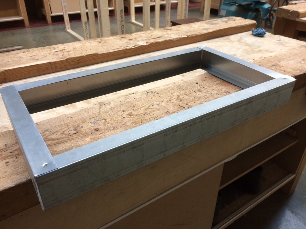

In a small experiment today I made up a small baseboard frame in literally 10minutes using metal studding. The completed frame was absolutely rigid, square, in perfect alignment and lightweight. I thought it was a novel way of building quick frames that would withstand many years of abuse.
The only problem I would envisage would be the obvious danger of contact with electricity.

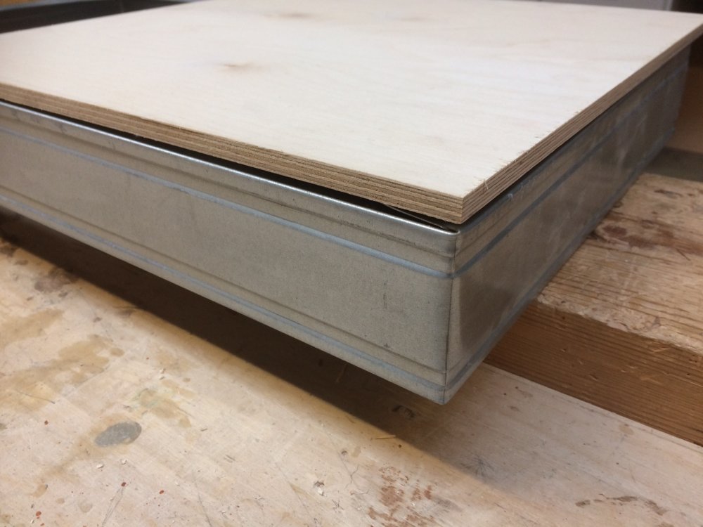

Heres a sample I made up today and it really is firm. It is very simple to fit an intermediate section for added strength but really no need.
Theres no risk of bending or warping, timber is more likely to do this through changes in moisture content.

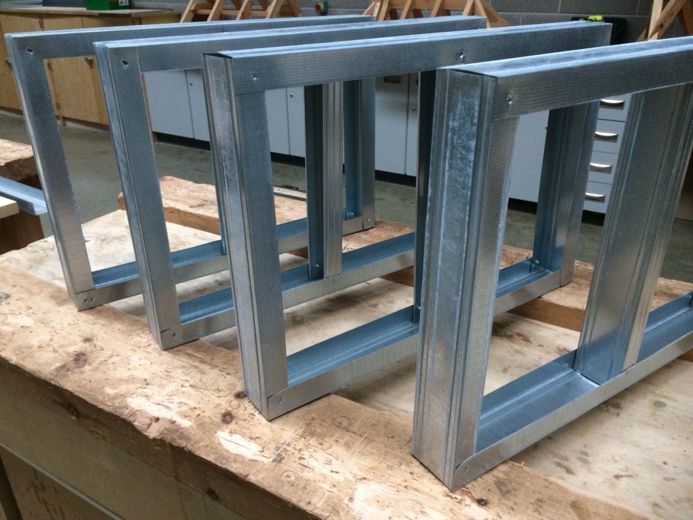

David, I would never have dreamt of it but our plastering lecturer had a large consignment of it donated for training purposes and there was a 'wee bit' left over!
37 minutes ago, Glenderg said:
Because metal studwork really only came into it's own in the last few years, mostly for commercial fit outs for ceilings and partitions. Less mess and dust, lightweight, easy to put together. R
I'll be honest, it took me less than 10 minutes to build each frame. Its so easy to cut and crimp using the proper dry walling tools.

A friend wanted them for an attic layout that needed to be transportable.
My only reservations about them is they aren’t as easy to bore as timber.
