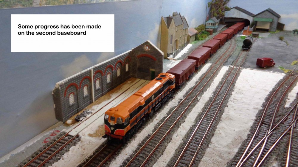

On my own today for a few hours so a bit of progress.
The time of year is supposed to be Autumn so I can have a variety of greens and browns. The trees are heather which has been lying in the loft for some 6 years and whilst it is quite brittle Haltwhistle and the surrounding countryside's  main contribution to nature can easily be re-plenished. It is probably somewhat over-scale.
The box needs an interior.

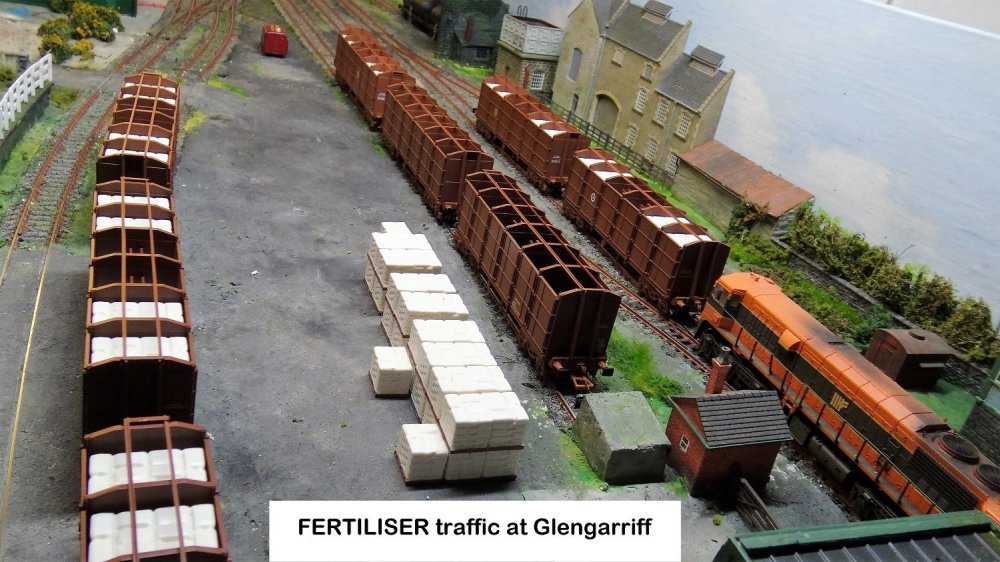

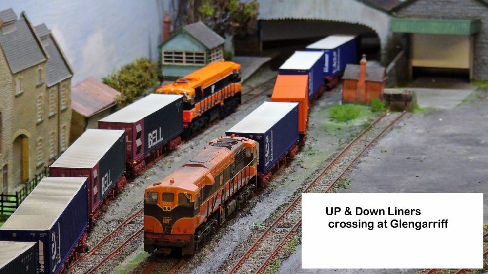

Fertiliser wagons arrived today.  Wagons are superb and run very smoothly. I removed all the loads from 1 wagon but won't be attempting the single pallets again as my eyes and arthritis are not up to it.
Unfortunately I had also cremated a pan of potatoes whilst I was up in the loft for an hour +, this will no doubt be followed by a grilling + roasting tonight when someone gets in from her job. Cookery!🥵 BAH!!!
Ernie
