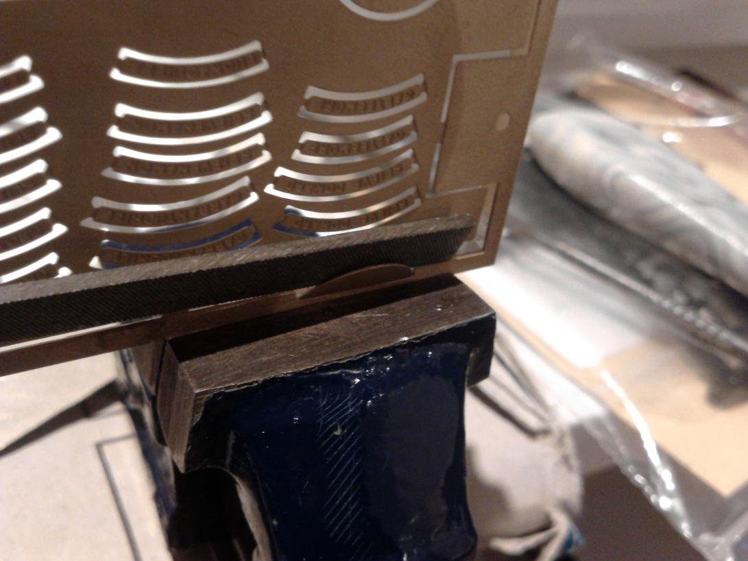

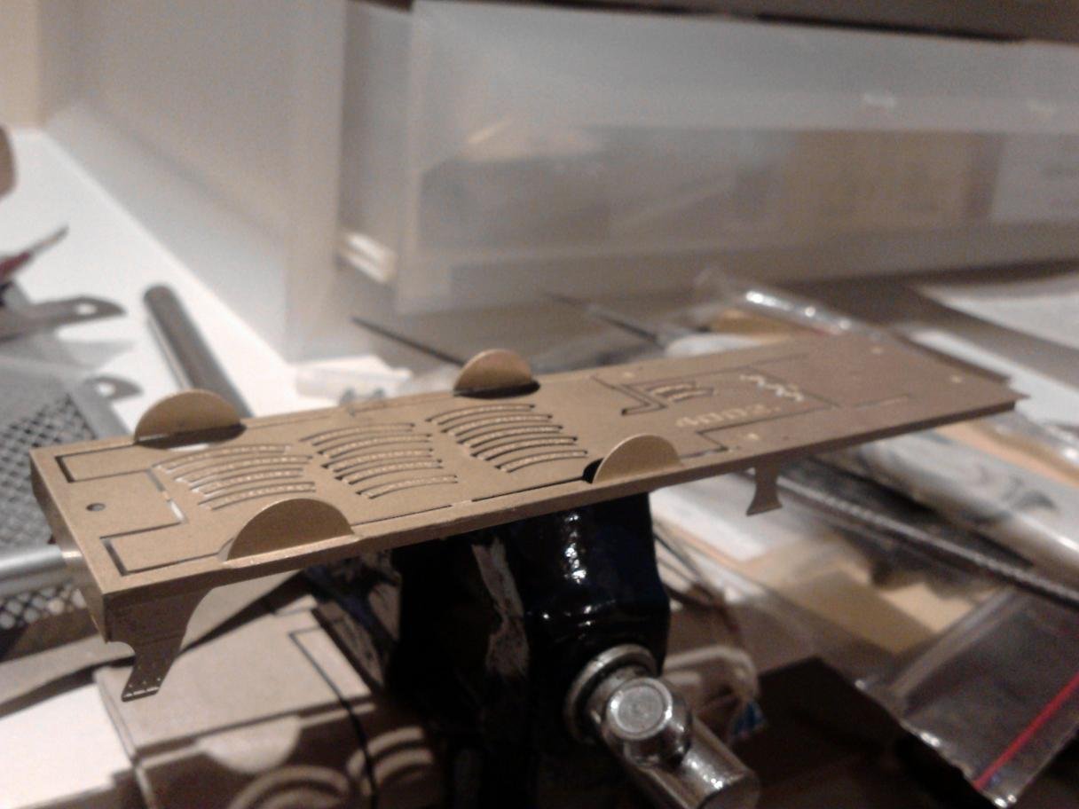

Just after another burst of work this evening. I did say I would start assembling the footplate (and the cab later) to give me an idea of how much space I would have for the chassis and its suspension system. OK so:

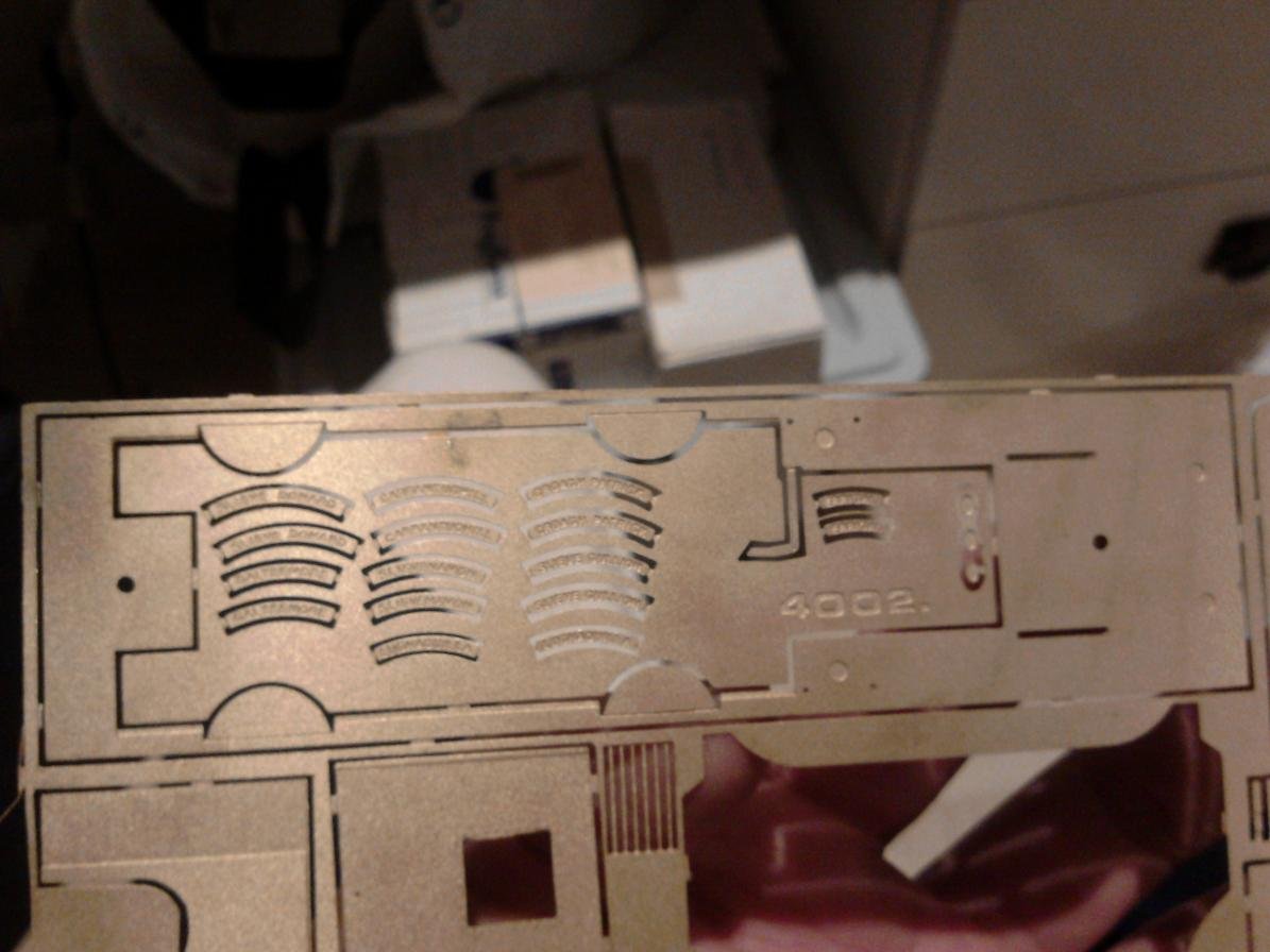

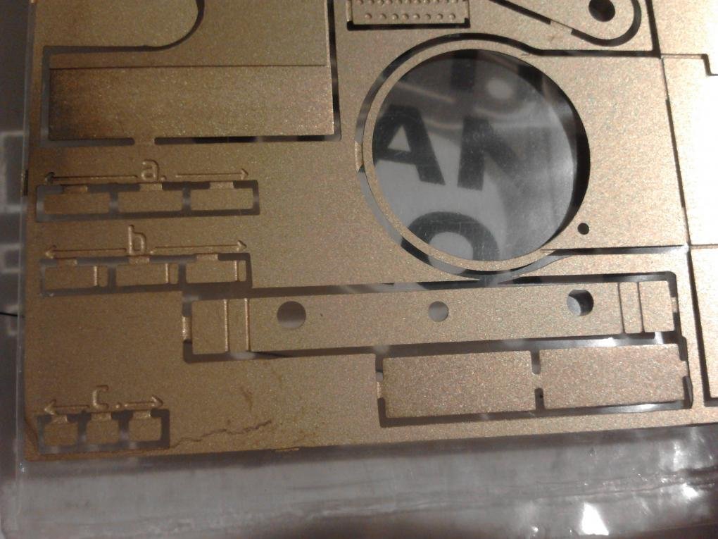

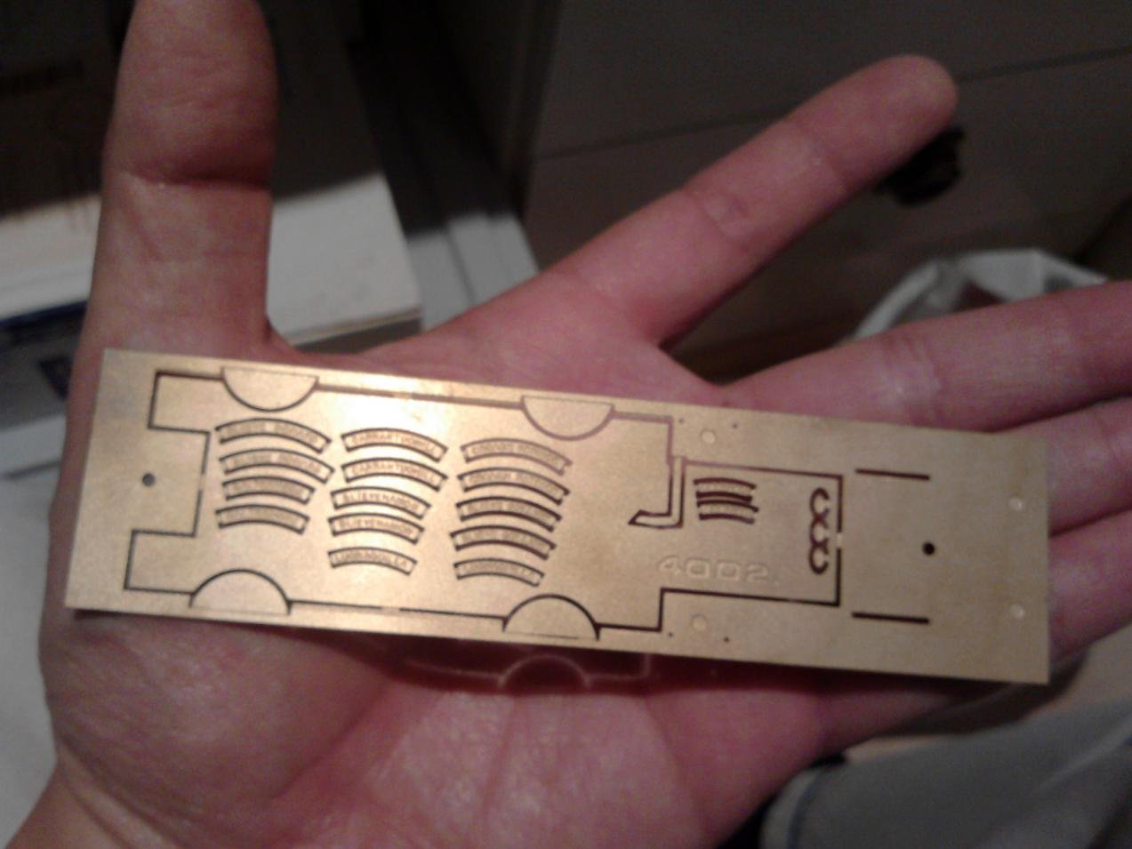

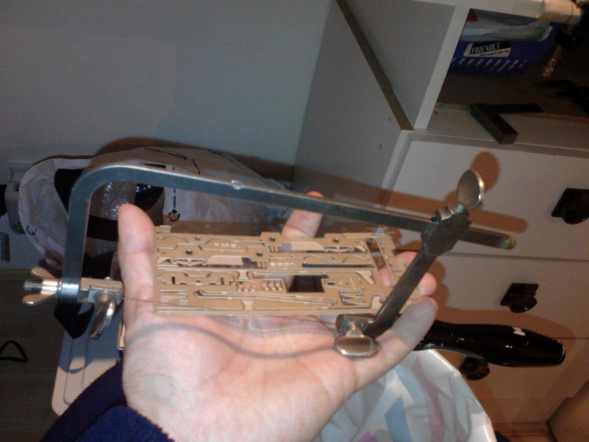

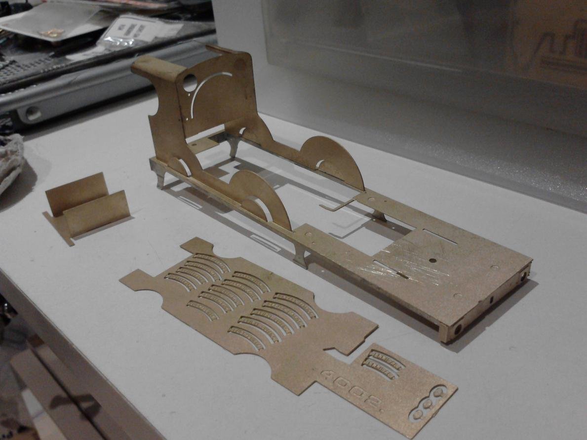

The instructions direct that the footplate (part P11) is sawn out of the body fret:
I did not remove the centre section (with the nameplates on) as I wanted the footplate to stay as rigid as possible.

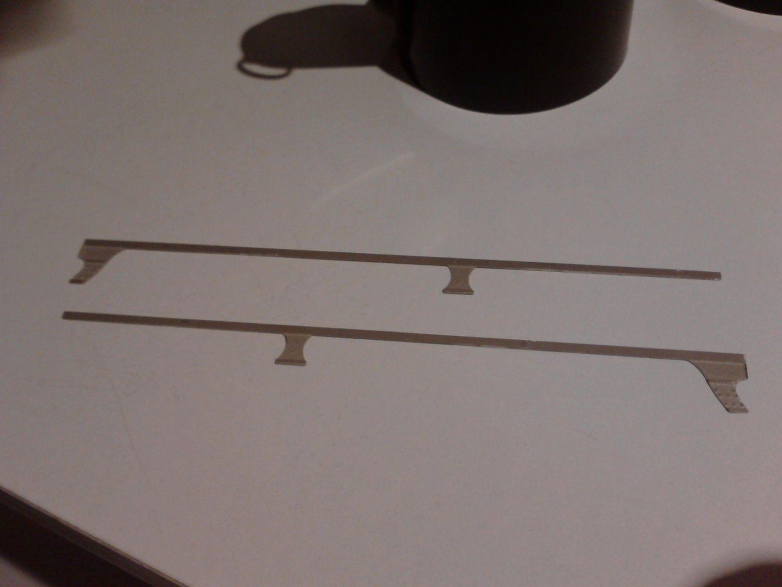

The instructions now dictate that the valances (part P8 x2) are removed from the chassis fret:

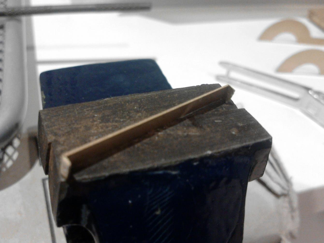

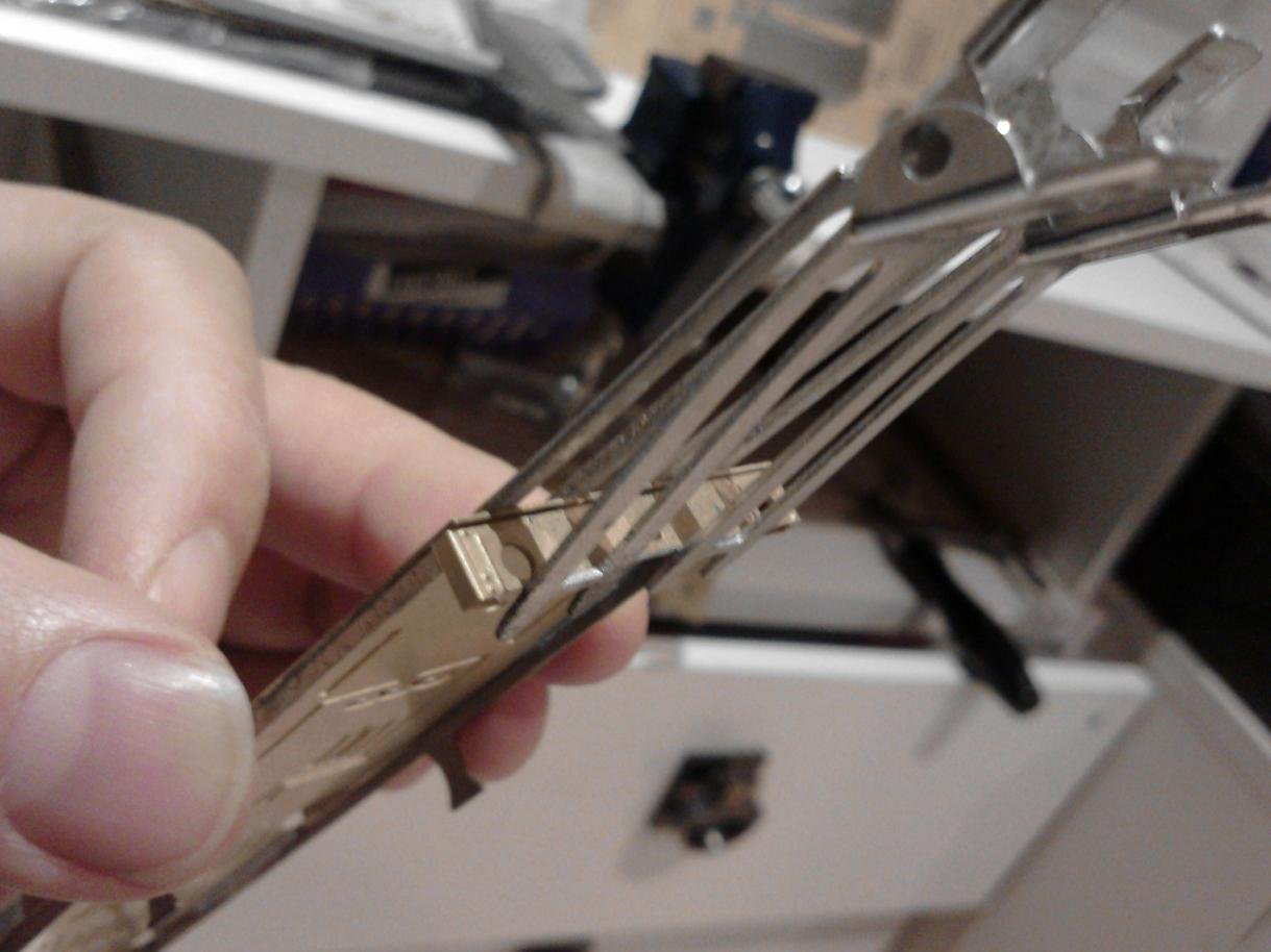

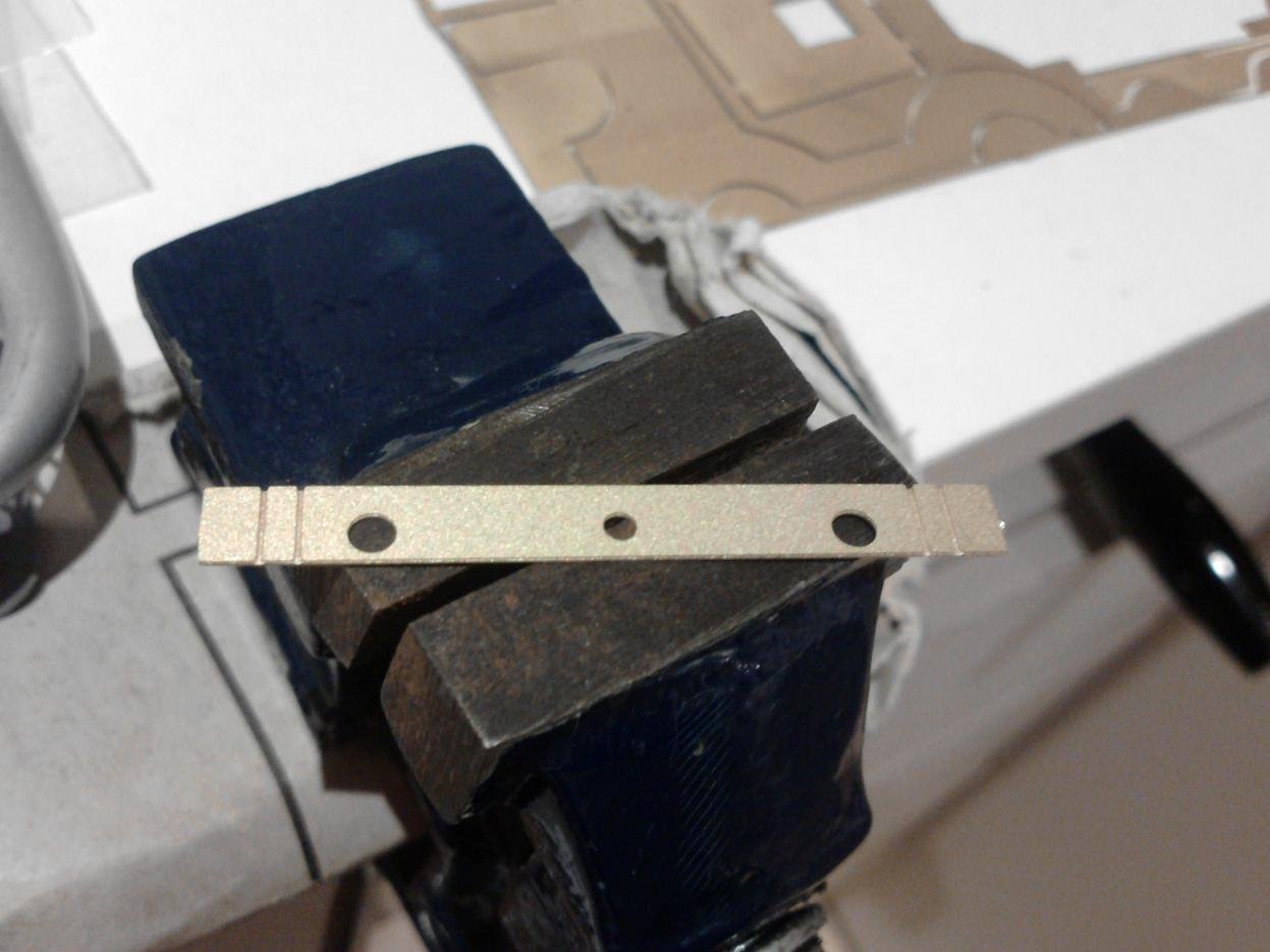

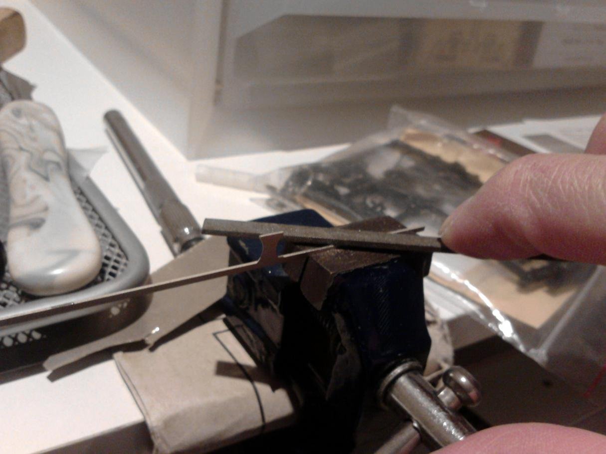

It helps if you have a small vice to trap parts for soldering and filing jobs. I'm removing the traces of tabs from a valance here:

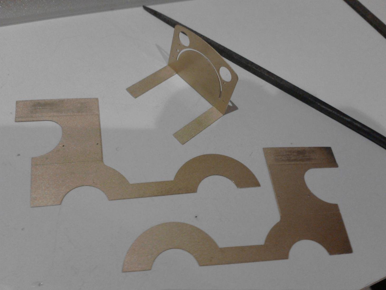

....and we end up with nearside and offside valances ready to go on the underside of the footplate:

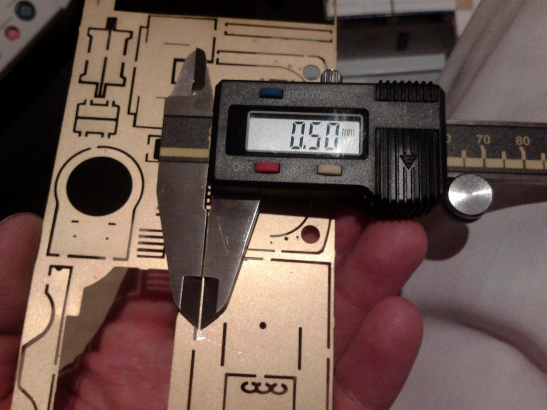

These valances must each be fitted 0.5mm from the edge of the footplate, so we use the digital calipers to help mark the positions at each end of the footplate underside:

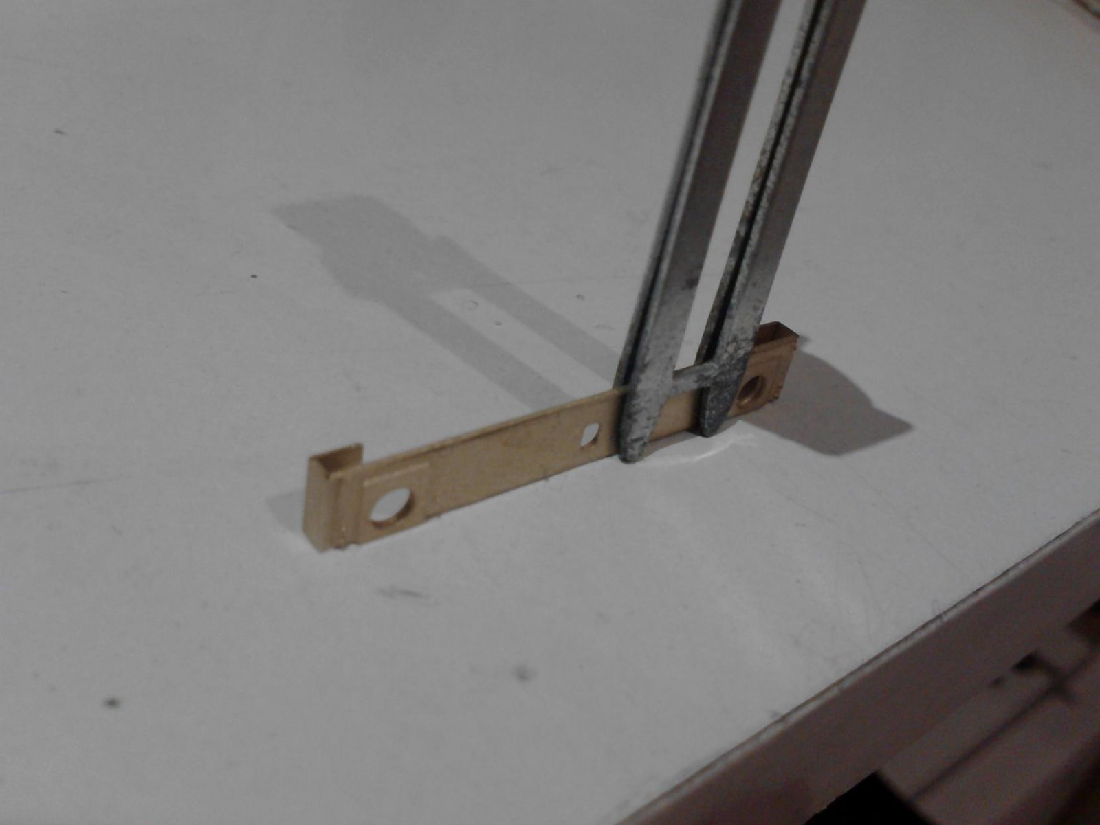

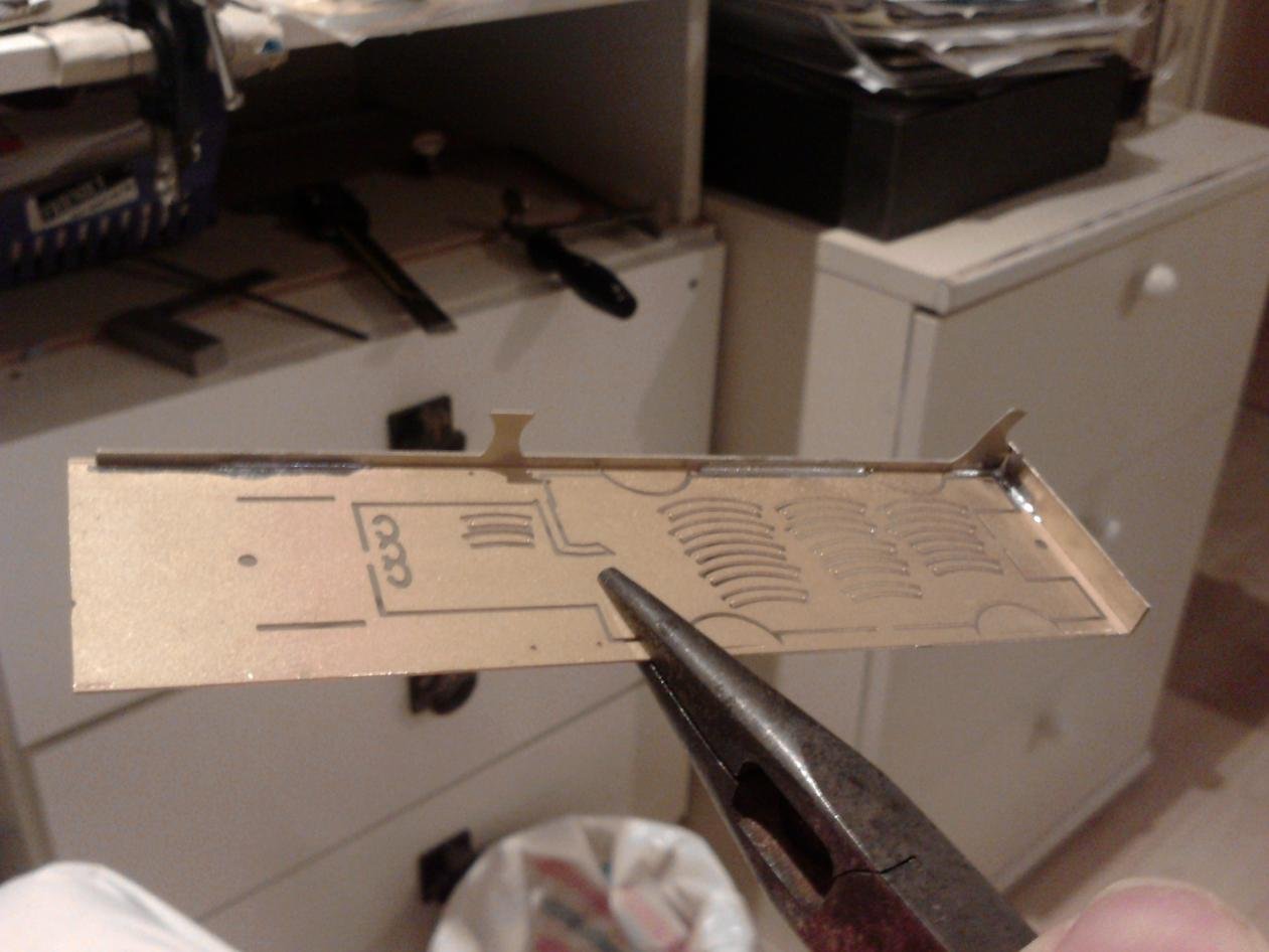

Next stage is to bend down the rear drawbar at the rear of the footplate. There's a half-etch line for this, which you must have at the inside of the fold, and it's a simple 90-degree bend:
....and there ye go:

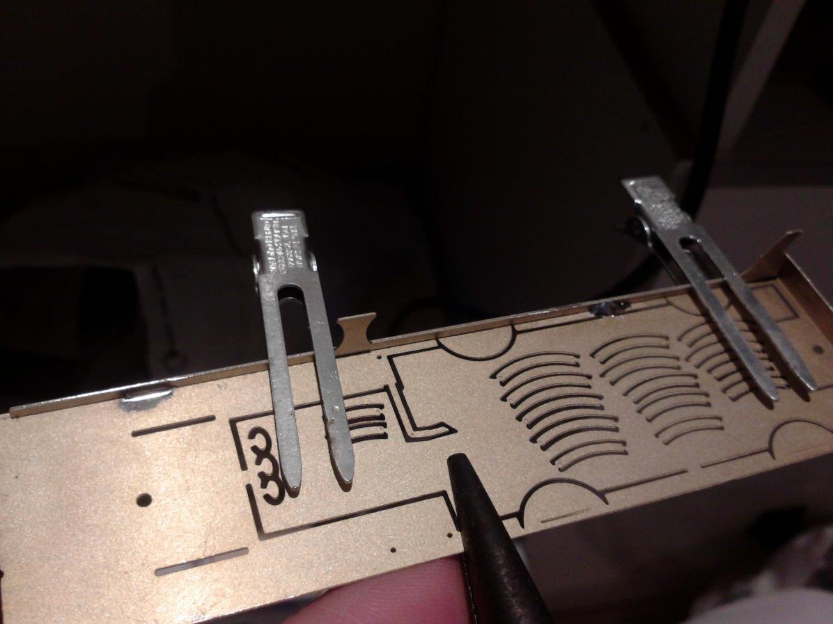

The actual positioning of the valances in the right place, ready for soldering, was the part I really loathed. Remember that the original design of this kit is nearly three decades old, so there are no tabs-and-slots, or etched guidelines; you must use the marks you made earlier at each end, plus a couple of hairclips, to keep the valances in line and at 90 degrees to the underside:
The potential nightmare is having the hairclips let go and the valances falling off during soldering. I had to be gentle when brushing flux along the join, and then being very quick with the soldering iron (I use a 25w Antex for most work) to tack solder at strategic points, a bit like the oul "spot welding":
If it stays upright, I can then flow the joint so that the solder spreads along it. You don't need a lot of solder, and I only flowed it in three areas:

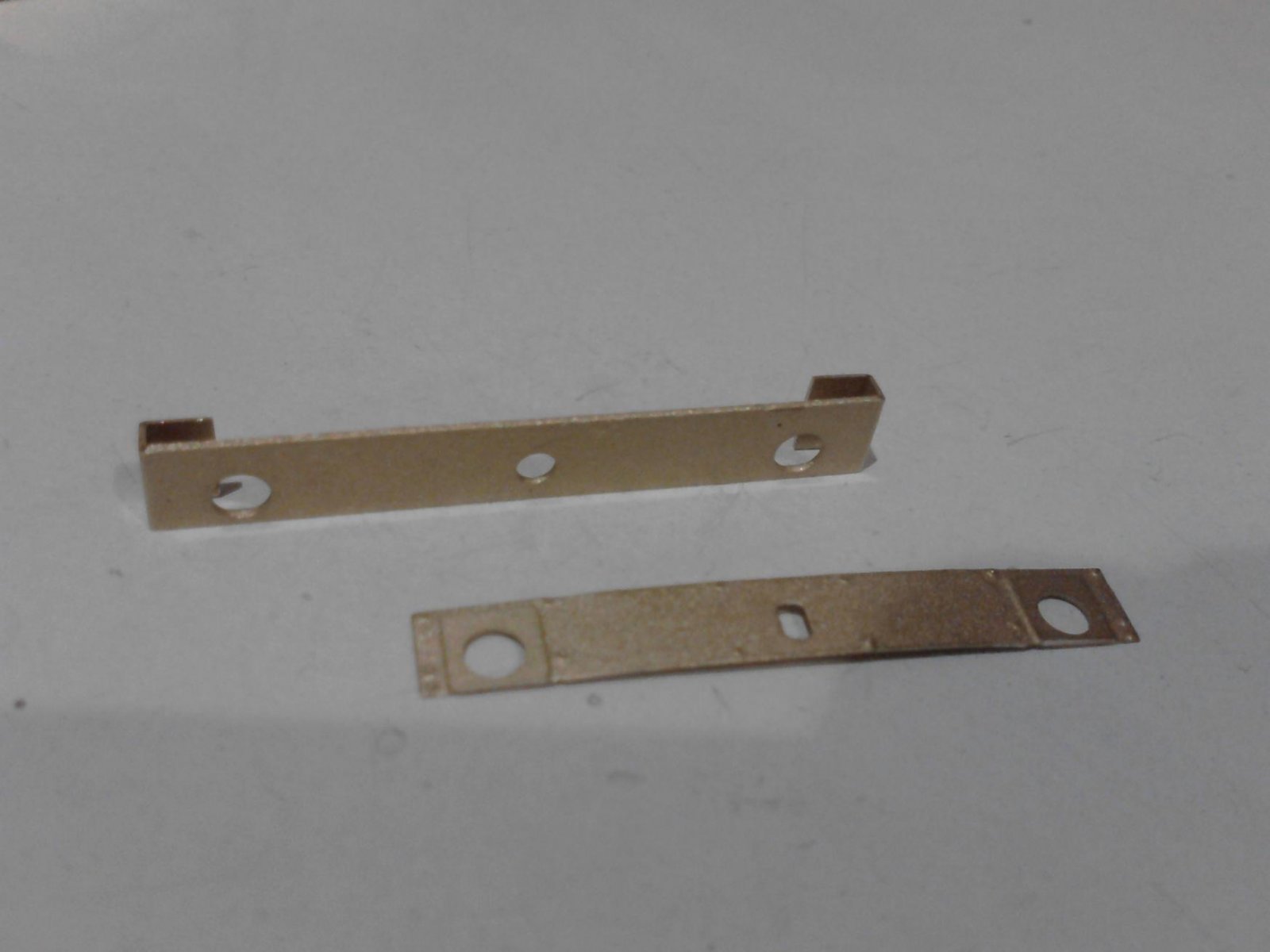

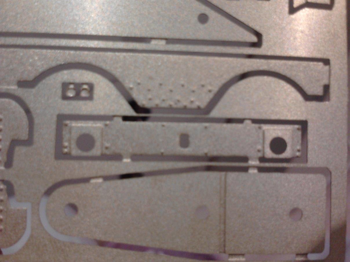

OK so, here we are again after getting distracted by work. "Work is the curse of the drinking classes" (Oscar Wilde).

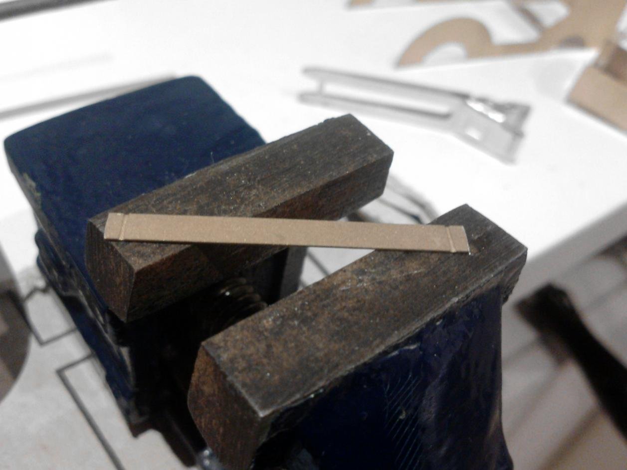

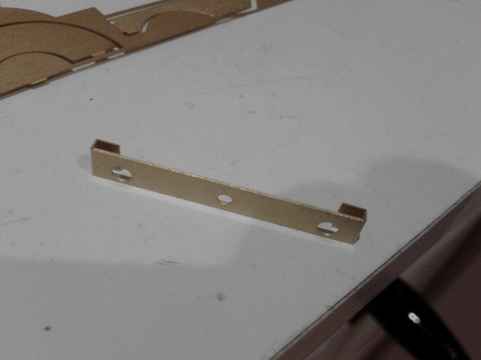

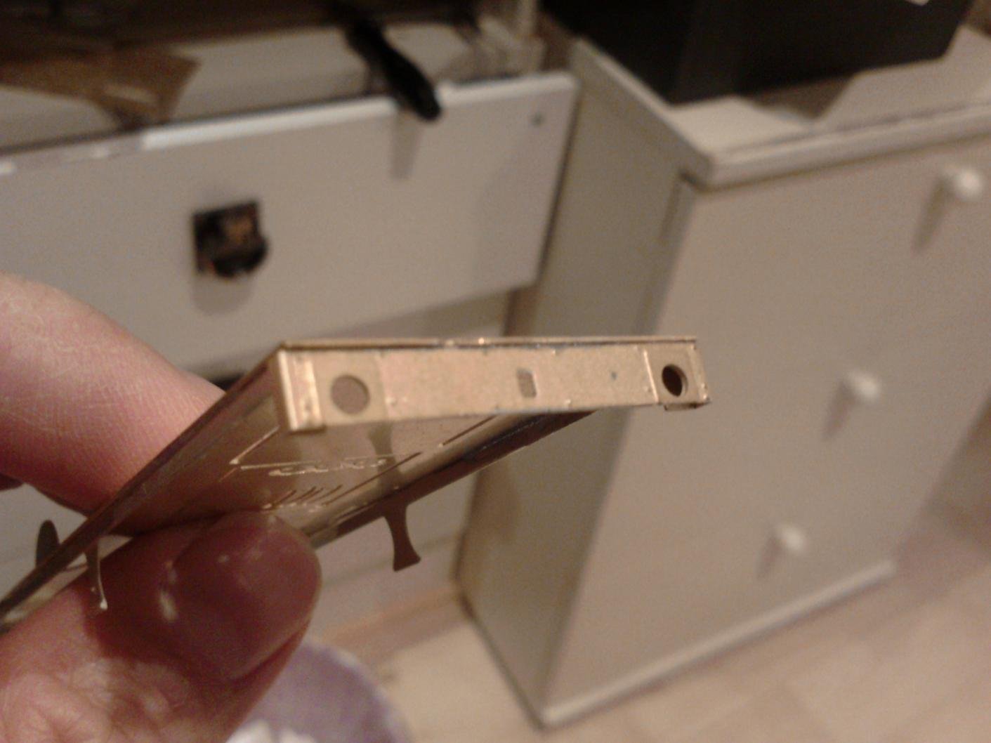

The next job on the instruction sheet is relatively simple, involving part P37 (the buffer beam inner frame)
and P41 (the beam overlay):

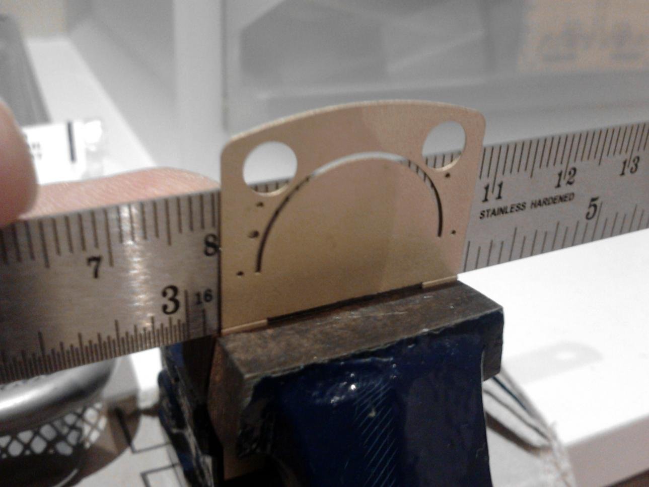

What the instructions don't tell you is that part P37 has to be folded according to the etch lines at each end of it:
This followed by P41, the overlay which needs to be soldered over it:
Remember that the square buffer bases must be at the lower edge of the overlay, not the upper! You only need to flow the very minimum of solder, because the next job is to fix the completed buffer beam to the footplate you made earlier. It takes time to make sure you've got it all in line, and the back edge of the buffer beam "sandwich" must butt up against the front edge of the footplate valancing:
Again, only the minimum of solder should be flowed into the join - and it's best to run it from the inside (or behind the beam) so that you don't get solder going all over the rivet detail:

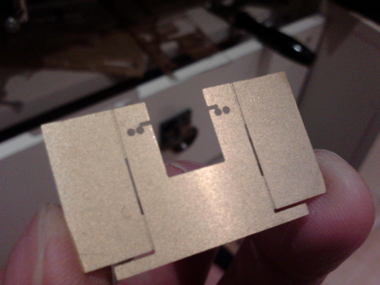

The instructions do mention that you should now fit half-etched sandbox filler caps (Part P49) into the half-etched holes in the footplate, and footsteps P34a, P34b and P34c. This is up to you. I chose not to add these details yet as I wanted to make sure I had the main structure looking right.

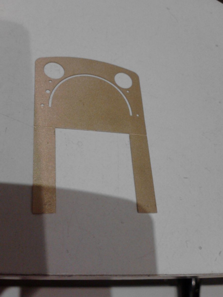

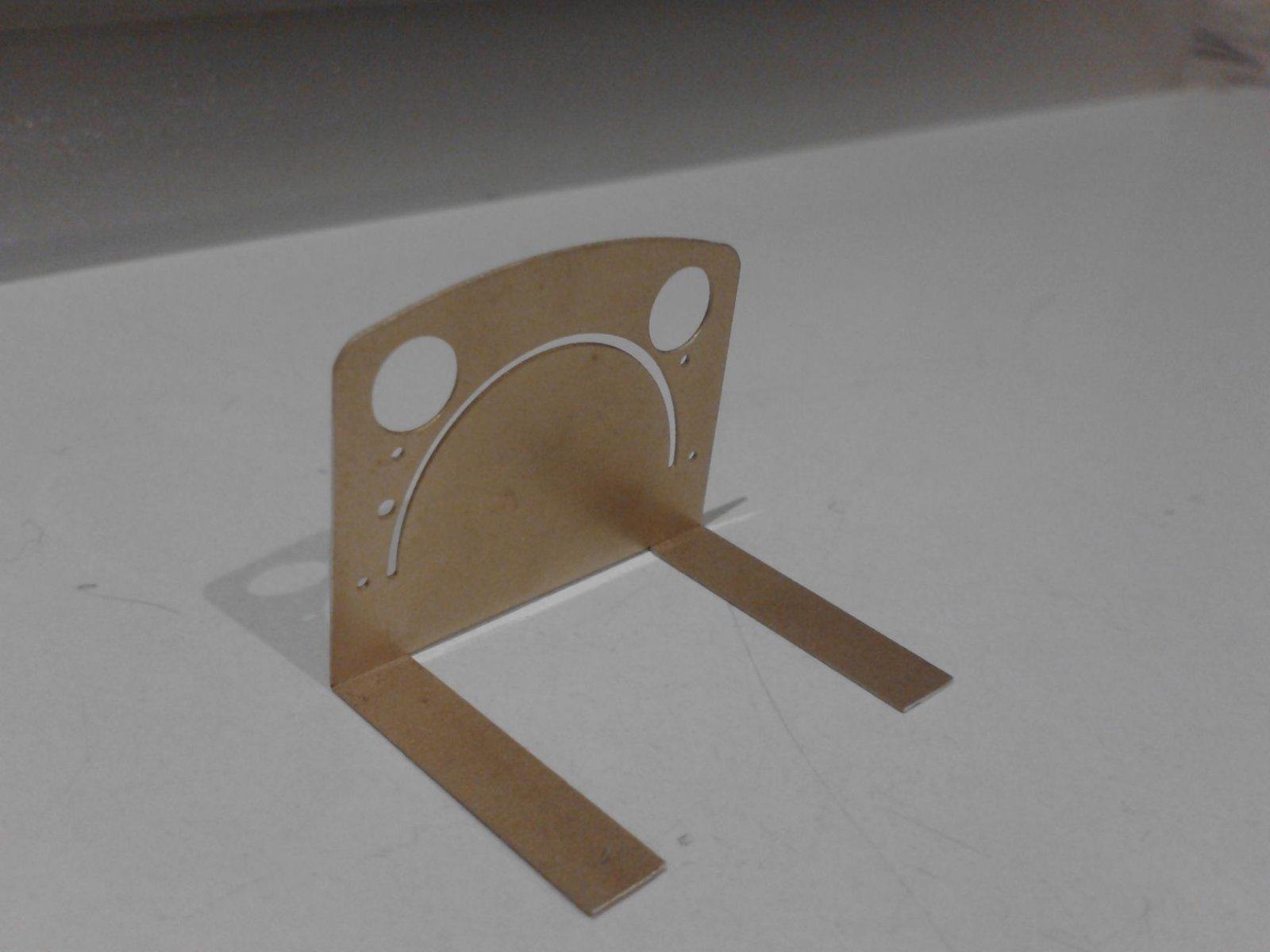

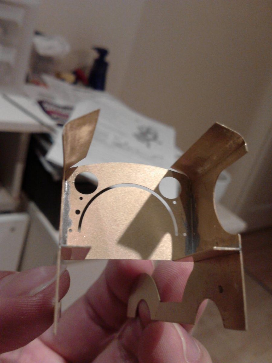

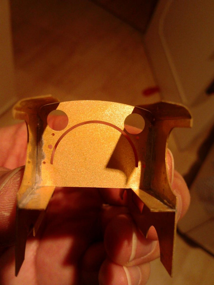

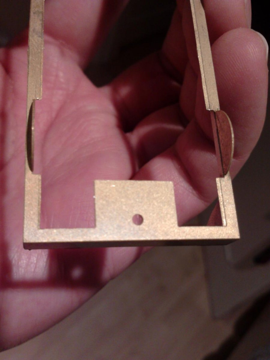

Therefore the next job for me was part P21, the cab front inner frame:

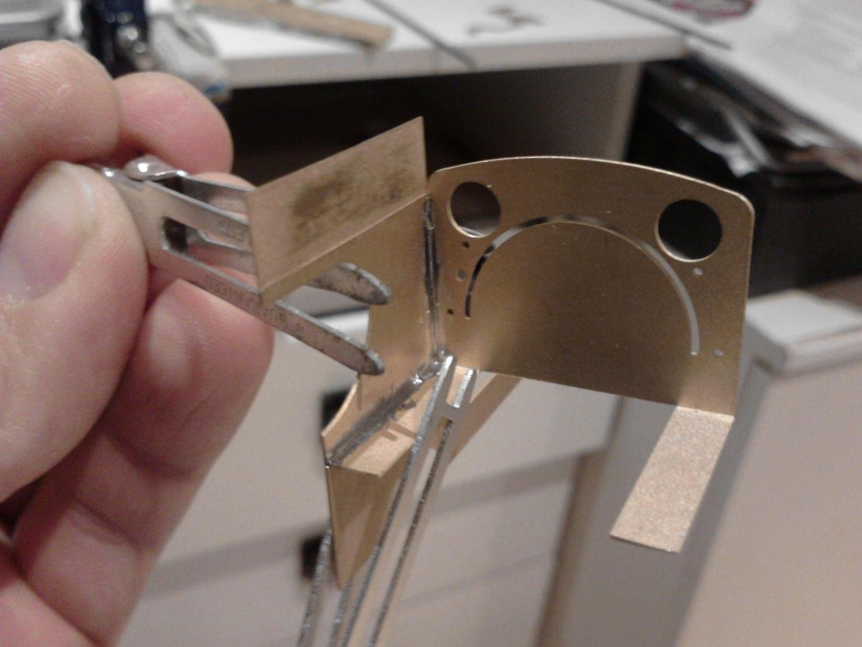

The legs of this are folded at right-angles - I use my mini-vice to hold it and the steel ruler to do the actual job of bending:
This task should be as simple as hiding your assets....
....outside the jurisdiction of the Republic:

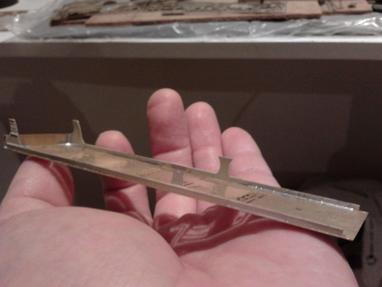

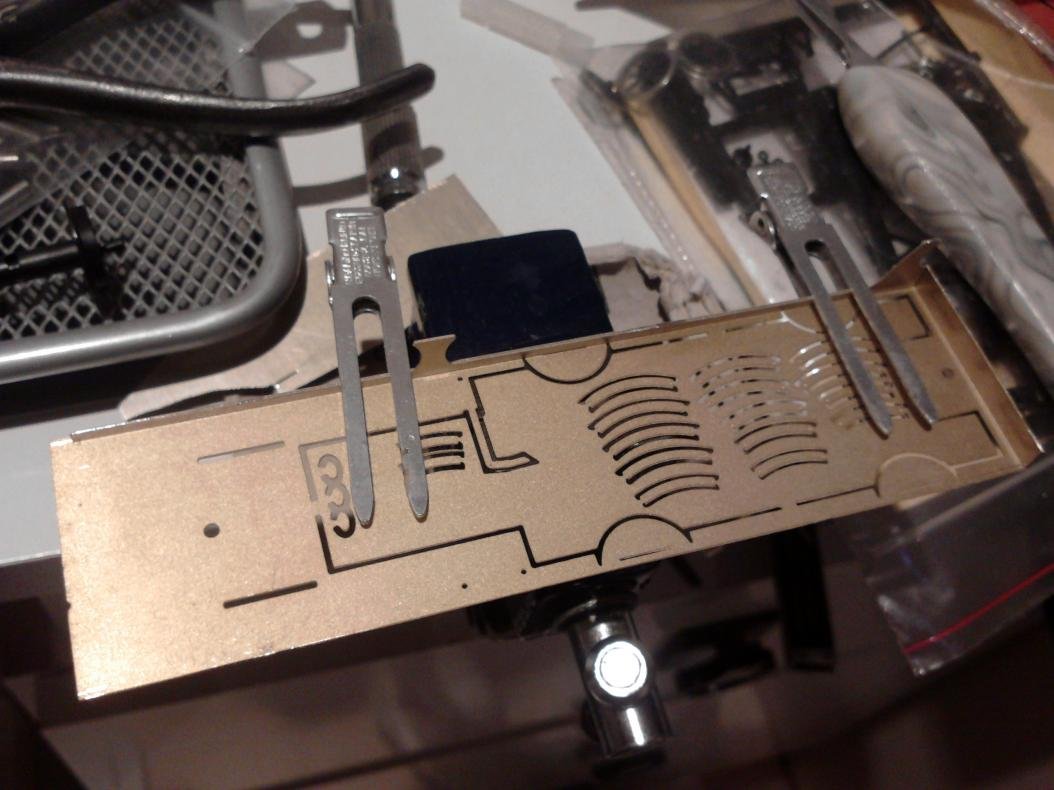

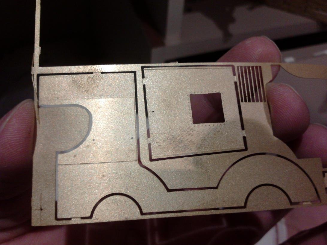

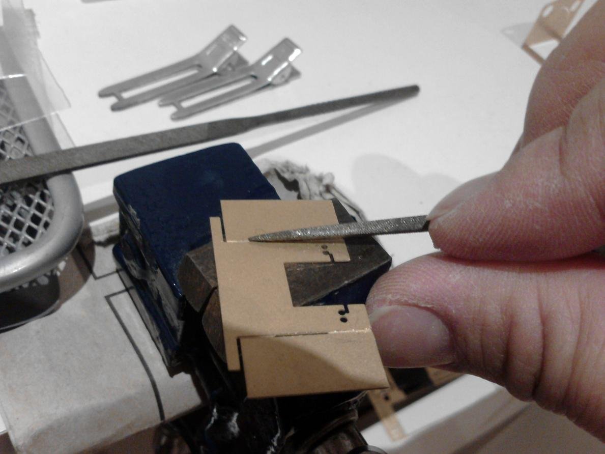

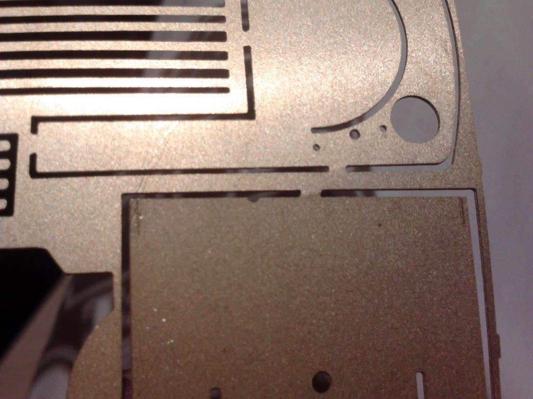

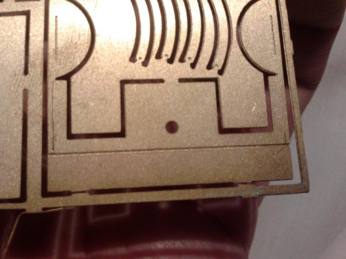

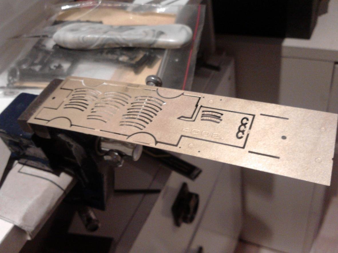

I also took a look at part P24, which is the cab floor (including the inner splasher sides for the trailing driving wheels):

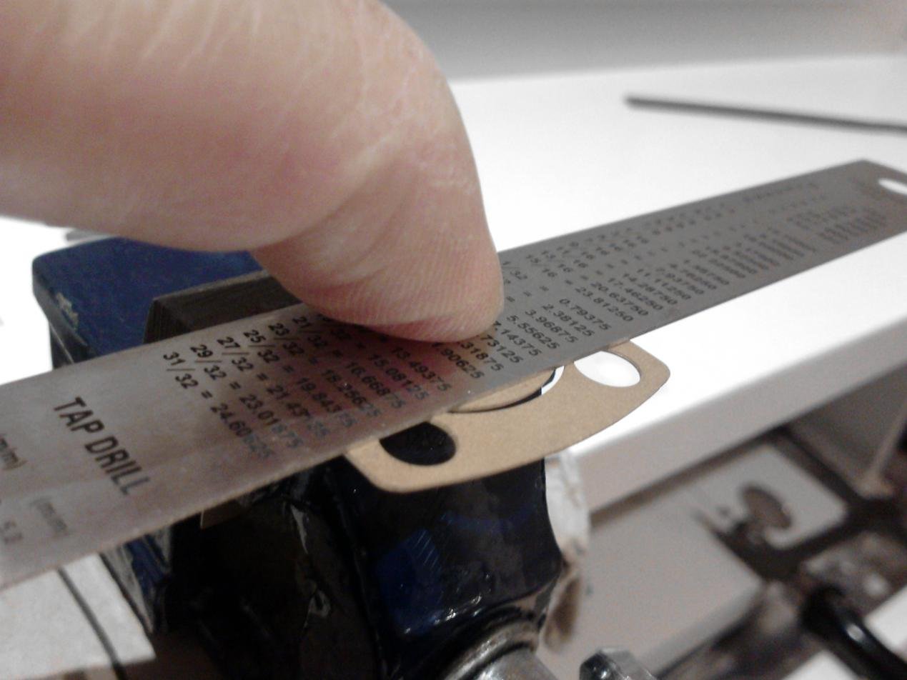

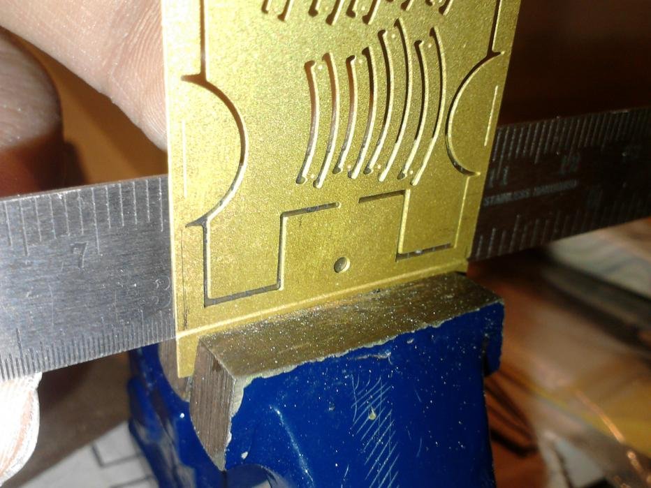

The etch lines on it are a bit weak, and could be usefully widened with the apex of a triangular needle file:
....and that helps you achieve a cleaner 90-degree / right-angle bend:

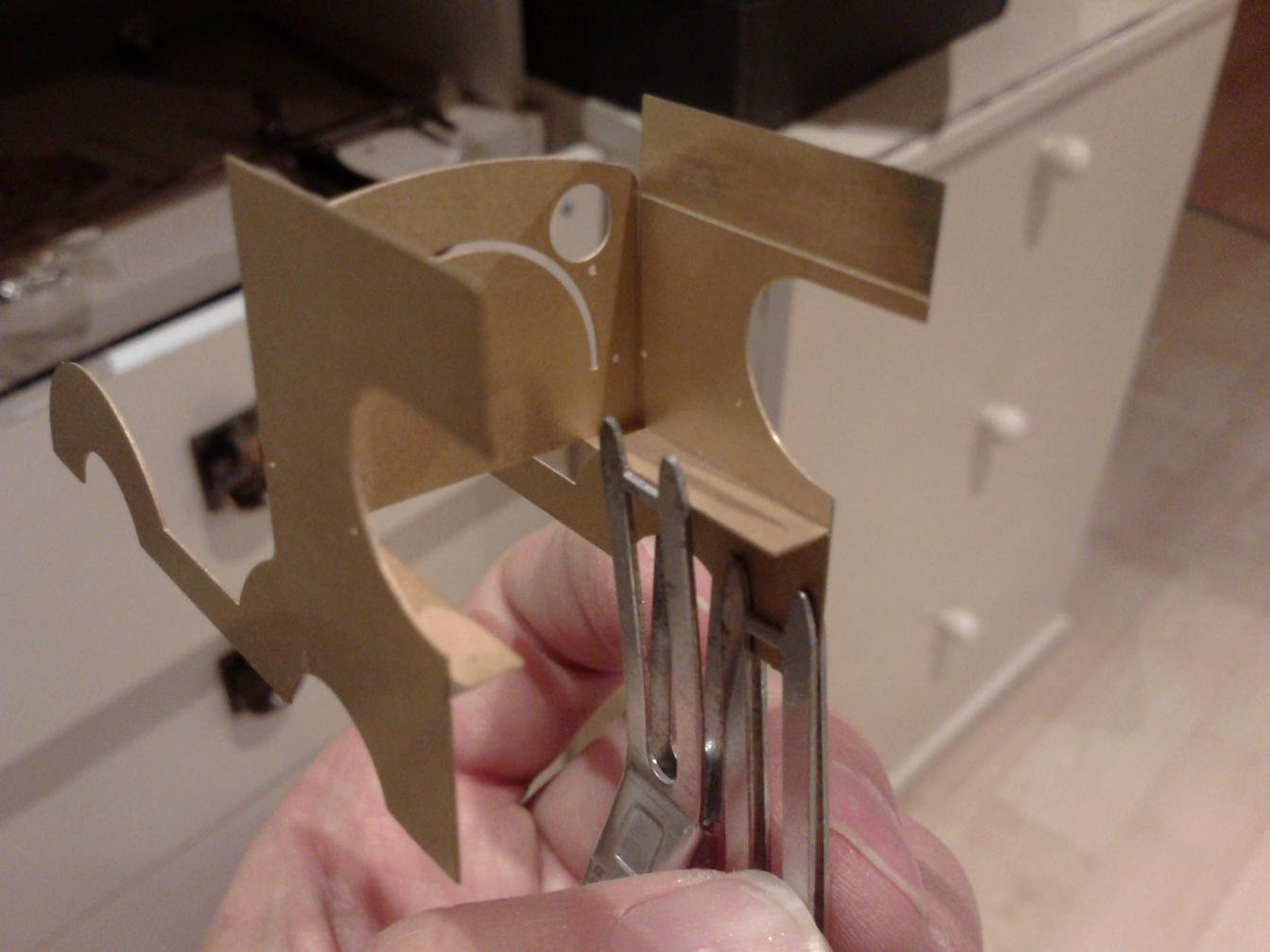

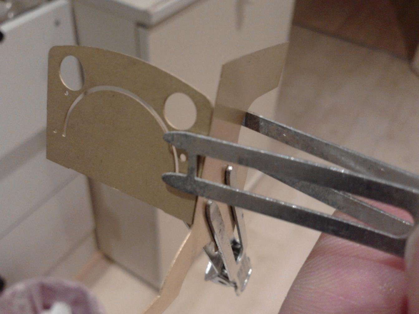

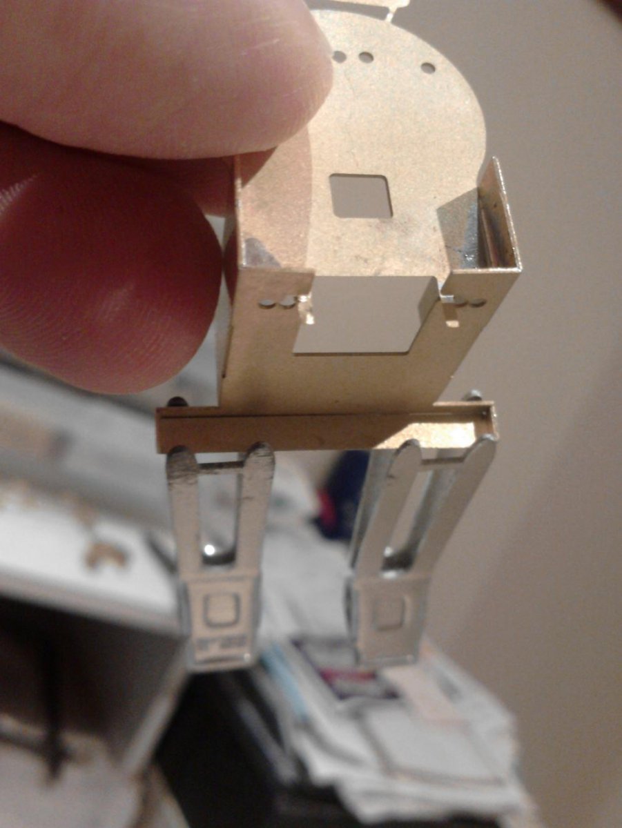

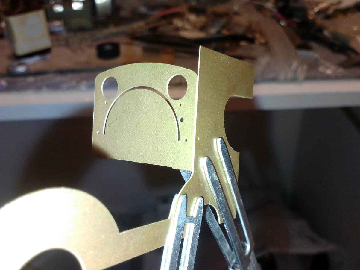

Returning to the instruction sheet, Parts P18 (nearside and offside cabsides/splashers) are now removed form the fret:

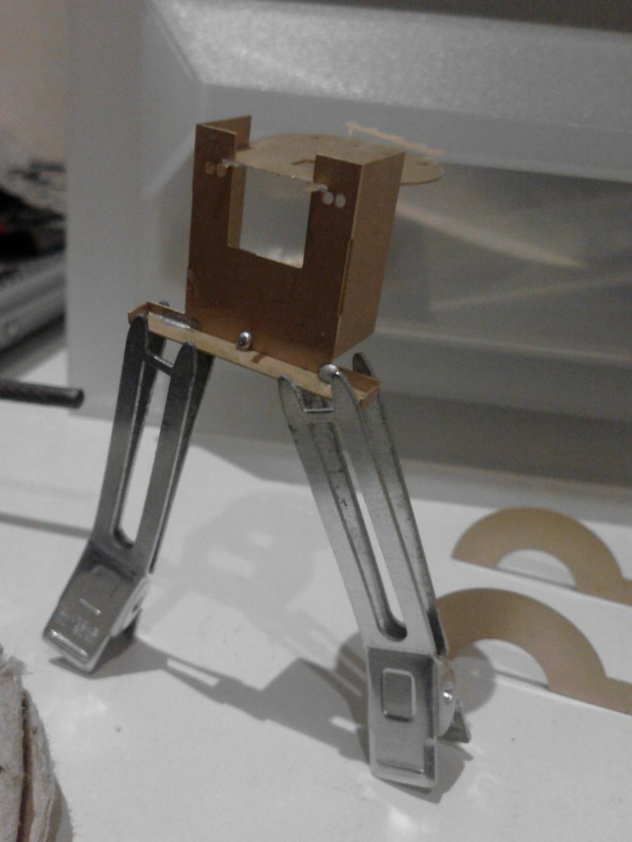

The insides of the cabsides have horizontal etched lines. These act as guides for the cab front assembly, and what you do is run the "legs" of it along the etch lines:
...whilst simultaneously making sure the cab front is flush with the leading edge of the cabside:

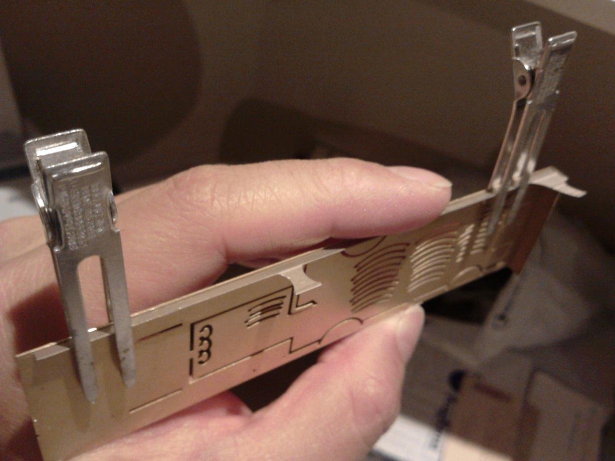

Setting this all up was sheer hell, but hairgrips - if arranged the right way - have enough tension to keep things together to allow you to start soldering:
Once again, only run the minimum amount of solder that you think you can get away with:
....before repeating the process with the offside cabside:
Now is the time to balance your cab and splashers on the footplate, just to see how things are looking:

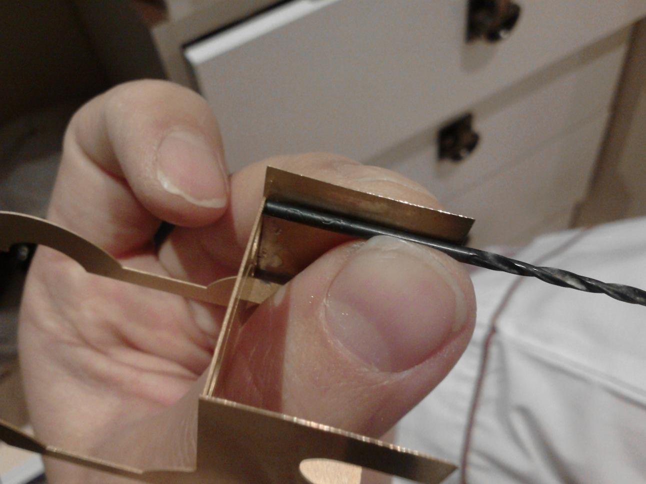

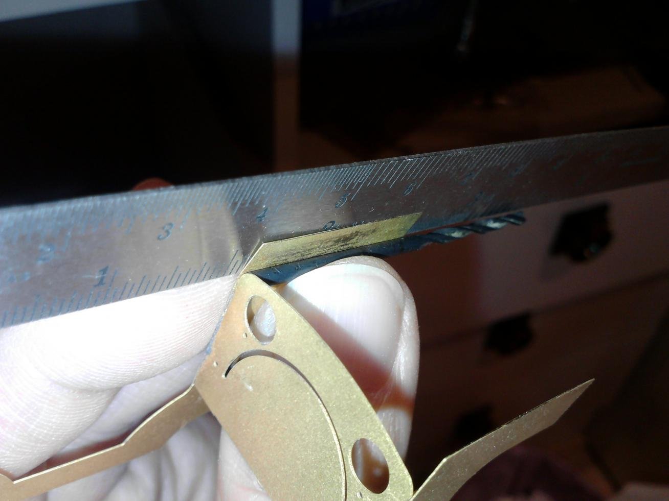

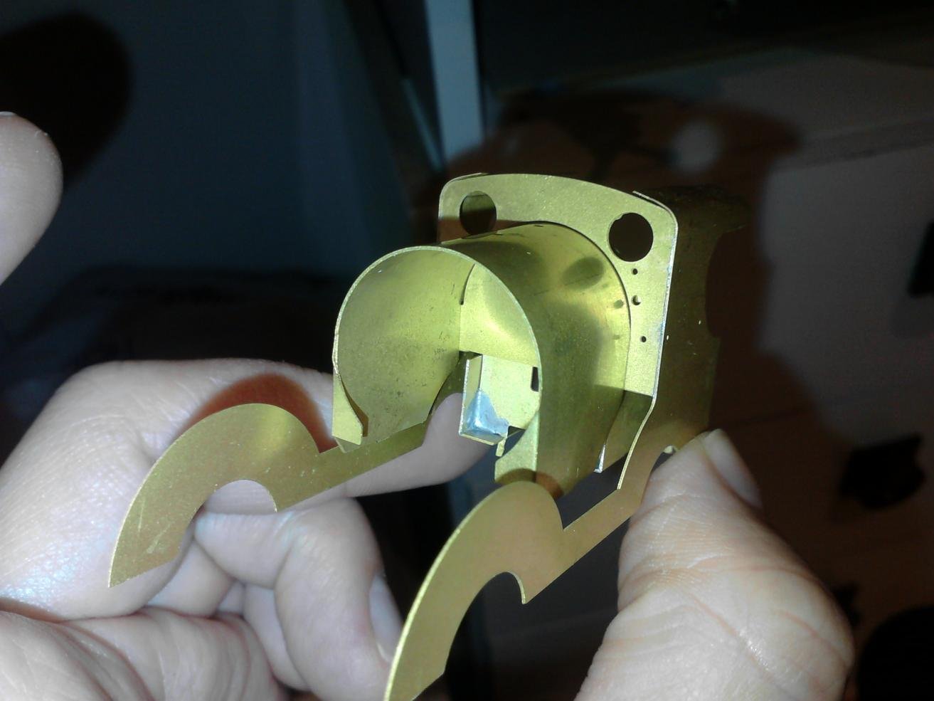

The "S" class has a very Edwardian wrapround roof, and these are a total swine to form cleanly, as brass and nickel-silver will distort in all sorts of unexpected ways. SSM/TMD try to make the job easier by making the roof eaves half-etched, but there is so little material above the cabside's curved cut-out that the whole lot will deform.
The instructions say that you should bend the top of the cabsides, using a 2mm rod to get the right sort of curve. This isn't quite as easy as it looks:
I tried to attain a clean curve by using a steel rule at the back:
....but the grade of brass in this old kit was a bit mad, and I found the task difficult to control properly. The following photo shows the extent of the problem:
As you can see, the offside roof eave is almost there, but the nearside shows signs of distortion, and it will need more work with the 2mm drill former to correct. At this point, I felt a bit like that episode where Father Ted is contemplating his "repair" work on the dent in the car that the Diocese gave for the raffle to raise funds to fix the Parochial House roof.......

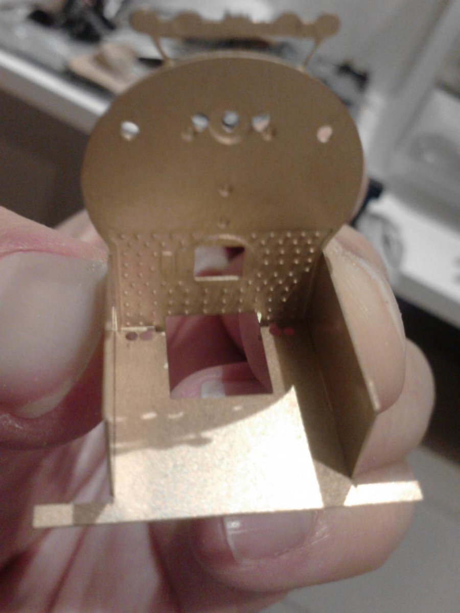

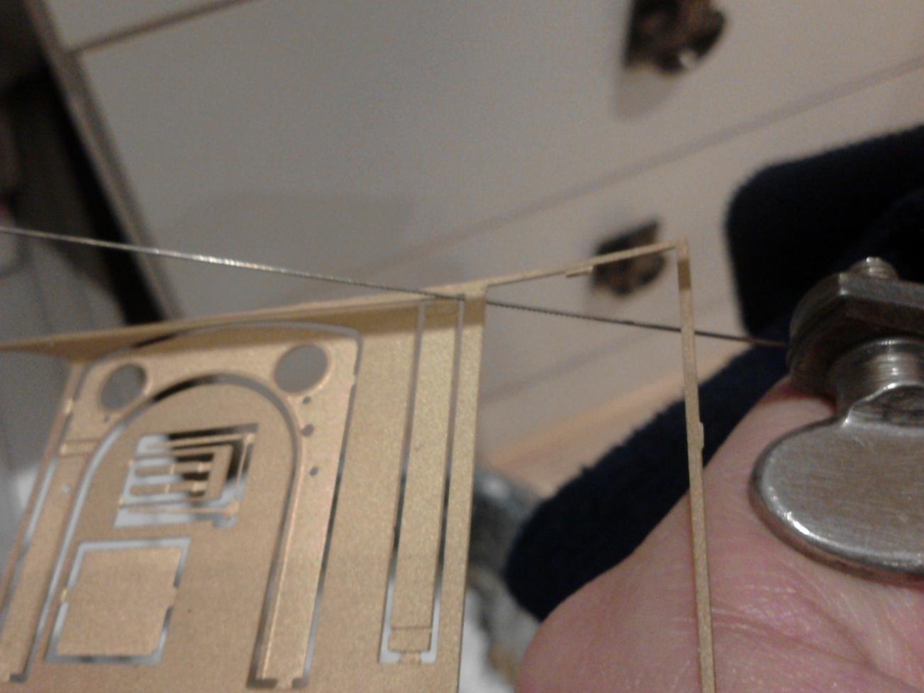

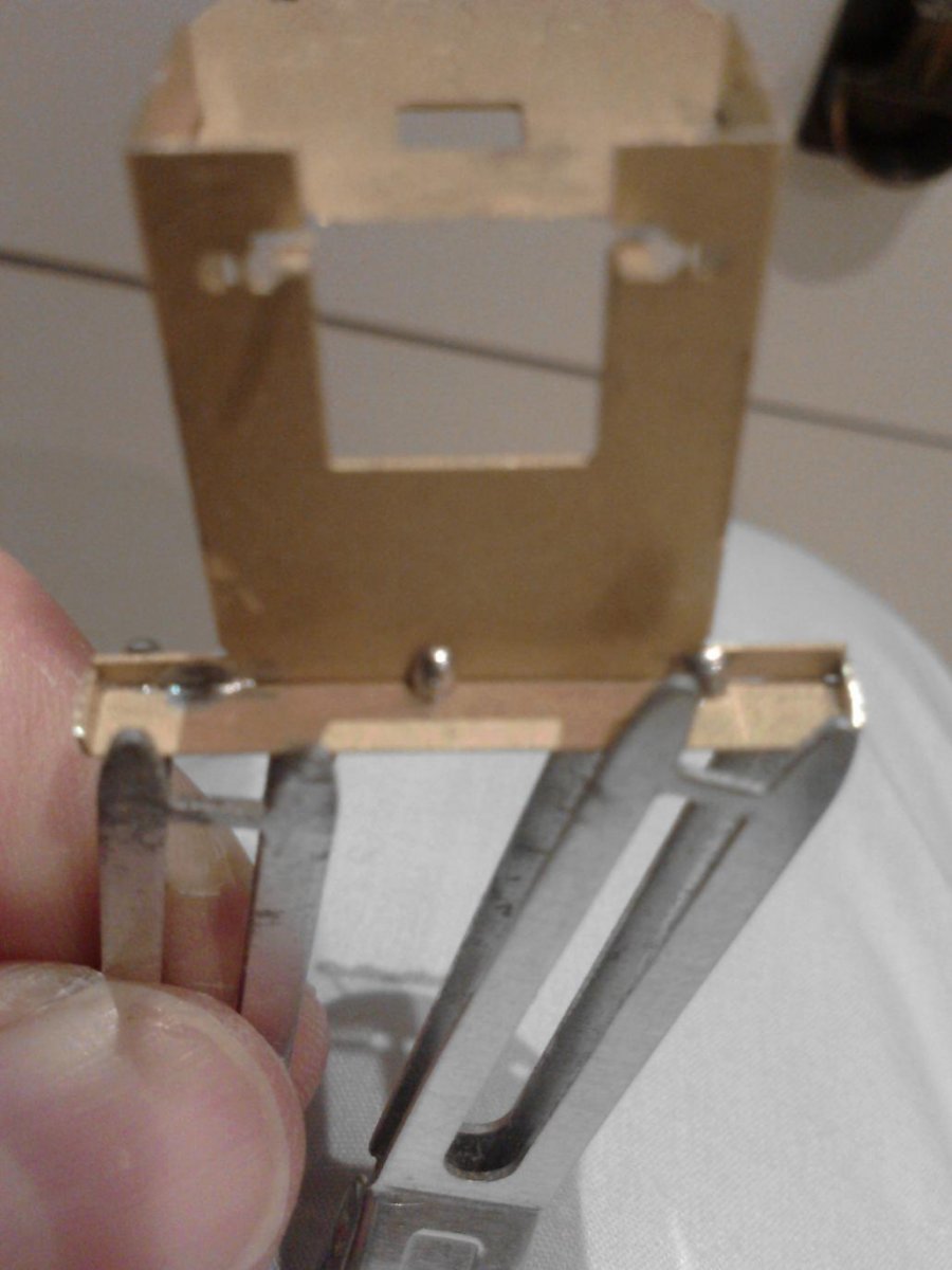

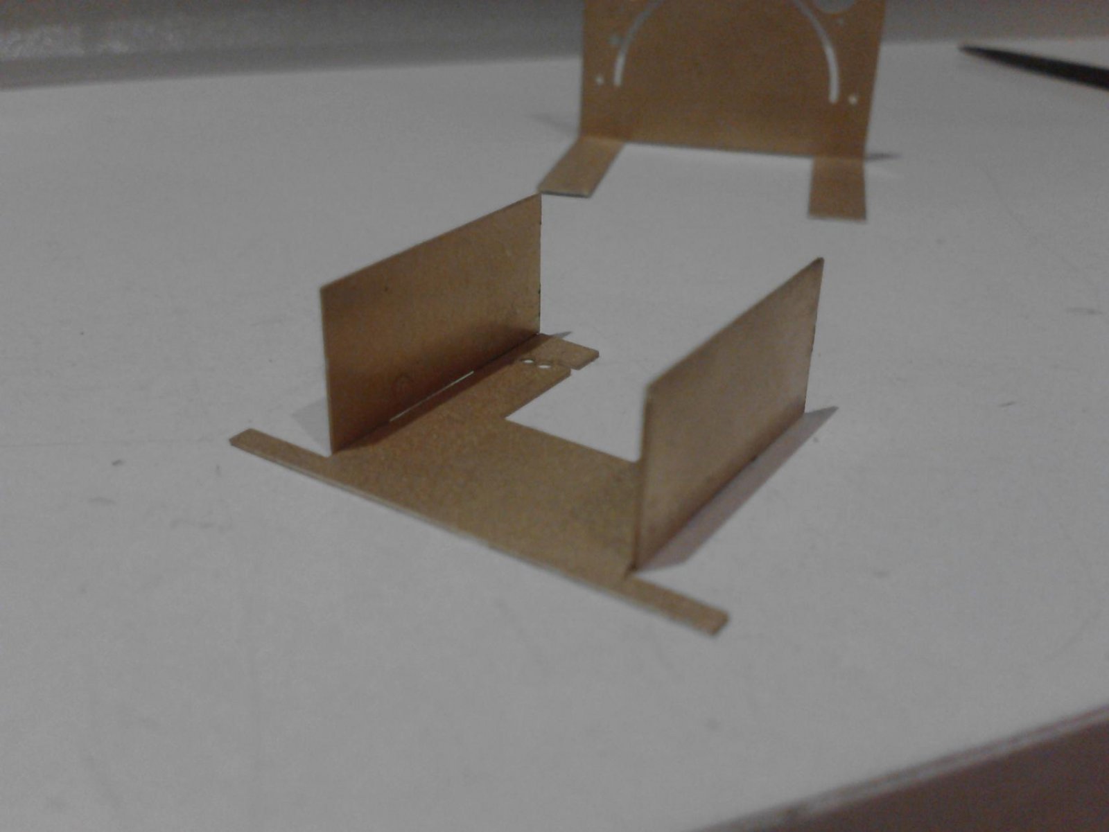

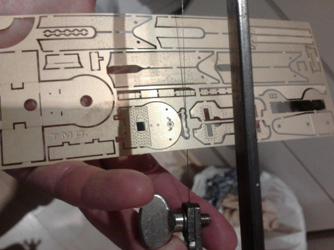

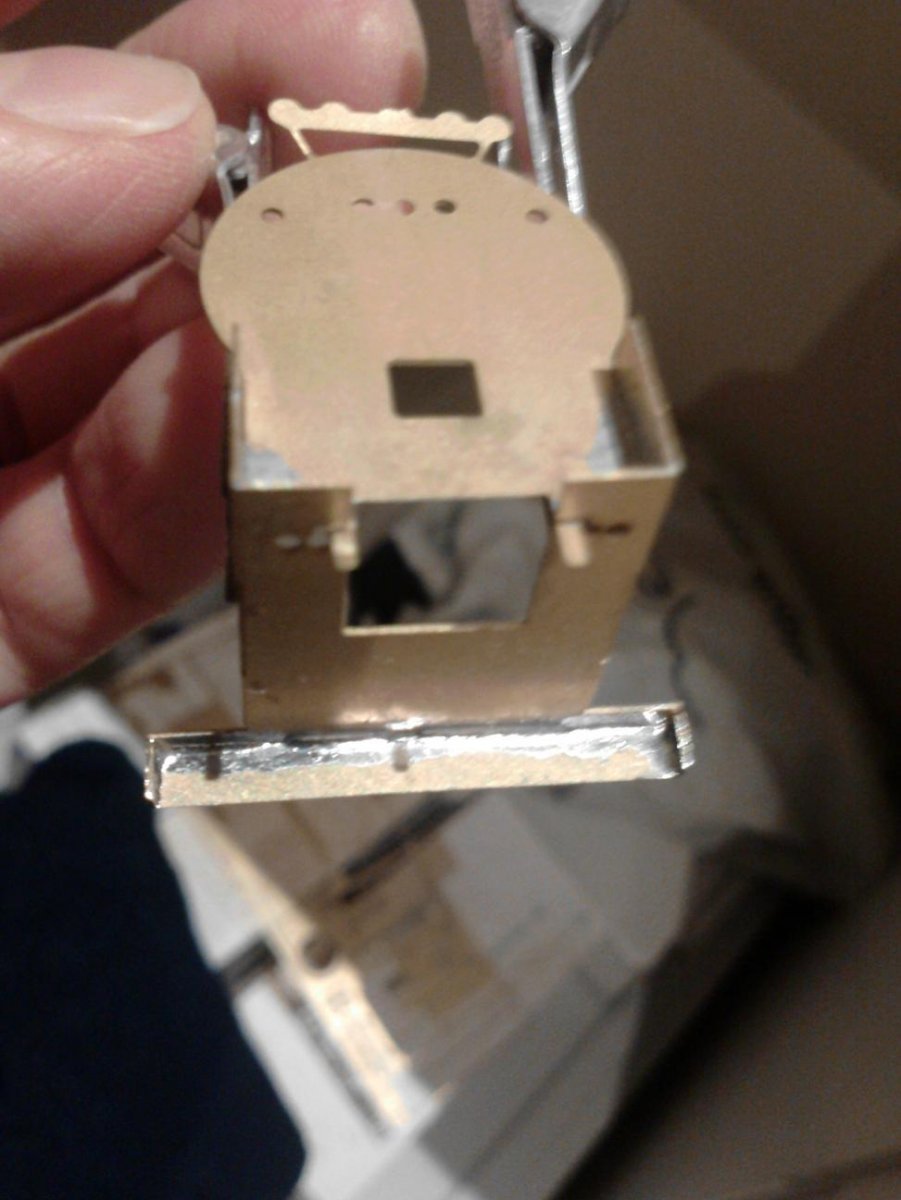

This evening, the instruction sheet order was skipped somewhat, and the backhead (part P48) was removed from the etch, and inserted into the cab floor that I'd formed earlier:

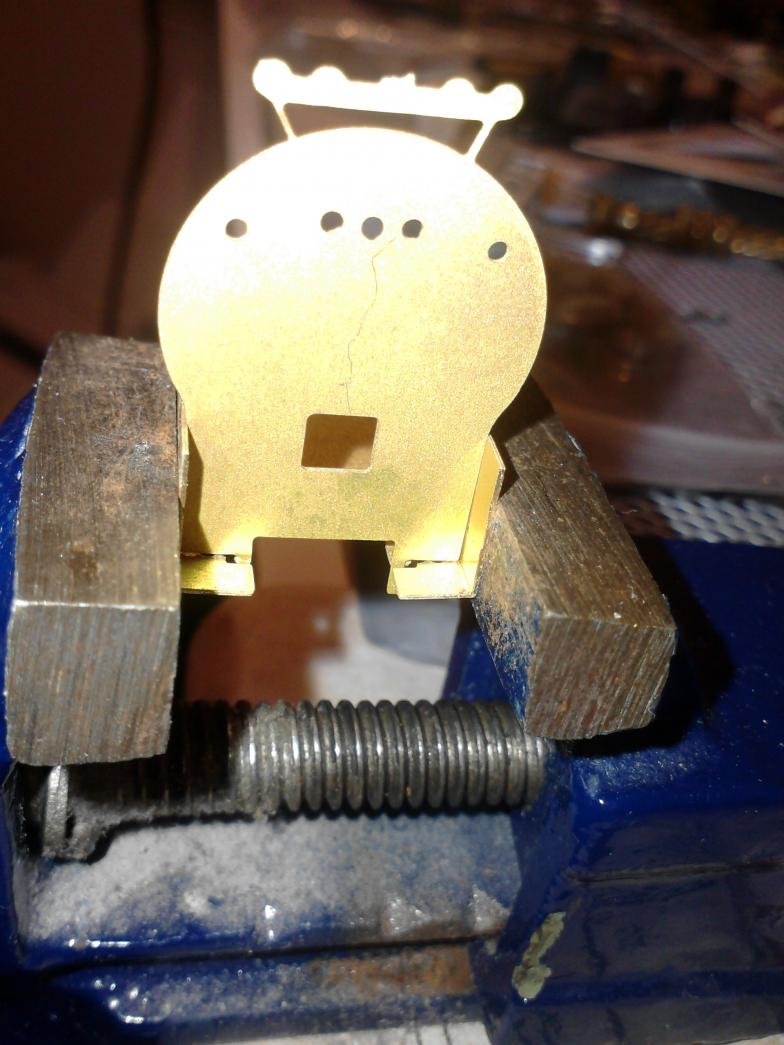

When dealing with something like this, hold it in a small vice and always try to solder it in from the rear, so that you don't risk obliterating the etched detail:
The first attempt left a bit of a gap under the backhead, as will be apparent from the photo, so some fiddling with the iron was needed before it was properly seated. The backhead must sit at a perfect 90-degree right-angle to the cab floor, otherwise there is a risk that adjacent parts may not fit correctly.

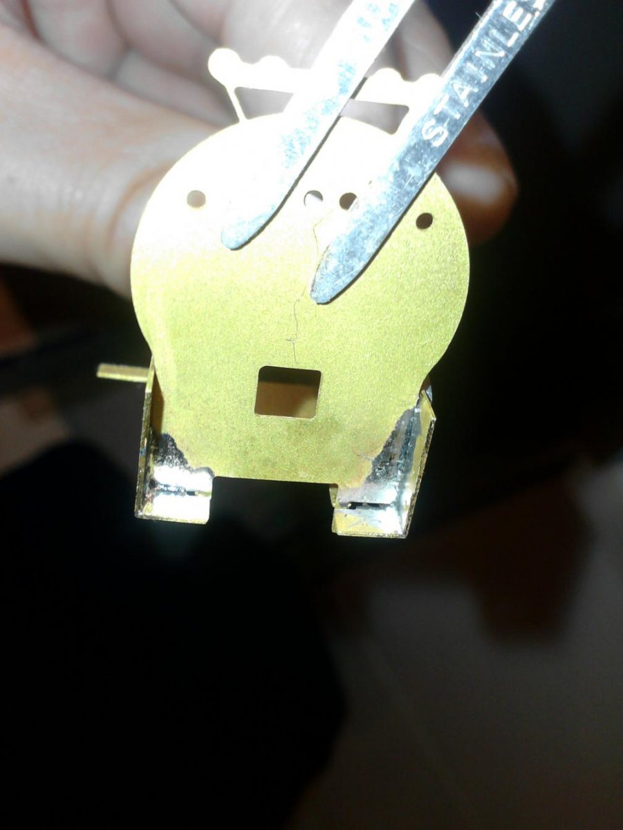

Next part to come off the fret is P51, described in the sheet as a "platform upright":
This is a simple plate with small wings to be bent 90 degrees:
You have to mount it underneath and at the very rear of the cab floor, and only hairgrips will make it stay there whilst you get your soldering iron in:
Use your tack-soldering method to keep it in position:
...before flowing and finishing the joint. I think I used a bit too much solder in this one:

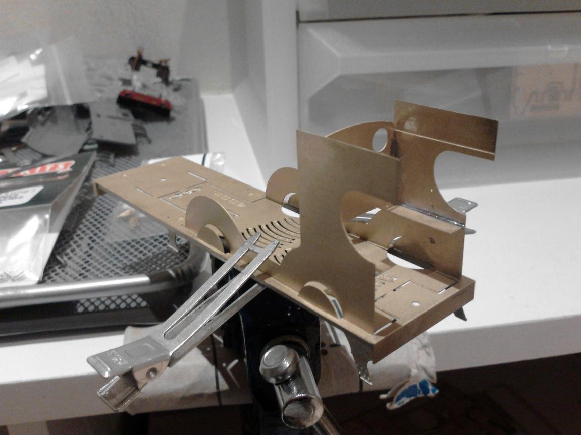

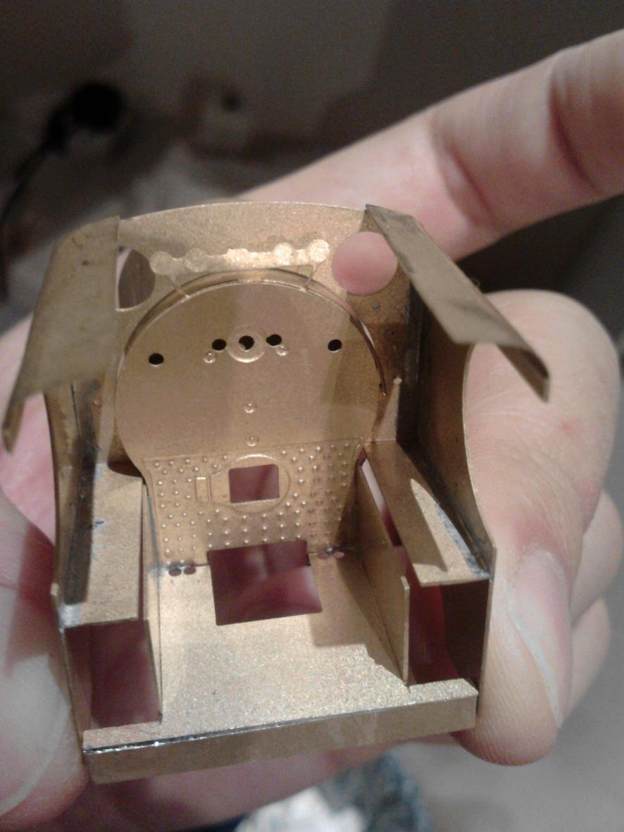

Test fitting the cab floor/backhead module between the cab sides now gives us this:
The instruction diagram suggests that there should be no gaps between the vertical sides of the trailing splashers and the horizontal plates which now form their tops. In reality, there are noticeable gaps as can be seen, so these flaws will need some correction. Whilst I was thinking about how to deal with that, I couldn't resist sliding the firebox (which comes ready-rolled) into the cab front (there will be an overlay to be added later), just to see how it looked......

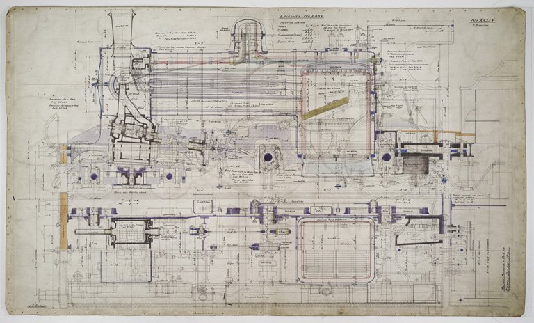

My apologies to everyone who's been waiting patiently for things to progress on 171.
I've been experiencing a frustrating year trying to track down drawings, photos and information about no.171's inside motion and leading driving cranks. I finally had a reply from the RPSI and its Locomotive Officer about a month ago, after offering a donation to 171's Overhaul Fund, but it all seems to have gone dead again. I know that the RPSI are constantly busy, and even more so with "Q" class no.131 potentially coming to life next year, but I do sometimes wonder whether they tend to leave honest enquiries hanging in the air. 'tis difficult not to feel neglected.
Working inside motion was always going to be something I wanted to install in my model of no.171; it is visible between the frames and - in 21mm gauge, at least - there is plenty of room to fit it in.
However, it turns out that, being originally built by Beyer Peacock & Co., "S" class drawings are held in the archives of the Manchester Museum of Science and Industry. I discovered this by pure accident when a small JPEG image popped up during a Google search. Following the link took me to MMSI, and a larger image which is clearly the "S" class engineering drawing. Praise the Lord, it is a cross-sectional view and even shows the inside motion and cranks in some detail.
One thing that was also clarified was that the frame outlines of the SSM kit are very close to the original drawing - previously I had thought the kit frames were weak - so a lot of care will be needed to install the mounts for the sprung suspension.
I am now going to have to invest at least fifty quid in an A0-size working copy, supplied by the Museum - assuming of course that they can scan one...... That's almost as much as I paid for the kit!! :((
