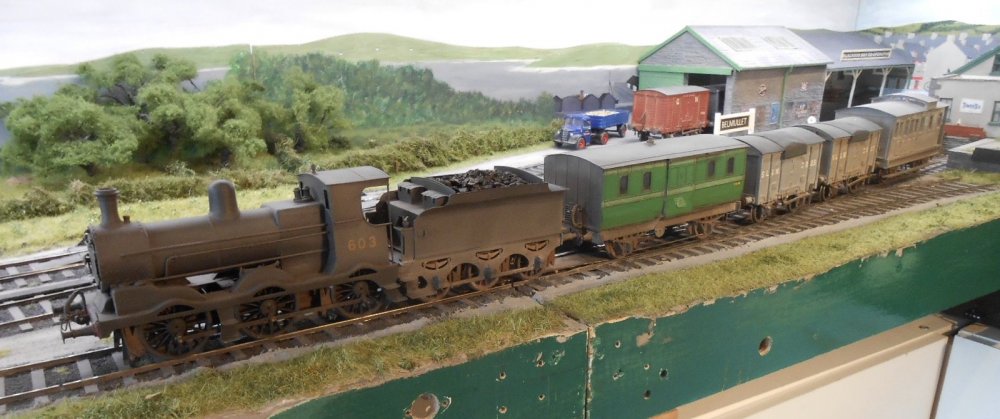

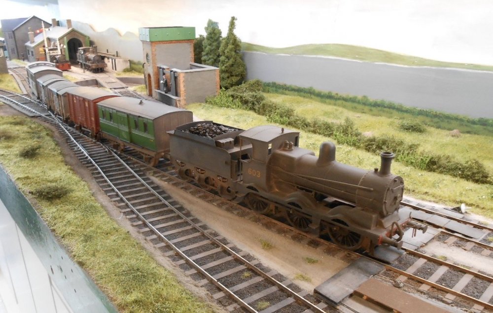

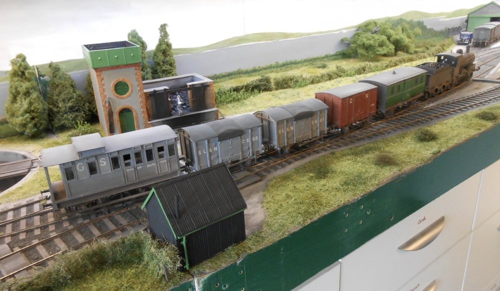

 When I started the J19 back at the end of May, it was always with the aim of giving it a train to haul. Hence, the addition of the MGWR 'hearse' van [for fish] and the glasshouse brake to offer limited passenger accommodation. The ensemble will be completed with three 'semis', which are the next project, but for now train is made up with a couple of Sligo and one GNRI van.
 At the moment, while the J19 has a Dingham hook coupling, the other vehicles have three links. Ideally, would like use Dinghams on the rest, but have yet to sort out how to make the sequence work. The problem is that Dinghams are handed, with a hook at one end and a loop at the other. Because the whole train is turned in the fiddle yard and the loco is turned on the turntable, am not sure if Dinghams are possible - hence three links for now.

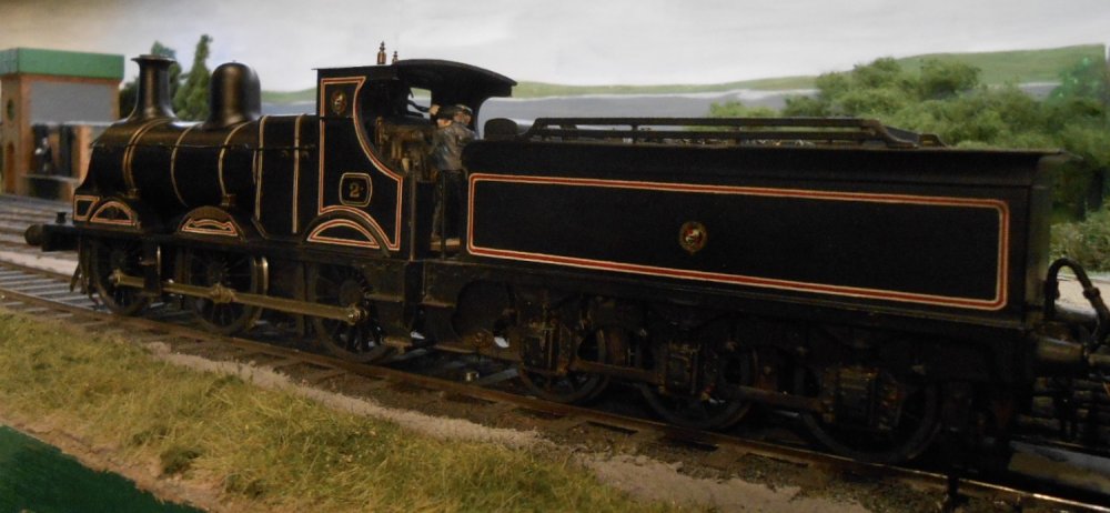

 Not quite the 7.20 from Enniskillen, as it would have been very dark by the time it got to Belmullet. However, will try to show Sir Henry with SLNCR bogie brake number nine and a couple of wagons. First though, while I was cleaning Henry's wheels, took the opportunity to show the inside motion in action. It is a kit of castings from Laurie Griffin. Not cheap [nearly £100!], but a joy to put together and certainly fills the space below what is quite a high pitched boiler.

 Everything is scratch built. Sir Henry a near 200 hour labour of love in nickel silver. The coach is plasticard on cut down Slater's bogies and the wagons likewise plastic and micro strip.

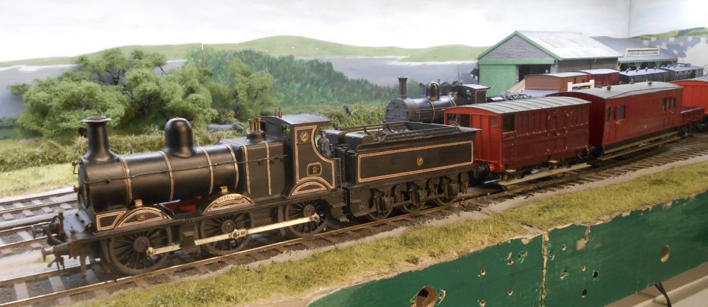

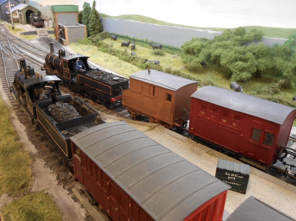

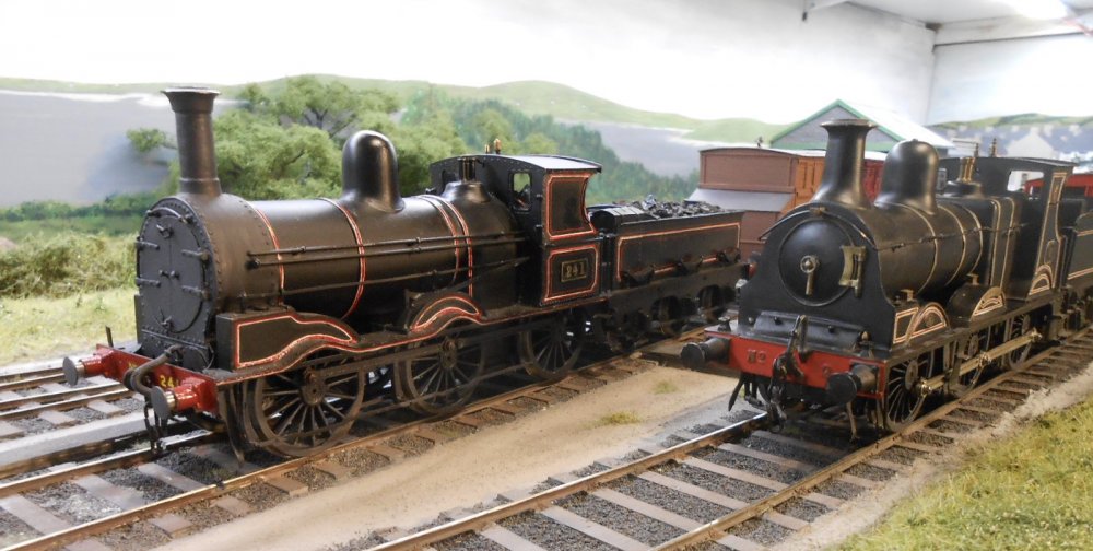

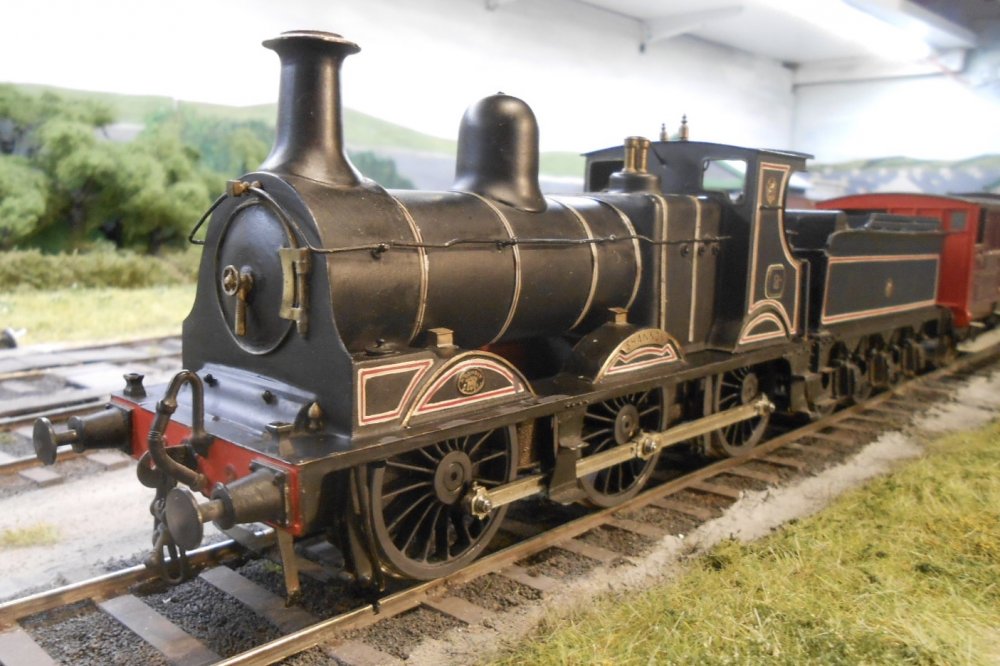

Back to the 1900s

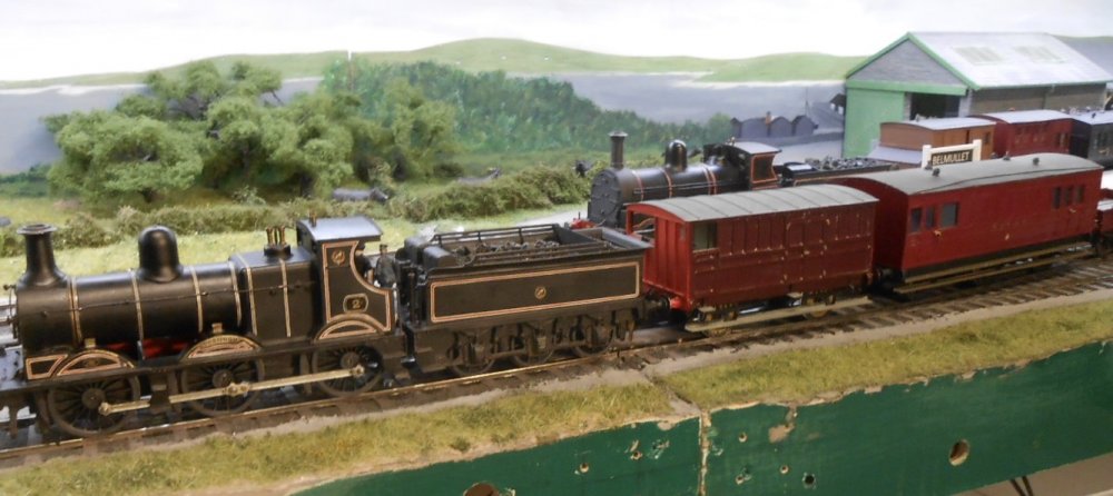

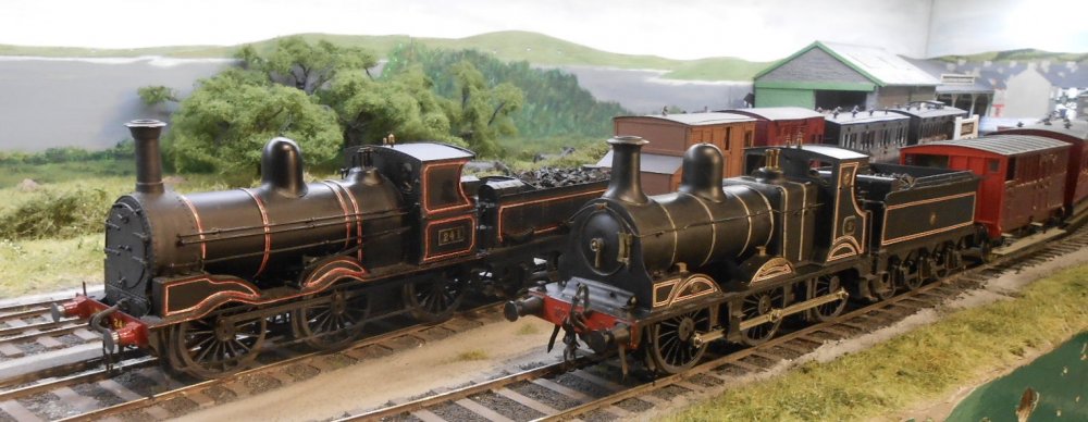

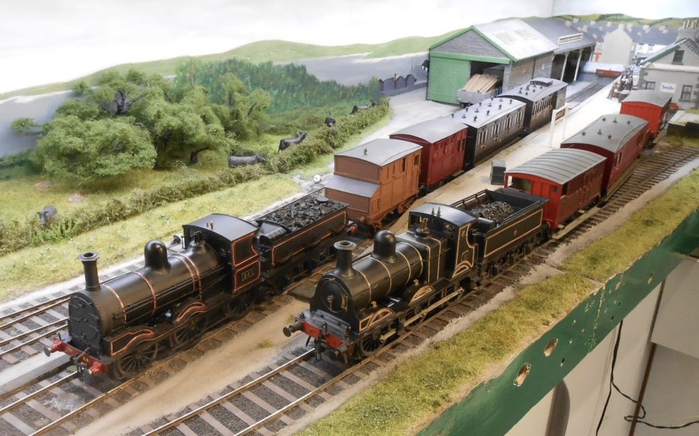

 Recent work on the GSWR Brake 3rd, plus new wheels for WL&WR 0-6-0 Shannon have all been about moving Belmullet backwards about 50 years to the early 1900s. A few liberties are being taken, because my 101 0-6-0, being a later Coey engine, wasn't built until 1903, while the WL&WR had already been taken over/absorbed by the GSWR by then. However, it always took time for locos and stock to be repainted, so hopefully what I'm doing isn't too outrageous, although a railway to Belmullet never existed anyway of course.
 Anyway, Shannon now has its new wheels and the bodywork has been given a further bit of TLC, touching up paint chips here and there, plus a bit more work with T-cut to freshen up the rest. Still needs balance weights to be added to the wheels, while have just noticed one of the handrails need straightening - is any model ever really finished? However, was keen to pose and operate the two new trains to herald the move back in time.
 Shannon's train is very much a nod to creator Richard Chown, being what he called a 'Mail Goods'. This featured on his Castle Rackrent system and as well as Shannon, I also have his two Dublin and Meath brake vans. Quite why he built even one of these is anybody's guess, but he was often drawn to obscure prototypes and with their salmon pink ends, these vans are certainly that. The rest of the train comprises my own scratchbuilt models of a WL&WR full brake, plus a carriage truck from the same company. On Castle Rackrent, photos show a carriage truck on the Mail Goods, sporting what looks like a horse drawn pantechnicon - there's a word for you! These days we call it a removal van. My fiddle yard is 43 inches long, but Shannon's train is only 39 inches - hence not enough room for another wagon. The WL&WR did have a couple of six wheel carriage trucks, but at just over 9 inches long, there is not enough room for one of these. At the moment anyway!
 The 101's train has previously been described as a private excursion, though with a six wheel first, brake third and two horse boxes, probably works as an ordinary service train too. However, 101 0-6-0s rarely ventured this far north or west, so a 'special' probably makes more sense.
 The two trains are shown with Shannon waiting in the bay, ready to depart east, then south for Limerick with mail and parcels, while the 101 leaves first for [eventually] Dublin or Cork. Suspect the coaches will be added to another train somewhere further on.
