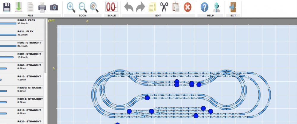

  1. a test layout of the 14ft x 4 ft plan The ultimate master plan, sort of modelled on Noch's Heidleberg The idea in this 14ft x 4 ft is to have two main levels, the inner 1st and 2nd radius on the higher level The outer2 tracks at the lower level for 2nd and 3rd radius The carving of the landscape to have hills and troughs is to make it interesting. Should just take another 20 years
