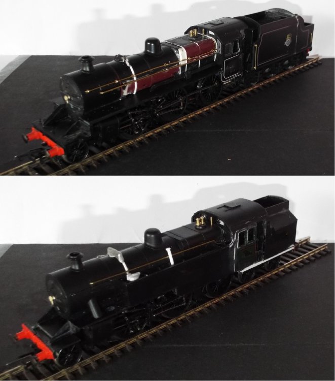

Both my Mogul and Jeep have now been test run on the Club layout and now await the acquisition of the correct lining, number (and name) plates and final detailing.

A few things to snag. Footsteps, some under the running plate details on the Jeep and a correct chimney. The tender on the Mogul needs a bit more work.

Progress. Running board and tank bottom reprofiled, front end rebuilt, basic structure for bunker assembled.
Preliminary work on the Fowler 2-6-4 body to create a Jeep. Bunker cut down and cabside cut away. Cabside from scrap Hornby Princess Coronation body inserted to create side window cab. The cab was an after effect of the creation of 46202 Princess Anne by combining Princess Royal and Coronation parts. There is quite a lot of further work involved. The rear end and bunker have to be constructed and the front end needs altering - the open arrangement needs the front 'wings' lowering and the centre portion cutting back to show a raised portion. Top feed needs adding and chimney changing for a Stanier one. The lower edge of the tanks needs reprofiling. In the end a reasonable result should be possible.
