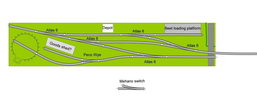

The station island is a necessity for it to be the South Wexford line, as every stop was configured identically. Come hell or high water, I will make it fit. But I don't foresee it being an issue, as the actual station buildings were small. These are placeholders (the Atlas signal box at the end of the island I actually own already, so the dimensions won't change too much as I just intend to kitbash it). The footbridge seems silly, but it gives it a certain charm that I'd like to keep. I do like the idea of replacing the wye with two tracks though. If it doesn't perform well, I may do that.

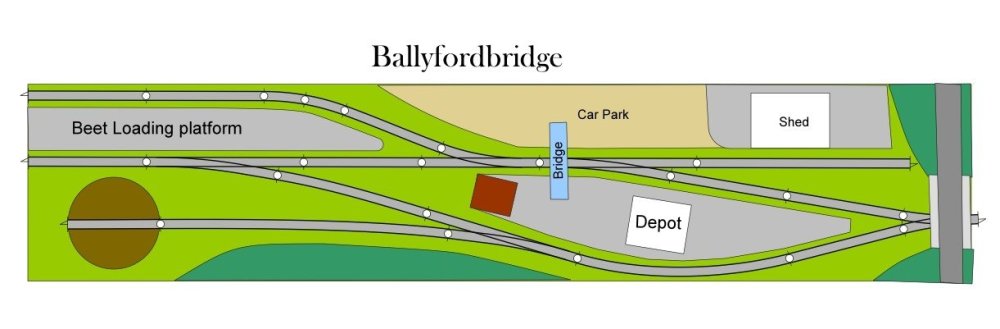

I've been obsessed the past few days with the South Wexford line. There's surprisingly little in the way of photos and videos I could find of it from the time period I'm looking at, but I think I've managed to piece together something resembling a station that might be found on the line. Behold, Ballyfordbridge! Less swoopy, more track, more prototypical (minus the added turntable, which near as I can tell would've only existed at Rosslare Harbour). This should also look better when a passenger train pulls up, although that's a ways off.

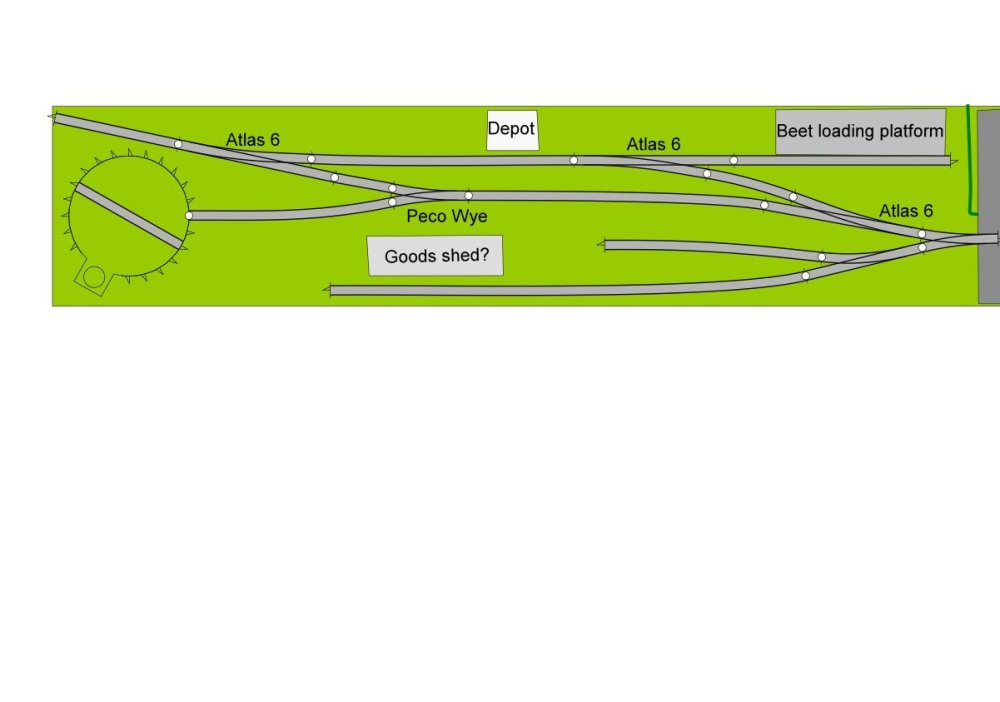

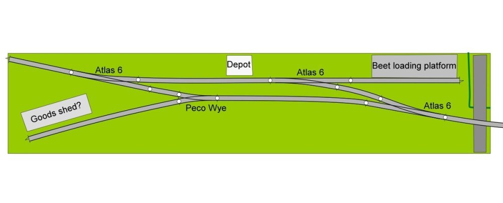

Interestingly, not only is track more curving and flowing than I might think, it appears that I may have inadvertently recreated any number of stops along the GS&WR line from Waterford to Rosslare Harbor. It never occurred to me that island stations were a thing, but I then happened upon Ballycullane, which was obviously an island. Unfortunately, there don't appear to be any photos of Ballycullane during the period I am looking at, although the Eiretrains page does describe it having a goods yard. Looking down the line I found several others. Wellingtonbridge would appear to be almost exactly what I'm trying to accomplish, albeit on a larger scale: http://eiretrains.com/Photo_Gallery/Railway Stations W/Wellingtonbridge/IrishRailwayStations.html# This discovery is helpful. I have setup the bulk of the last plan on the board with thumbtacks (no pictures until I clean the basement), and while the wye looks okay in Anyrail, it's a bit of an eyesore in person. Trains move along a gently flowing curve, only to hit a sharp kink that is the wye. Not particularly graceful, but possibly something I could live with. Nevertheless, I will probably work on a couple variations that more closely resemble Wellingtonbridge or Bridgetown by ditching the wye, pulling everything forward and sticking a parallel siding in the back to move the beet loading to (and the goods shed). Possibly. At any rate, the depot is going in the center of the runaround.

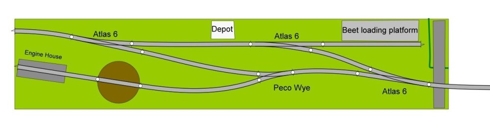

Why not both? Looking at the physical board and pictures of the Atlas turntable, I don't believe Anyrail when it says that I can fit that turntable so this is a custom 8" job. Headshunt has also been curved to allow for future expansion of the layout should I desire to do so. You make excellent points, as usual. I think I need to lean more towards the scenic/art side of things. After all, I've had a fascination with curving, flowing lines that are almost certainly unprototypical (ignoring the common wisdom that you can find a prototype for literally anything). I had a moment today to run to the local hobby shop and pick up the third Atlas switch. Unfortunately, they did not have any used so wound up with a brand new one. Fortunately, they (very very surprisingly) had Kadee 19's for the NEM sockets in the 121.
I think I may have come up with something I like. It requires one more Atlas #6, but feels balanced and keeps that curvy, flowing look to it. It also is essentially Shelfie 2 while keeping everything in-scene. The third one has too much empty space for my liking. I like the idea of using the turntable as the headshunt except that in my mind this is a station on a continuous line. So, while that's a headshunt in reality, in my fictional universe that's the continuation of the rail line.

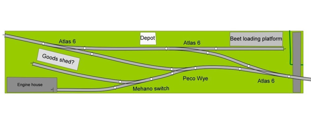

Thank you. I think that's what I like about the Shelfie 2 layout and dislike about the stuff I came up with tonight: elegance (or lack of in the case of my examples). I just need to find the right balance of elegance and play value. I'm sure for someone the inglenook works, but not for me. I've tried twice now. I think it's too reliant on the game aspect holding your attention, but once you figure out that you just need to build the new train in reverse the game stops doing that. At that point it's just a loco moving a foot back and a foot forth sorting boxcars for eternity. I will keep those guys in mind!

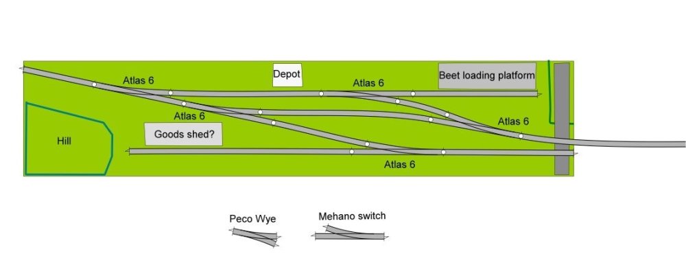

These are excellent points. I hadn't given the fact that the train will be "off-stage" for that siding any thought. I am having trouble with the visual of flipping it around though, as it always seems to make the layout look unbalanced. I will definitely check out your plan. I've made several variations tonight, most of them insane. None I particularly like. I think I do prefer replacing the Mehano with the additional Atlas switch though, so that'll likely stay. Fairly certain my local hobby shop has a box of used Atlas #6s as they are popular, so I can get them cheap.
Hello all, A while back I started a 6' x 15" shelf layout based on an inglenook plan published in Model Railroader. I found it pretty boring (both the operation and the scenery/backstory) and didn't get far. I began looking at alternatives and stumbled upon Paul Marshal-Potter's Shelfie 2: https://albionyard.com/2018/03/05/motivation-monday-shelfie2-progression/ It appeals to me for two reasons: I've always wanted to model a prototype outside of North America It allows the locomotive to travel the full length of the board and take a different route via a runaround, whereas the inglenook only allows the locomotive to travel back and forth a few feet While Shelfie 2 is set in an rural English colliery, I happened to find (and order) the American oddity known as the Class 121 so I will be modelling Ireland (the word 'modelling' being applied fairly loosely) in the 1960s or 70s (it's the grey livery). I'd specifically like to go for a small station scene with a loading area for beets. I have three main criteria: Use my existing benchwork Attempt to use track I already possess (mostly) Provide space for my American rolling stock (until I can afford a bunch of kits, beets will be transported in 2-bay coal hoppers and other goods in 40' boxcars) Attached is what I've come up with so far. Track is all Code 100 HO flex track from Peco, except where noted. I have eliminated the additional siding present on Shelfie 2 primarily because I wasn't quite sure how to elegantly add it in, but my layout is also narrower and may look more crowded with it. Given my choice of locomotive, I did consider adding a 9" turntable in place of the hill on the left, but that might be a bit much for this space. Then again, it may add more play value. Thoughts? Advice? Insults? Is there something in a similar vein but more appropriate for the place and time?
