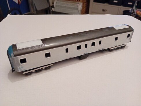

  1. Good evening. I am building a new item of stock, namely a Mk2 generator car. The method is a slightly refined version of the one I used for the FO. The main difference is keeping the body intact above the windows rather than removing it and replacing it with plasticard. This is better as it helps to keep the body in shape. The base model is a Lima FK.

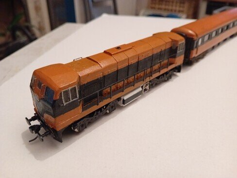

  2. Good evening I have spent a rainy Sunday carrying on with the class 141. It is almost complete, with only the front cab numbers to add, which will be followed by some matt varnish spray. The decals are home made. The exhaust grill is a simple photo print which I will replace if I think of a better way of doing it. It is in mid 1970s to early 1980s condition with tablet catchers.

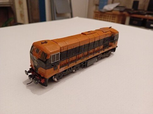

  3. The master was built up with layers of plasticard built on a basic box. There were overlays cut on my Silhouette computer cutter to deal with cab windows etc. The curves were created by eye using flat needle files, plastic filler and fine wet and dry. In other words, sculpting with some trial and error until it looked right.
  4. Hi. During a quiet Sunday at home, I have done more work to the class 141. I have added buffers, couplings, the fuel tanks and footsteps. The assembly is complete. I just need to add a few details, such as the roof grill and horns and finish the painting and add decals.
