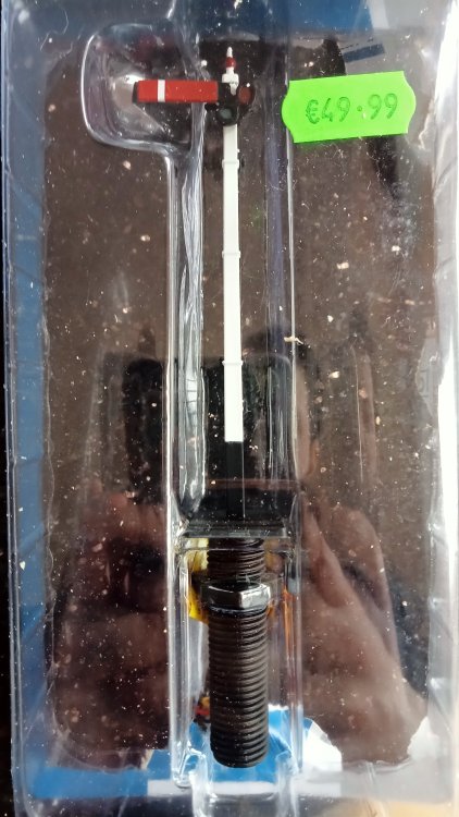

I've gotten a lower quadrant semaphore signal from dapol it's really good and looks the part there is definitely differnces to the one at Dundrum station but it's very minor differences in my opinion. It's a GWR one so it's lower quadrant which is ideal for my layout. Only difference is that the GWR one has ladder and a stand at the top the one at Dundrum doesn't have ladder from the picture I see. And few other things different but again it's very minor. I feel it captures what I want. It's motorised also and that is handy. Not too difficult to install

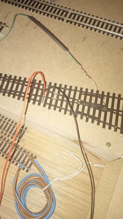

I wired up the electro frogs and will test them. I hadn't soldered points till today so I think I've done okay so far. if there is tips to my wiring here im all ears. i have the isolating rail joiners on them too.

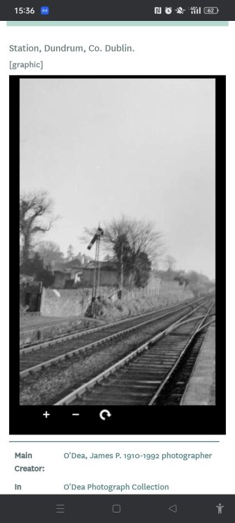

loving the layout is it based on anywhere particular
This is the tracks at Dundrum it's more less seeing what it looks like. Next stage drill holes for wires. I don't want to put anything down permanently yet till I see how it curves into the part of the layout. I am using pictures of dundrum is what I'm basing this on. The platform won't be as big as it was in real life but I will still have all the detail it had on the platforms. i will have 4 point motors in that area. the small siding that was at dundrum im not exactly sure what it was used for i think maybe a extra engine to be put there on a busy day or maybe a cattle stop or something like that. if any information comes up about the siding there i will try find it if i can. https://catalogue.nli.ie/Record/vtls000303664 thats what im using to help me with getting what you see here to look as it did in real life.

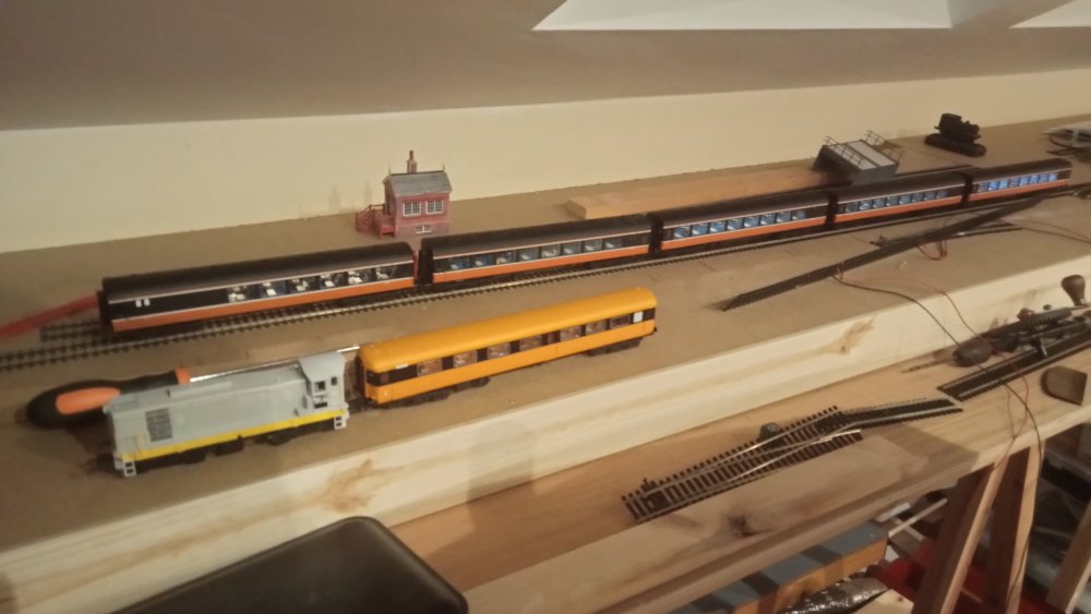

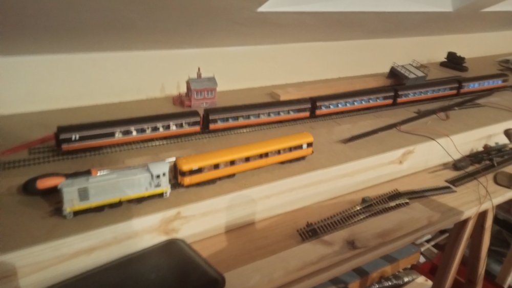

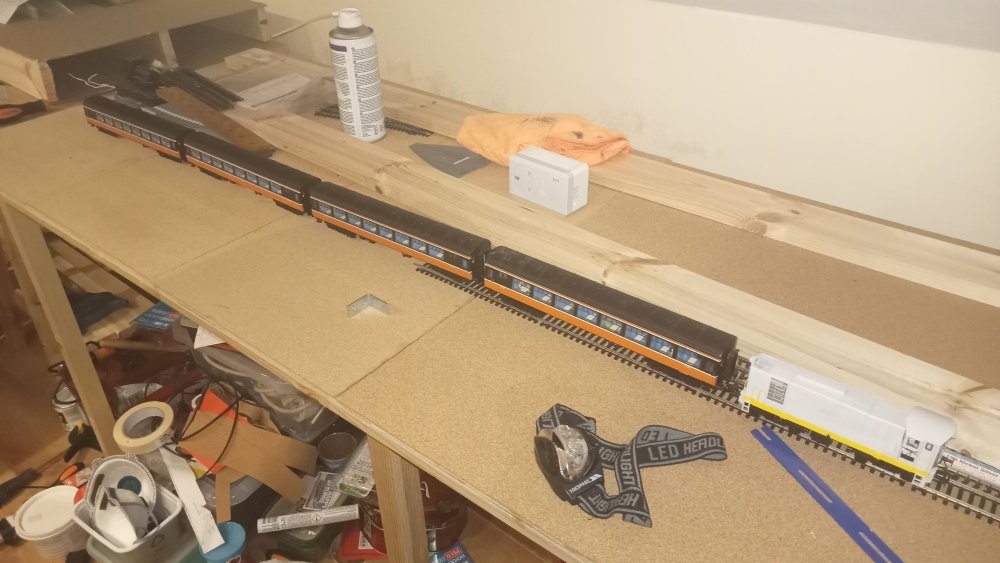

That's some my cravens I have at the moment all I need is a van will be a regular on the layout once completed. I do have a snack cravens coach I will be getting park royals from irm too which will go nicely with this set. It was common for cravens and park royals to work together especially with rpsi in the 2000s on the Santa tours.

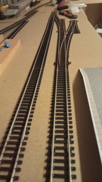

first part of layout been made is dundrum station so that is what im working on. doing it one section at a time. im gonna be using lot of jim odea collection photos to help me visualise how it will look and its size. there is very small siding there too. will be putting cantinarys on the layout too so to represent a what if it survived and never closed and became a dart line. so rolling stock im going for is range of stuff really wanna represent what was on the line but also what potentially may been on it like cravens and mk 2 bs and so on. i will be adding also signal point rodding to make it look realisic that comes later of course. see in the picture there is siding there. gonna also try do the old bridge at dundrum not sure what i will use to make it maybe plasic kit bashed or make it from hand with like brass or something like that. gonna use some picures here of what it look like today probably i thought will help visualise it Holdings_ View of the tracks, Dundrum, Co. Dublin_.pdf Holdings_ Station, Dundrum, Co. Dublin_.pdf
