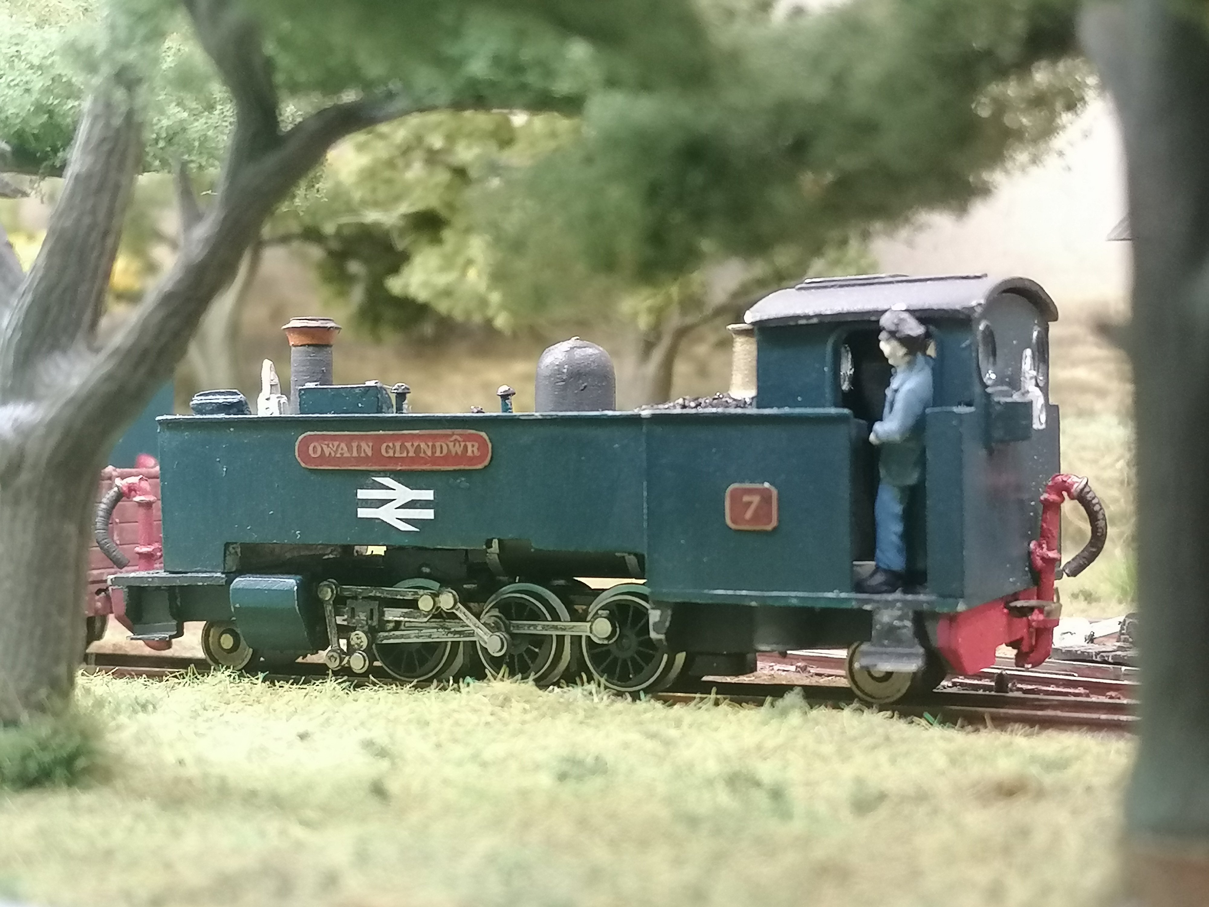

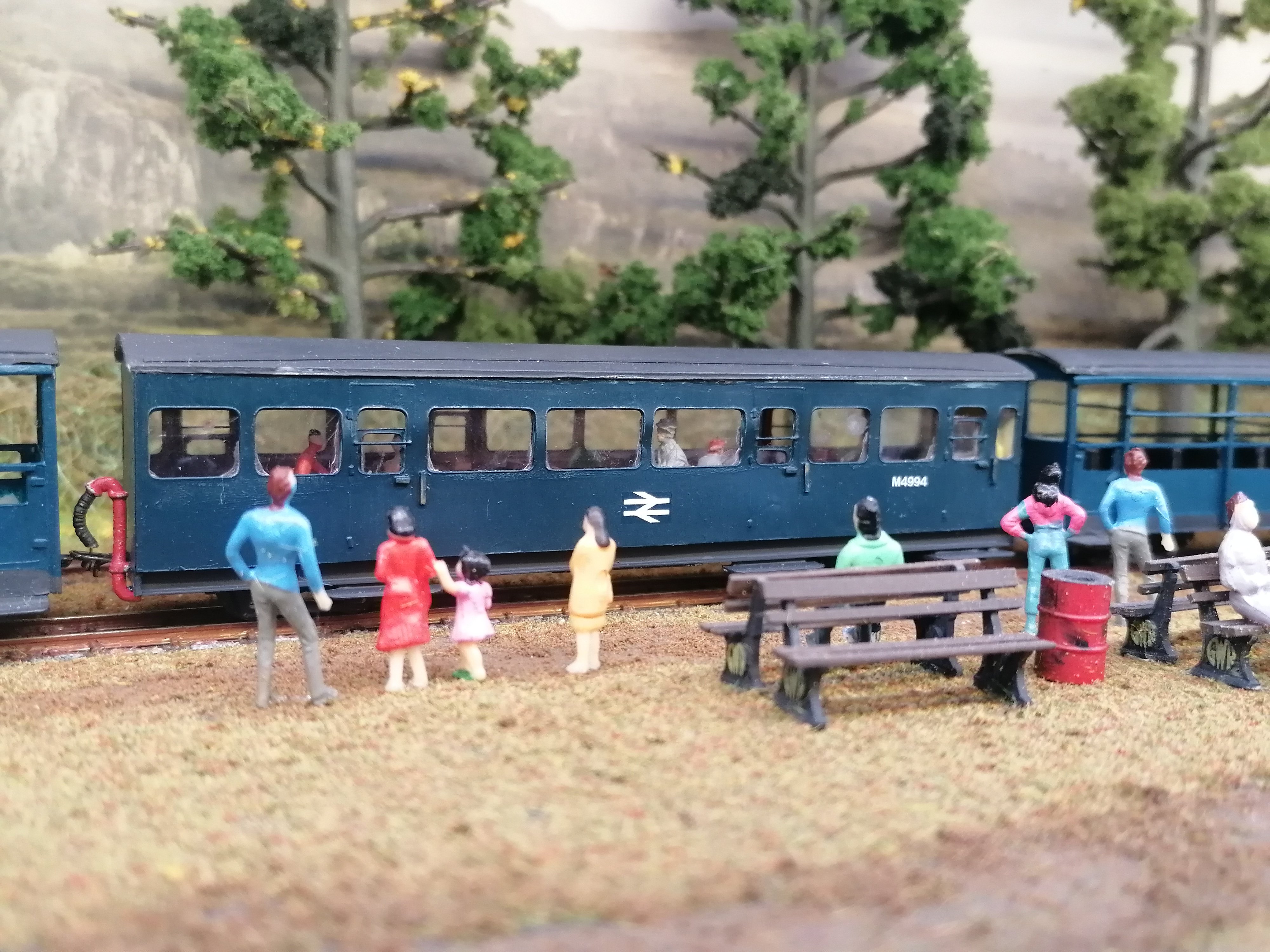

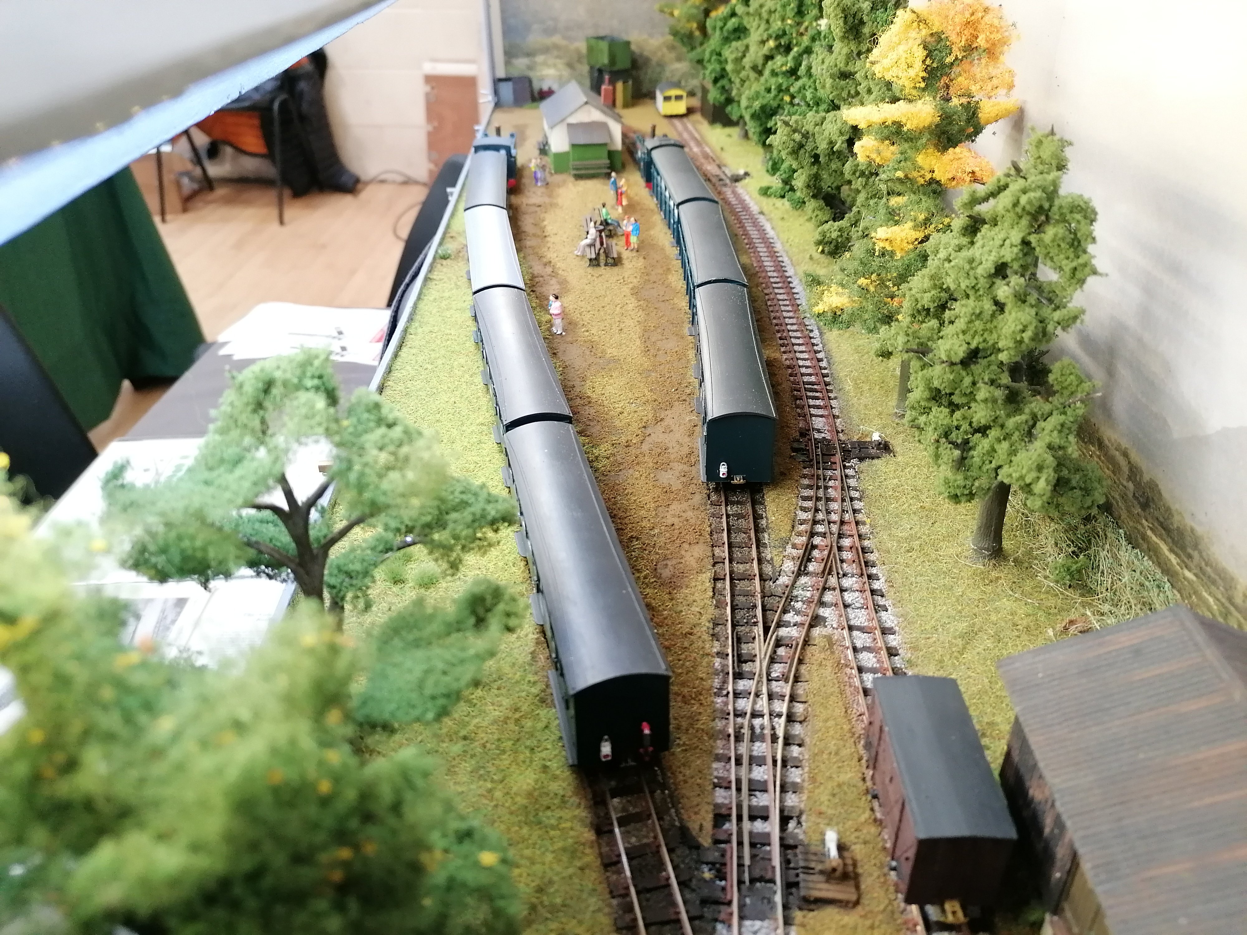

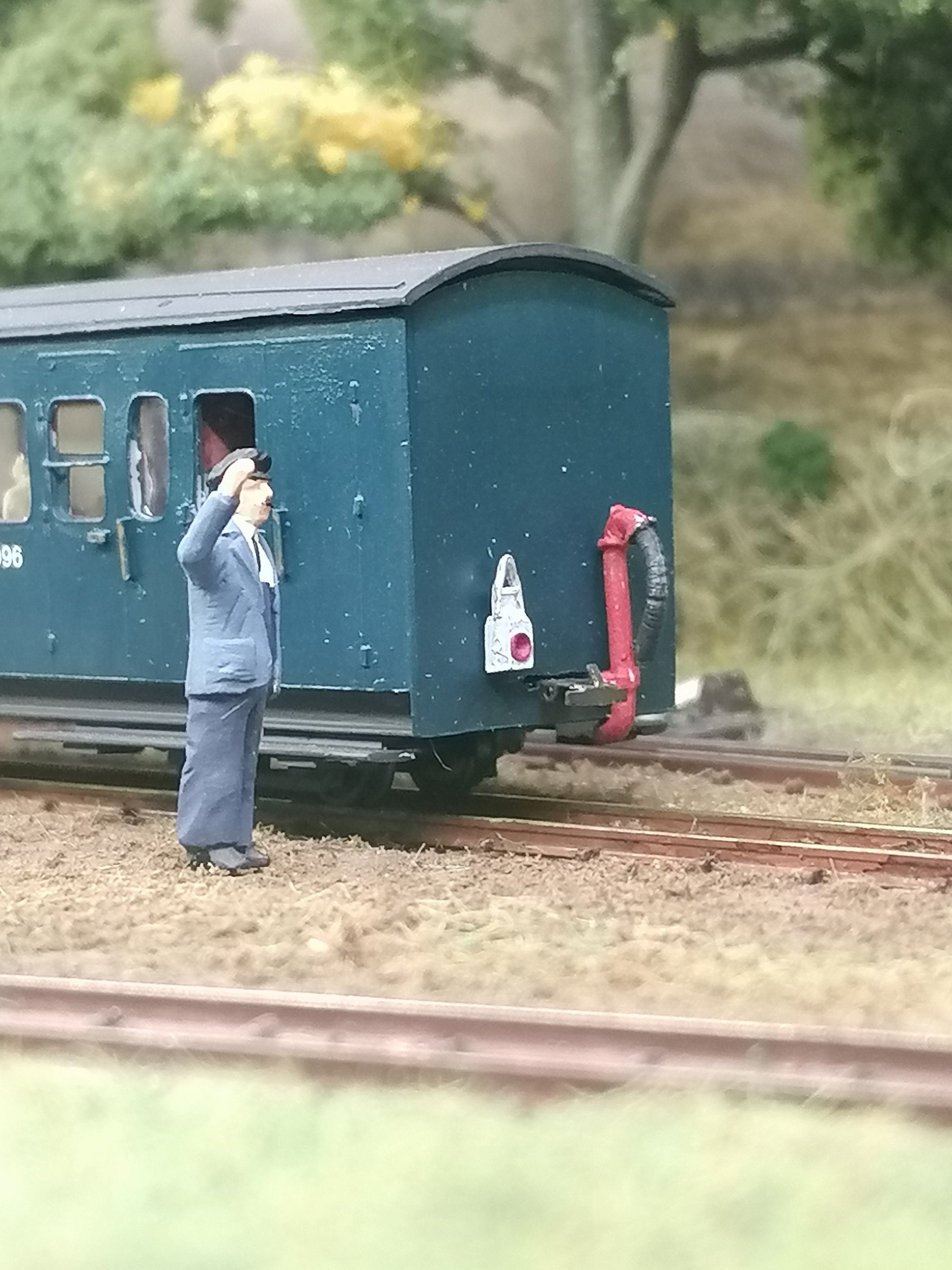

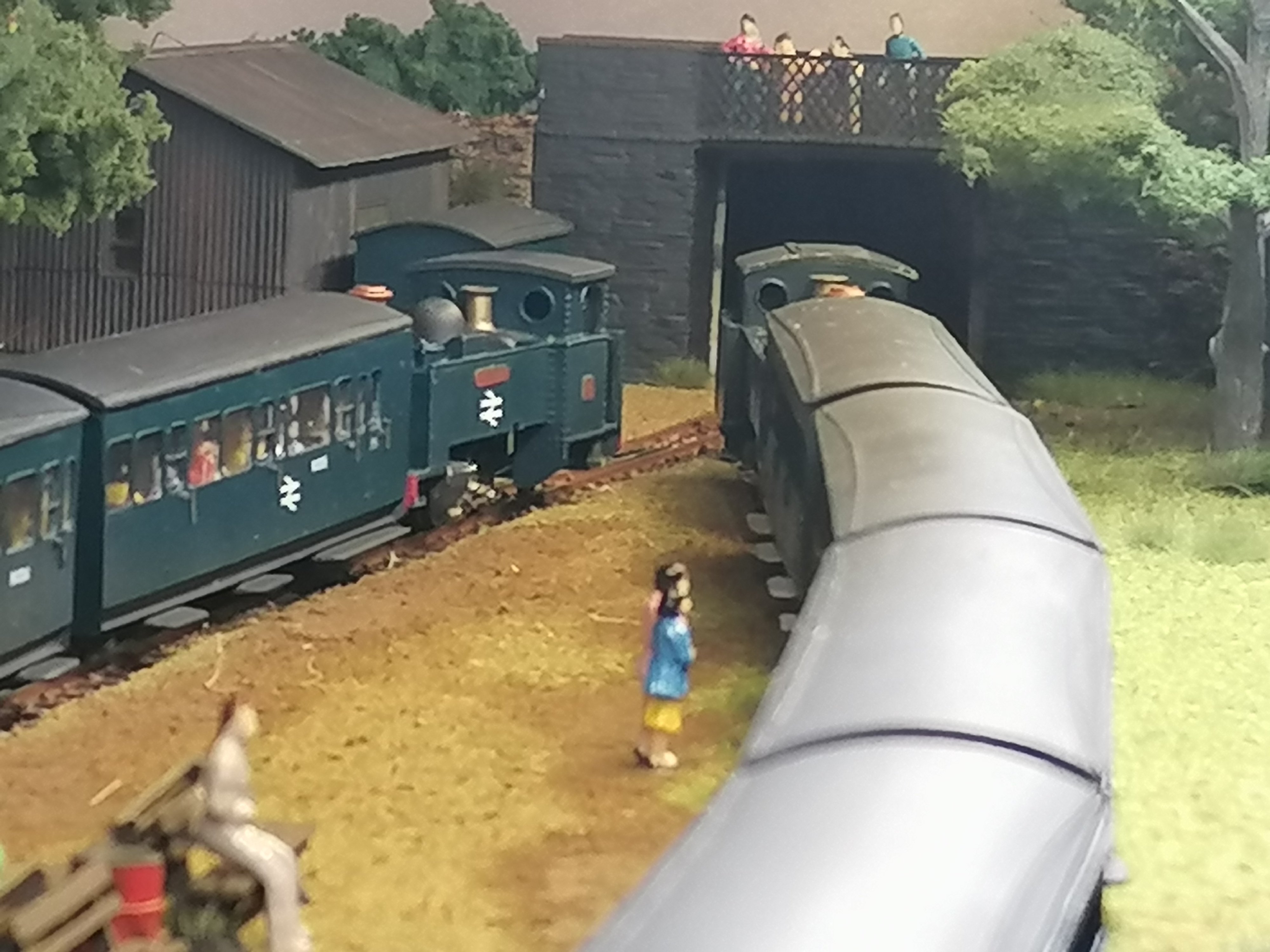

  3. Another of my micro layouts using the Ikea Lack 110cm x 26cm shelf as it's baseboard, Mynydd y Ddraig (Dragon Mountain) is a compressed version of Devil's Bridge, the upper terminus of the Vale of Rheidol line ans set in early BR blue days, 1970-75. Peco 009 track, kitbashed, scratchbuilt and 3D-printed structures, Woodland Scenic trees. Locos are kit/3D bodies on ancient Minitrix N mechanisms, coaching stock is all scratchbuilt using a Silhouette cutter to mass-produce the sides. Having made all the stock, the next plan is to make the Aberystwyth end of the VoR in similar micro form.

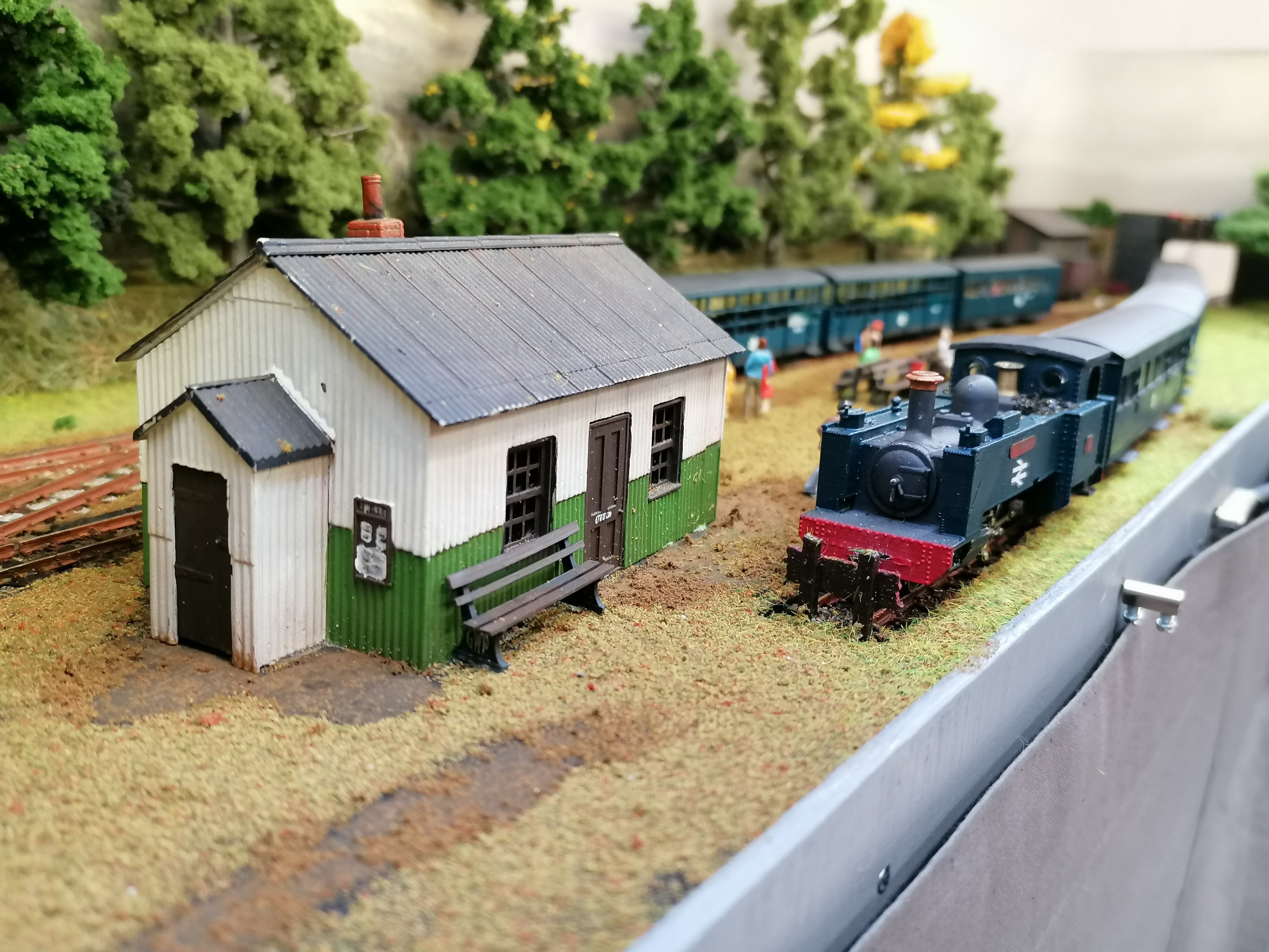

  4. A few years ago I constructed a small terminus based loosely on Wick/Thurso in H0 scale. Set c1970 in the BR green/blue transition era. Baseboard is an Ikea Lack 110cm x 26cm shelf with a thin ply display box surround. Peco code 75 track, structures all scratchbuilt using a lot od Slaters embossed sheet and plasticard. Locos are 3D prints from Lincoln Locos on modded Roco mechanisms, stock is reworked ancient Lima, Fleischmann and Rivarossi rtr, plus some scratchbuilds. Featured in the March 2025 Railway Modeller, Dounreay has been exhibited around a dozen times so far. The choice of H0 scale was deliberate to encourage/force myself to do more modelling!
