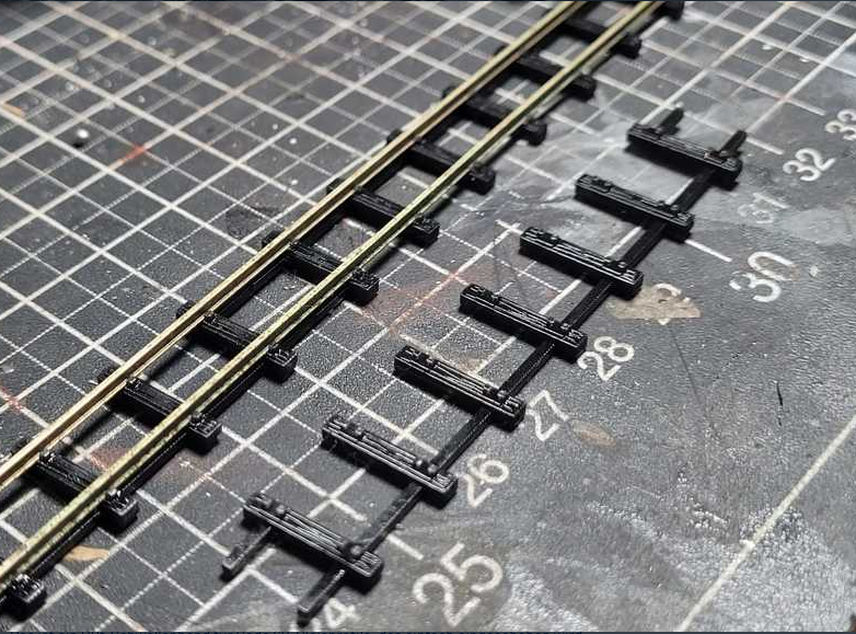

  3. IMG_2974.mp4 First run of the Ruston and first run on home made track!
