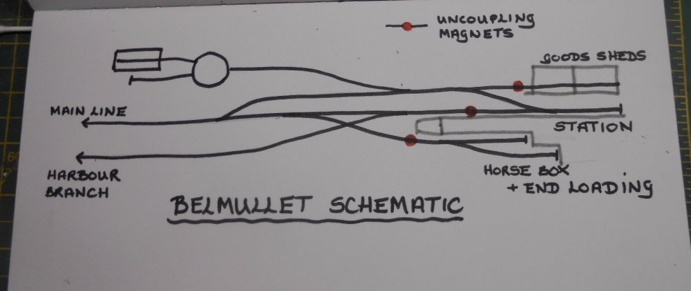

For those of you who like such things, here is a shunting puzzle I have been trying to solve, but without success. Most trains on Belmullet can be operated with Dingham auto couplings and just three strategically placed magnets. Dinghams are 'handed' though, which doesn't work well when both whole trains and locos are turned at each end. However, by having hooks on the locos and loops on the end of the first and last wagon/coach of each train, not only is basic running round achievable 'hands free' but two trains can swap wagons as can a rake of wagons in the goods shed be exchanged with an incoming set.
The difficulty arrives with two trains [one for each period modelled], where I want to swap a single wagon from a 'mixed' train with one from either the the bay or end loading dock. At the moment, these trains have either screw or three link couplings, which need to be worked by hand. My question is, could the sequence be done using Dinghams and the magnets?
Each train is made up of the locomotive [which will be turned on the turntable], one or two passenger vehicles, a couple of wagons and a brake van bringing up the rear. On arriving in the platform, the loco needs to uncouple and be turned on the turntable. Afterwards, the brake van needs to go to the other end of the train and one of the wagons swapped with one from the bay/loading dock. On return to the fiddle yard, the whole train is turned for the next outing.
Note that Dinghams have to be either a hook or loop - you cannot have a hook and loop on both vehicles coupling up as they don't work reliably. Everything I've tried thus far ends up with a mismatch when the whole train is turned and returns the next time. Indeed, am not sure anything IS possible, though one thing that might help is that a pilot loco can be available, though note that locos can only be isolated in the loco shed area, either side of the turntable [ie room for three locos].
A schematic is shown below and additional magnets could be added. No prizes for success, but you would have my eternal gratitude!
