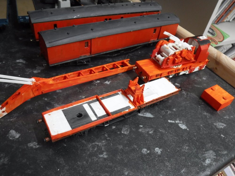

I've been busy with transfers and painting the underframes and bogies. The transfers have been coated with Johnson's Pledge to seal them in place and the bogies and underframes have been painted with Humbrol 85 satin black.
I have ordered some oval buffers that will be fitted along with buckeye rubbing plates and couplings.
One underframe painted, one to do.
Diagram 130 end loading car flat with removable sides.
Diagram 131 end loading car flat
Half of the ten car flats that I've built so far.

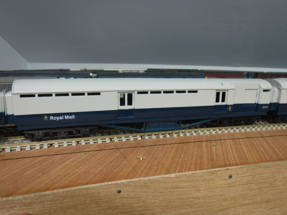

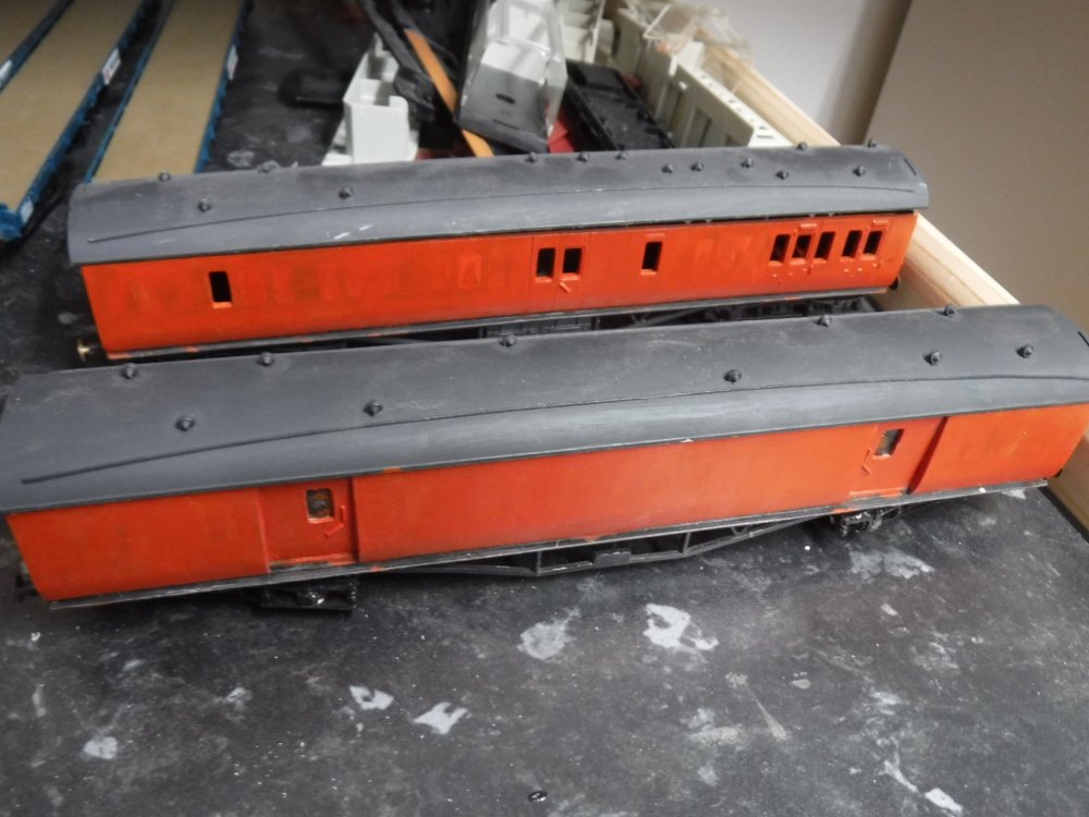

The postal vans have had lettering and emblems applied to all ten of them. I did have some old Replica white lining transfers however the sheets were several years old and seem to have become embrittled over time, when I attempted to use them the lining broke into lots of small pieces. I have ordered more form Railtec which ought to arrive soon enough.
POT 30279, a stowage van with net recess from diagram 2176. This van did not have sorting racks being entirely unfitted inside and was the only one of its kind. Interestingly there was a POS diagram 2185 of which three were built in 1954 that had no provision for nets but were fitted out with sorting racks a lavatory and a wardrobe, they were numbered 30300/1/2. I shall run these two types of van next to each other in the formation once completed.

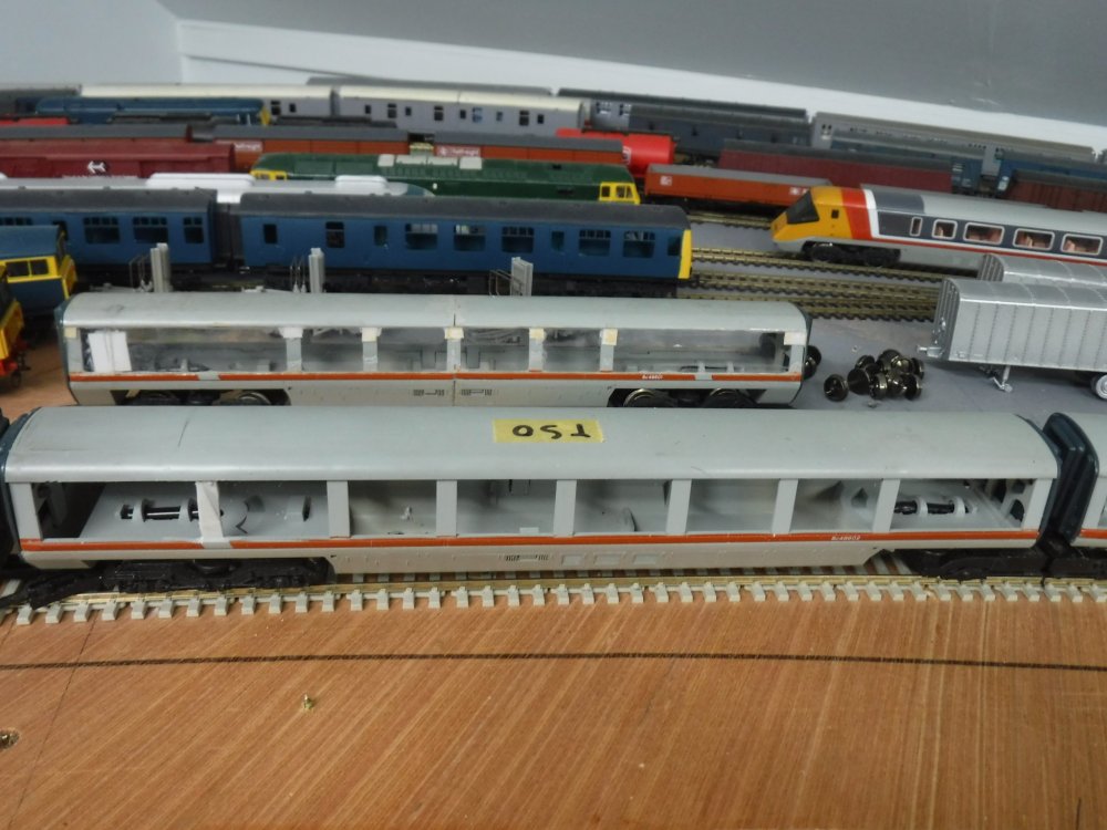

Cut and shuts so far, we have:
  • Power Car X3*
  • Driving Power Car X1
  • Driving Van Trailer X 2
  • Driving Semi Powered Van X1
  • Semi Articulated coach X2
  • Articulated Coach X6
  • APT-U Development Coach X1
  • Driving Second Class X1*
  • Trailer Guard First X1*
There is a complete five car set which will be left original and of the above marked * are as original also.
See if you can make sense of the photographs !

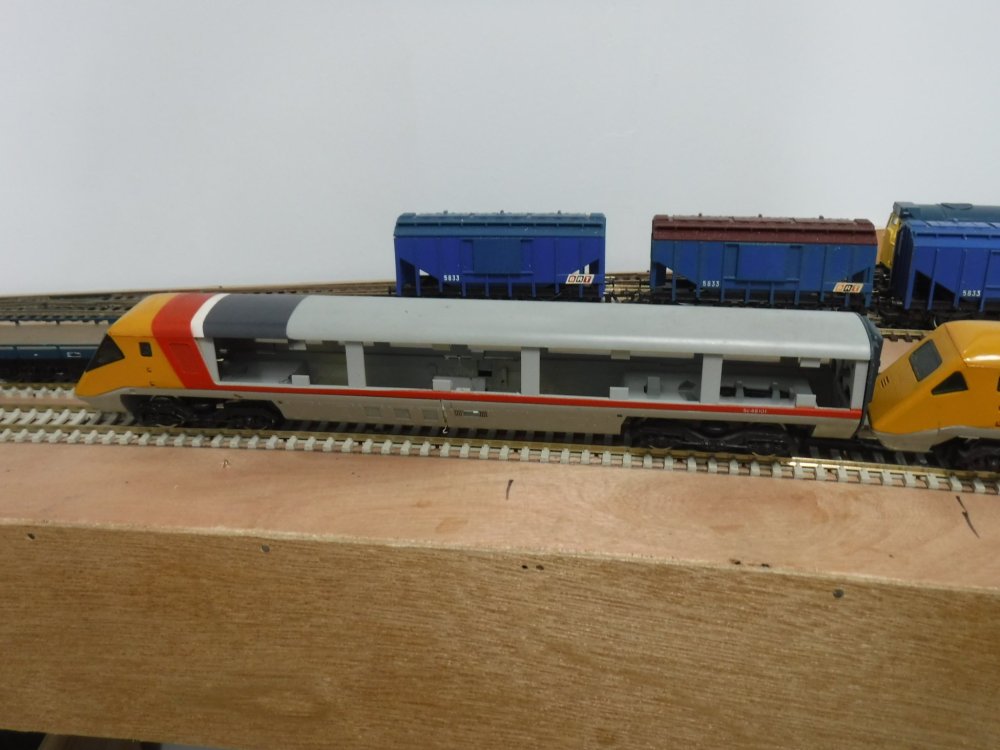

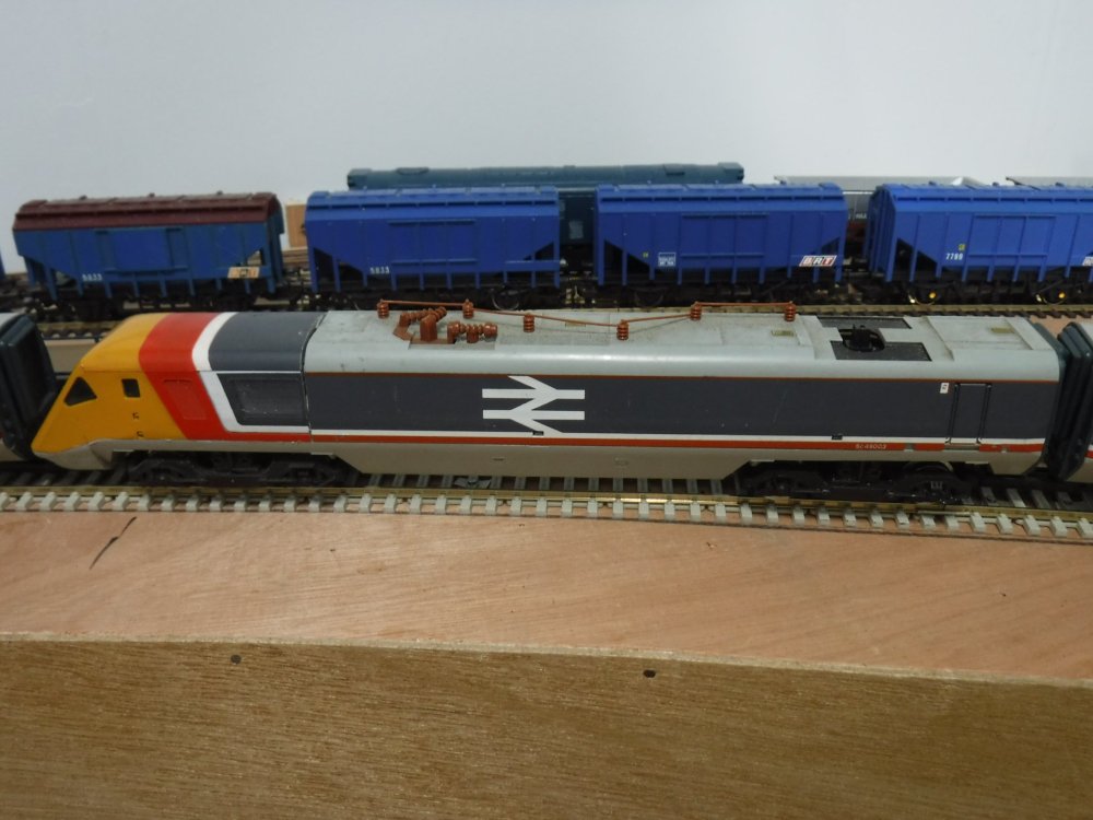

Power Car and driving Power Car.
Driving Semi Powered Van.
Driving Power Car.

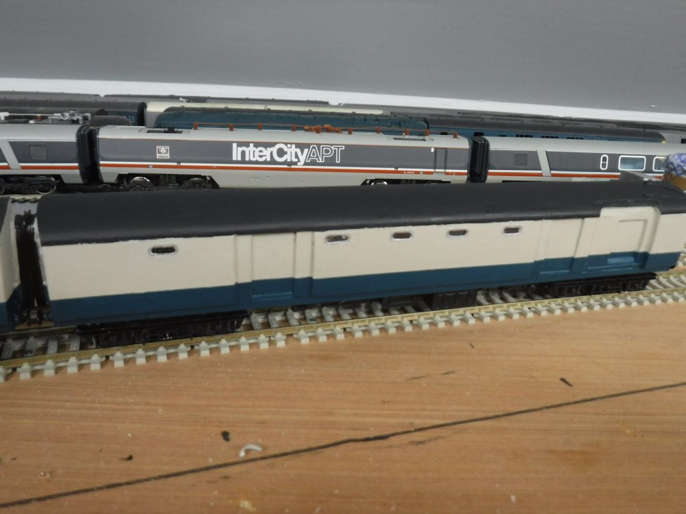

Driving Van Trailer.

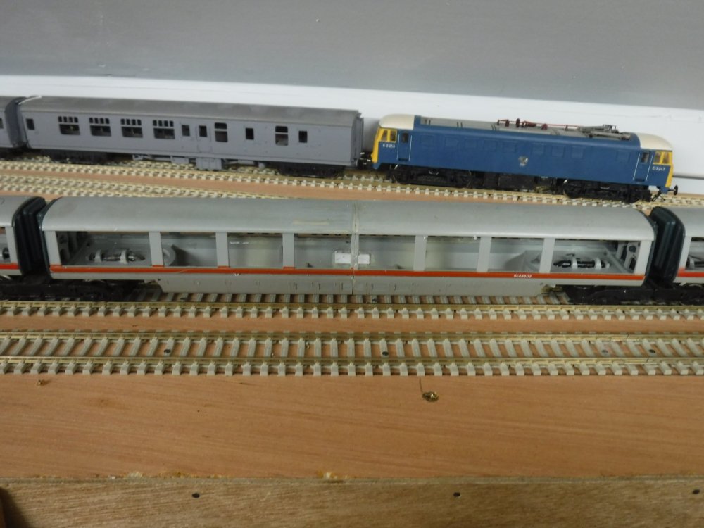

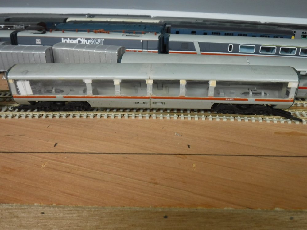

Semi Articulated Coach.
Articulated Coach.
APT-U Development Coach.
Confused ?  I was but after a couple of days its getting clearer !

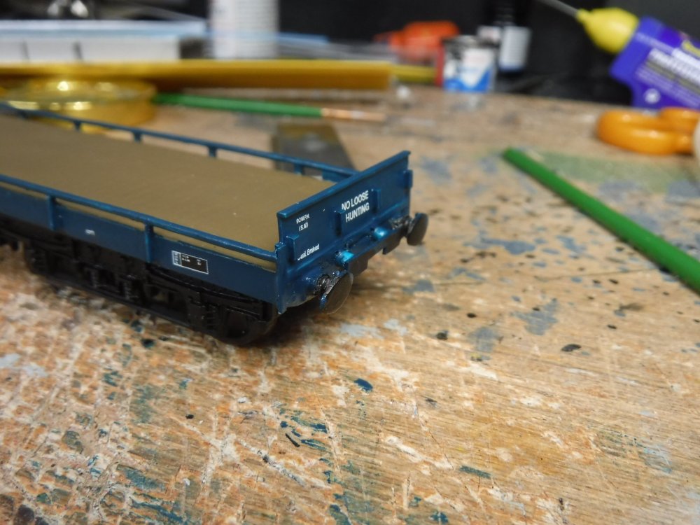

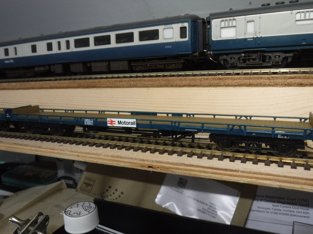

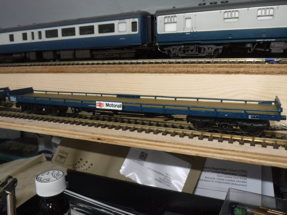

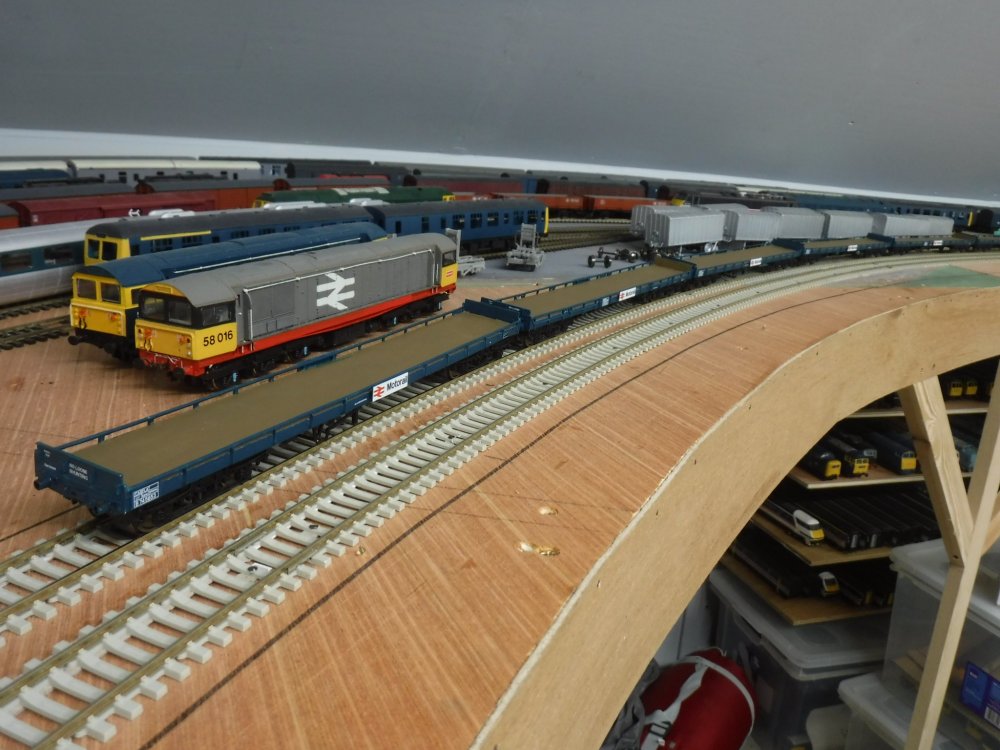

Hi Folks,

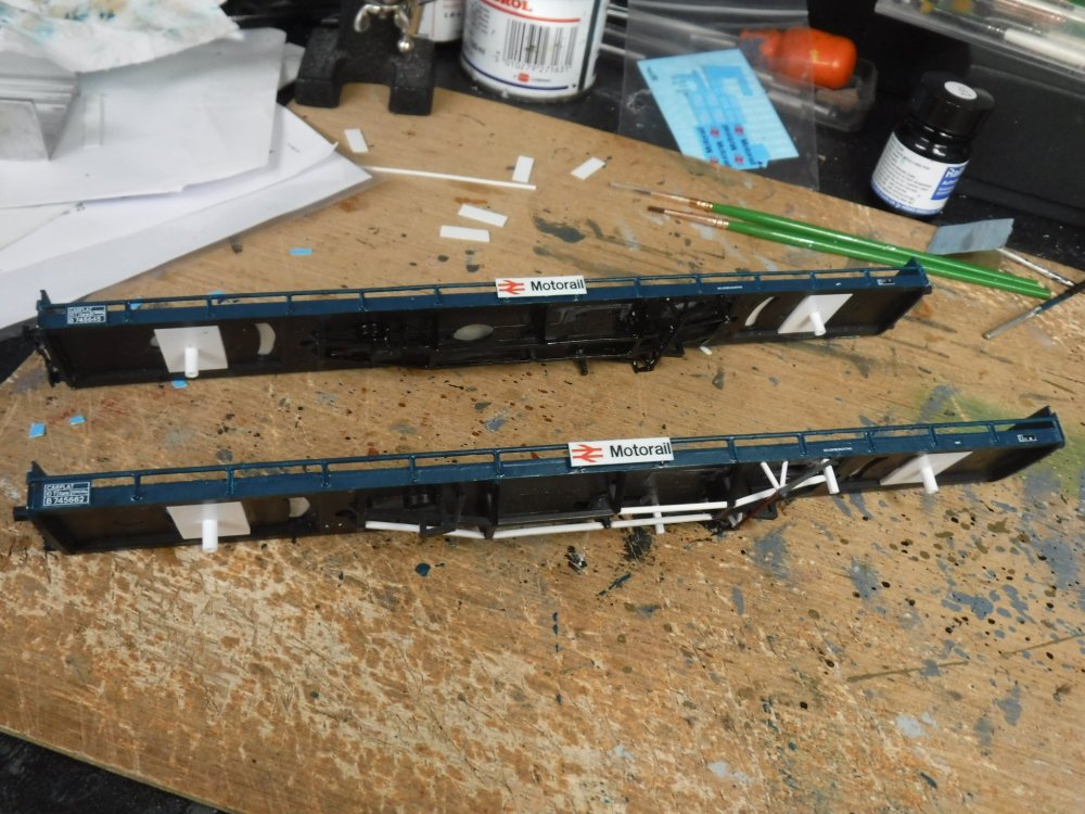

The white lines have arrived for the Postal Vans and I've applied one side of eight of them so far. I'm having a rest from them for a while before I go crossed eyed !

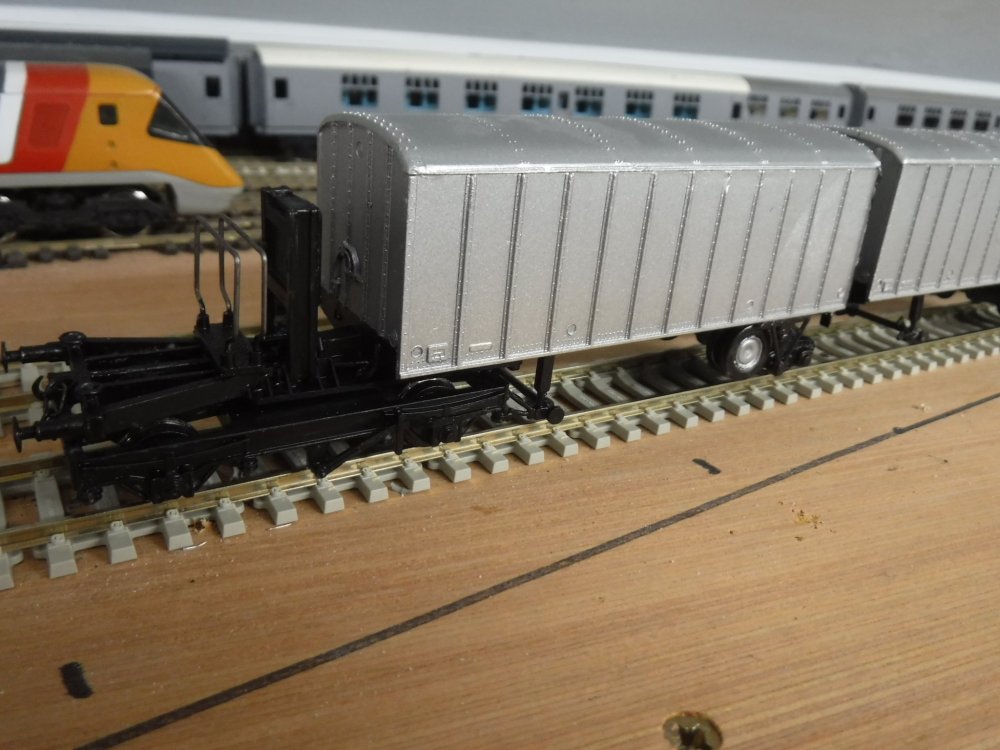

Along with the white lining the buffer heads for the Motorail car flats arrived also, I had  a break from the lining this afternoon to fit them. The next job will be buckeye rubbing plates of which I mad and fitted one out of twenty need for the ten car flats.
The new buffers and rubbing plate. The buffer stocks have been shortened to 1.5mm long to represent the buffers in their retracted position.
Gibbo.

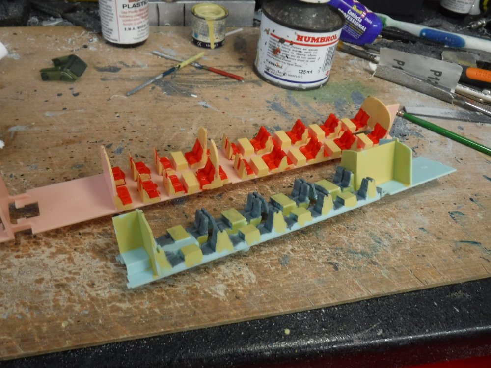

I've been steady away with the APT project, my eyes are still googly from doing postal van lining which still requires to be finished. So far I have been jointed, filled and sanded most of the cut and shut parts of the bodies although some bits will have to be done once they are fitted back together and ready for paint so those bits will have to wait for now.
In preparation for fitting the coach bodies back together I have painted all the seats and internals ready for reassembly as one together I won't be able to get at them. These seat units will have to be cut a shut to fit the respective vehicles but at least they are painted. I'm not too fussed about the shade but they will look a lot better than pink and light blue plastic, I didn't paint the floor as it can't be seen once together.
Painted seat units ready for cutting to fit appropriately.

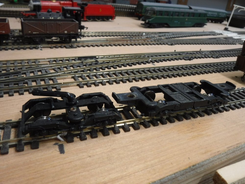

The next job was to remove all of the bogies to make working on the coach bodies easier and also so that spray painting will be easier. For paint colours I have chosen RAL 7043 Traffic Grey B and RAL 7032 Pebble Grey, Railtec transfers do a full set of APT markings along with red and white stripes so only the two shades of paint are required. Masking the windows is a challenge to be dealt with however I have an idea which may work. While the bogies were out I fitted new wheel sets of the correct size, these are 10mm Lowmac wheels from Peter's Spares.
Bogies with the Peter's Spares 10mm Lowmac wheels fitted to them.

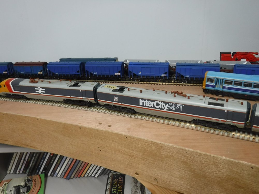

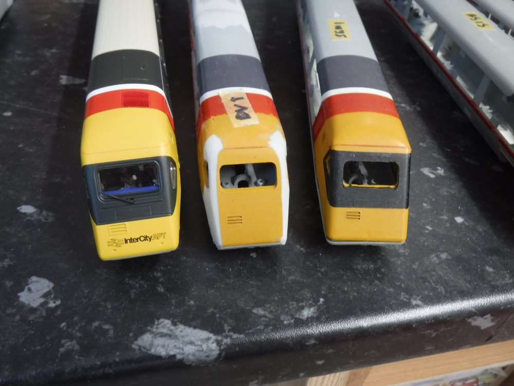

The original Hornby APT was a bit square looking at the cab ends, the rest of it was pretty well proportioned, and so I took the step of filing one of the cab ends to improve its shape. It came out very well and much better captures the look of the real thing comparing well with the new Hornby model. Fortunately the front corners of the nose end are quite a decent thickness and allow for a reduction of almost 3mm across the front edge. I shall get all of the cabs to a similar condition as the shewn below and then I shall do the relief details around the head lights. I plan to fit clear glazing to the cabs and so I also filed a taper the area around the cab side windows. The windscreen requires a slight enlargement which is also on the job list.
Juxtaposition of the new Hornby, old Hornby modified, and the old Hornby original.
Side profile view.
End on view.

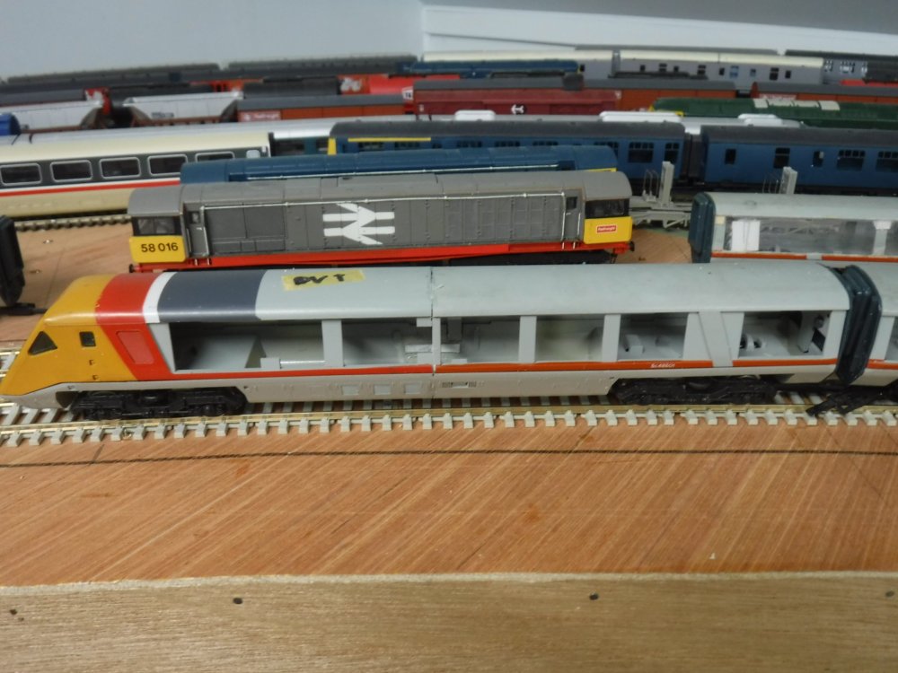

Hi Folks,
I've been working upon two DVT's, a DPC (driving power car) and a test car known as Pilot which was marshalled between the later iteration of the POP train.
The two DVT's, the pencil lines shew where the van doors will be.
The DPC, there is on ly one van door as the rear of the vehicle would have had traction motors fitted into it.
As you can see Pilot was made form all the left over bits hence it is made from three sections as the left overs were not long enough to make it from two sections.
DSCF2501.thumb.JPG.2079907c743825bb870b82f566cb47f1.JPGd
Pilot with the side blanked off, it had no windows, and all of the joints filled. The bogie pivot mounts had to be moved as the sections were from non articulated bogies. The POP train sections will have to be scratch built.
Gibbo.

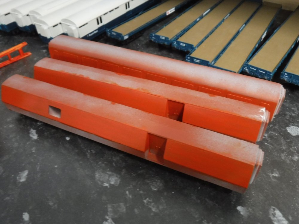

Hi Folks,
Here are the beginnings of the POP train's outer two cars, They have been made from .040" plasticard form drawings supplied to me by a friend who has one of the Leadley Kitts POP train kits. His one was one of the original space frame design, the version I'm building is the same two vehicles after the side had been fitted with cladding and the centre car added.
Base plates and entrance vestibules with the shaped bulkheads in the back ground.
The first bulk head was made and checked for symmetry before using it as a template to cut all of the other bulkheads, this way they all end up the same shape although due minor disparity I marked them with an X so that would all face the same way.
The bulk heads had gussets fitted so that they would stand perpendicular once glued in place. The gussets were mostly made from scraps. The one in the rear has a compartment for seats and will have a window which is why the gusset spacing is slightly odd. If you look carefully you can see the doors have been scribed onto the vestibule sides.
The roof was fitted next and was cut slightly wide, this was done a flat surface and weights were placed on the top so that it stayed flat and straight while the glue cured. the lower bodysides were then added again using a flat surface as a datum to align the pieces.
The upper sides were fitted last and had an angle scraped onto them so that a sharp edge would be formed at the waist line. The cuts are for opening out the vestibule are to be seen in the front one, the rear one having already been cut and trimmed to shape.
Gibbo.

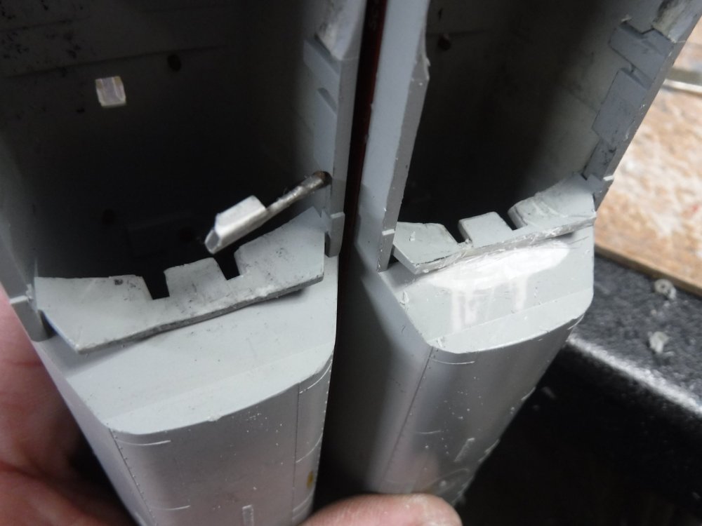

The tilt ramps were added to Pilot, as may be seen the bogie mounting has been altered as the coach has been made from leftover bits and bobs. The glue shews up pink because the brush used was to glue the top and bottom halves of the body together and it joins along the lower edge of the red line.
The corridor ends connections being fabricated from .125" Plastruct rod, I filed a 1mm flat along their axis so that they would have a decent adhesive area and also that they wouldn't roll around while the glue cured. The tops of PC3 and PC4 have had filler applied to create the peaked roof section.
Once the filler had cured I used a sheet of 120 grit sand paper to flat off the filler and create the angle required. The moment after applying the filler I had a thought that I should have glued a 1mm piece of strip along the centre of the roof as a datum to both fill and file to, good old hindsight !
The result of the sanding has turned out quite well despite my idea of fixing a guide to the roof being about five minutes too late. There a re a few small low patches which will be treated remedially. The wavy edge of the filler is due to slight undulations in the roof and despite the wavy edge the formed roof is actually flat when checked with a straight edge. I filled and sanded the undulations in the body sides in the same way as may bee seen from the patches of filler on the body sides. The corridor end connection were also filled and sanded to shape.

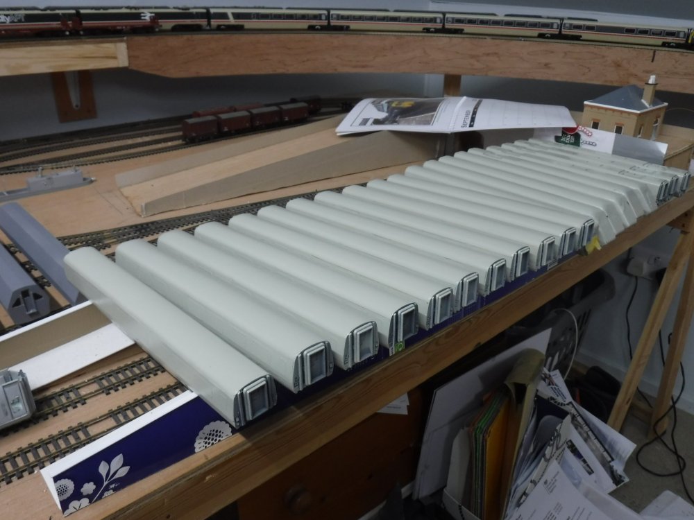

I have been fitting the glazing and seating to the APT-P stock today, the POP II train has been shunted into the nearly started siding along with the postal vans.
All but one of the coaches have been glazed by cutting at the mid point between the windows to fit two pieces into each side which requires only minor filling at the joint and on some minor filling at the ends due to the slightly different dimensions of the first and second class sections of glazing. The one coach that has not been made up from two sections per side is the TS3 which is for the APT-R/S/T versions, it has eight sections per side as it used up all the left over sections. A little more filler required on this one.
The pencil marks are to line up the inner edge of the window so that the marking out of the cut could be made.
The other job was to cut and shut the seating to be placed inside the various coaches. I have painted the seating up in red for second class and unclassified and a mid blue for first class. I haven't worried too much bout seat arrangement so long as there are seats is good enough for me. worse still the aisle swaps sides in first class as the seating is 2+1, Rule 1 applies in this case !
The seats for  the buffet car should really be second class pattern but I didn't have enough so I used left over first class which have sine been repainted red. i did however build up the kitchen and serving bar area also since painted.

The main job I have been doing today was lining transfers on the postal vans, only the lining across the ends of the vans to apply now.

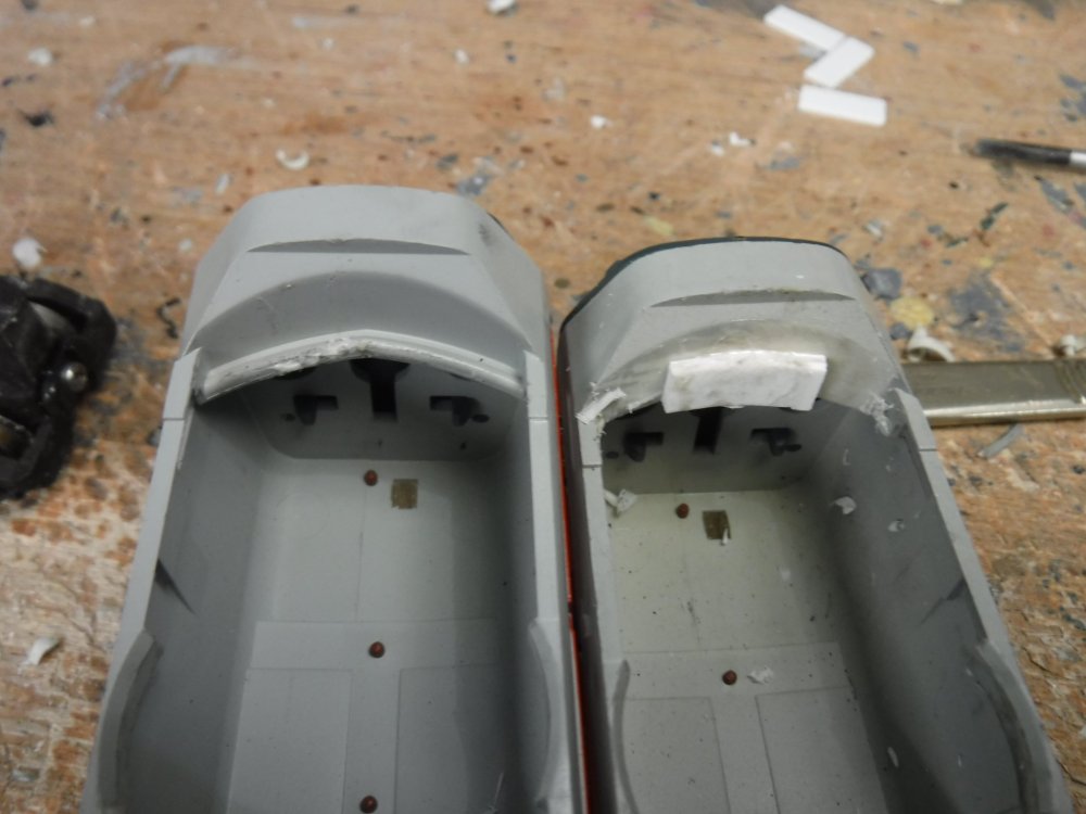

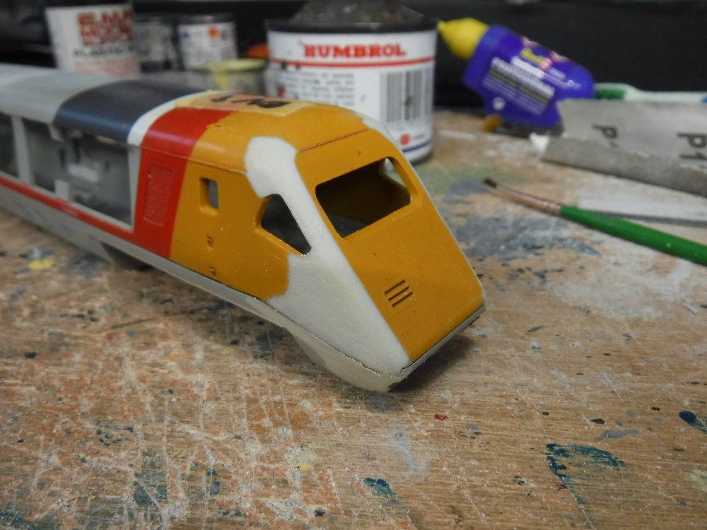

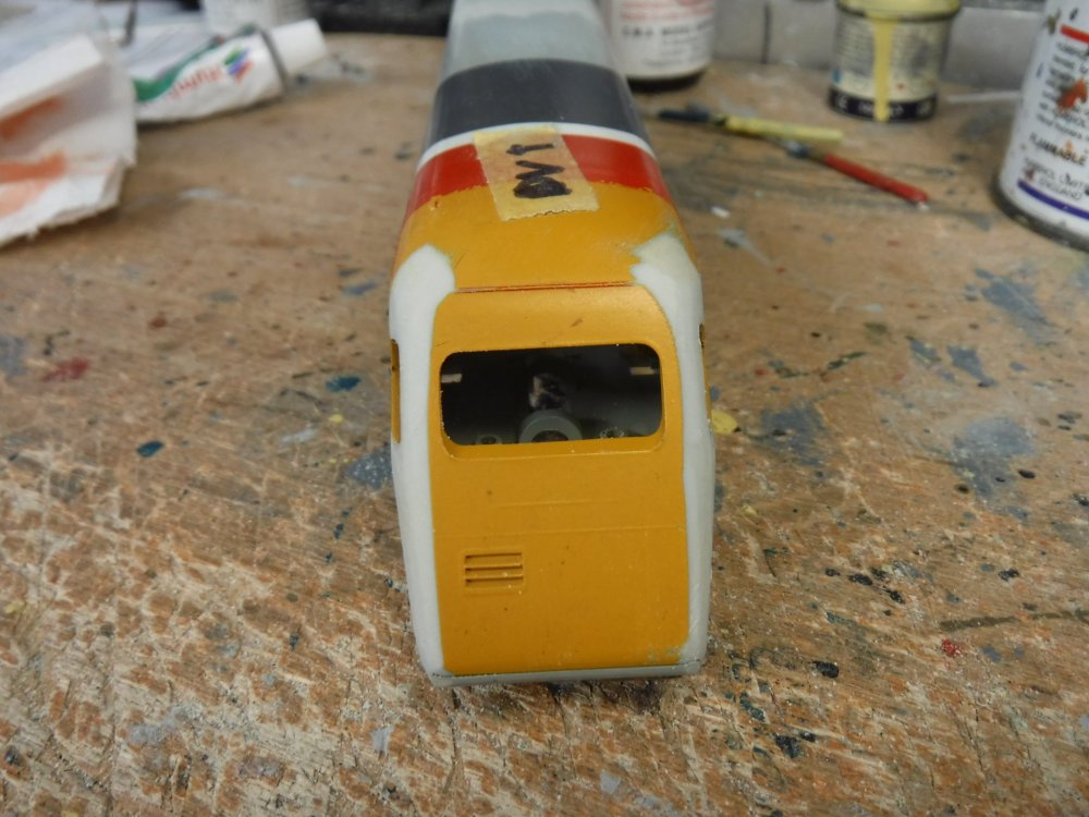

I've been mostly sanding down filler on the remaining coaches however I had more excitement when the postman delivered an extra Driving Trailer Second. The whole point of getting this DTS is so that I could have one with the nose in the up position so that it could be used to form up test trains and the like.
I even went to the trouble of opening out the drivers windscreen despite the fact that it cannot be seen at all once the nose is fitted, I won't be bothering to glaze it though !
Here it is almost finished, there will be a bit of filler to put round the top of the bulk head which I can only do after the body is finally fitted. This will be done after the interior is painted and so far only the seats have been painted.

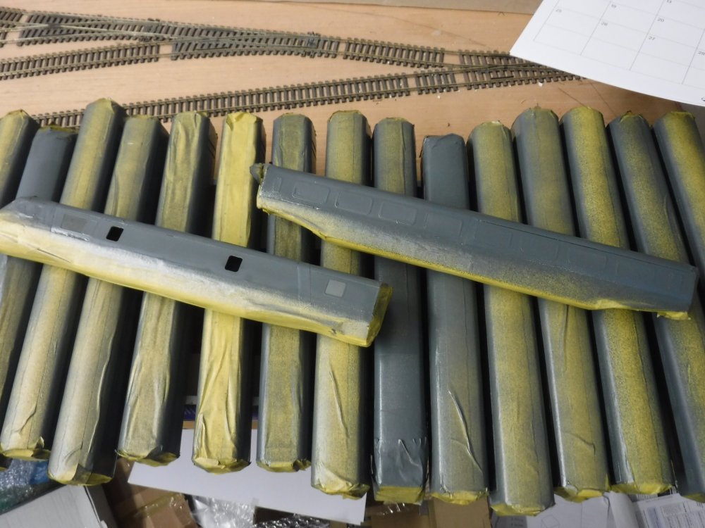

Hi Folks,

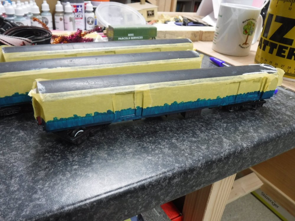

Today's job is one that requires a Podcast, (Dimitry Orlov entertains today) as I'm masking up the windows ready to start the paint job for the APT coaches.
I have made a cutting jig for shaping the masking tape, I lay out a strip onto my cutting mat and then using a brand new blade very carefully cut around the inside of the jig to then peel away the excess leaving the piece of masking required. it is then a matter of lining up the masking onto the windows appropriately.
Masking tape blanks and the jig used.
Masking applied, I intend to get some silver window frames made up from vinyl decals rather than paint the window frames on as this will be far too much like trouble.
Gibbo.

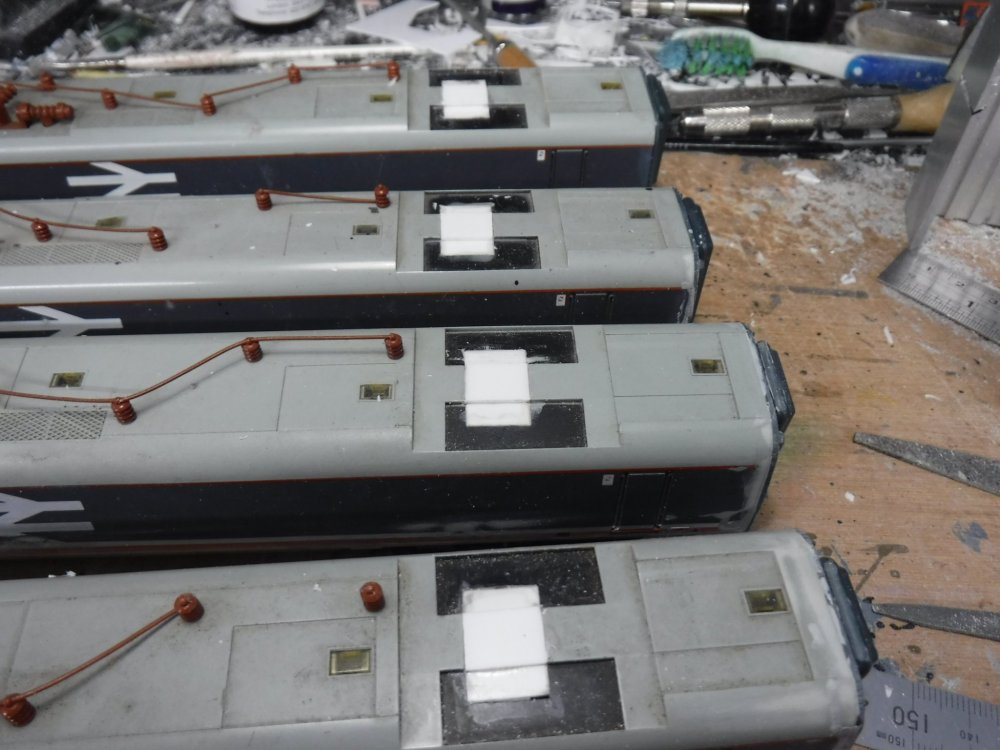

Hi Folks,
Second post regarding works done today, it is the DPC2 which has had the rear part of the roof altered to match the other power cars. The section under where a pantograph could be mounted was spliced in from the offcut that was left over from making the DPC4. the DPC2 and both of the DVT's have had the windows in the van doors cut and shaped. There will be filler and sanding to do and windows to fit before painting however the project is going well so far.
The area of roof that is flat may be seen either side of the section over where a pantograph may be fitted. The scheme was to use a roof level jumper cable and only use the pantograph of the adjacent power car for power collection.
The outline of the doors will be scribed in after the body shells have been glued together and sanded down.

  • The Motorail flats are left overs from MK1 cut and shuts.

I have been making up the underframe details to the POP II train. I decided to build the framework onto a base as it would be easier to position and get square upon the model proper.
Fabrication began by making up the lower part of the frame work from .040" Plastruct rod, the next job was cutting out the base plate and positioning the two central stanchions that the lower framework was to be attached. Once cured I glued the lower framework onto the stanchions and to get the framework parallel to the baseplate I used a temporary prop which was secured by a very small spot of glue so that it may be removed later.
This shews the base plates with the stanchions in place with one having the lower frame positioned with a weight to keep it on the prop.
I then made up and fitted all the other pieces and once the majority of the structure was cured I removed the prop and fitted the diagonals as the final four pieces to each structure. The whole will then be attached and with luck will clear the bogie tilt mechanism.
The structures will have the various points and edges filed down before fitting.

Hi Folks,
I have been faffing about with the sanding of filler and the application of grey primer on my APT project which is a bit boring but needs to be done before finish paint. Various areas of various bodies required remedial work and re-application of primer.
The power cars are too high and as the wheels are about the right size then the ride height of the bodies had to be lowered by 2mm, this was done by reducing the depth of the height of the tilt guides where the bogies locate. There is a guide rail at the other end that was removed and replaced with block of plasticard as the lugs on the bogies would have interfered with the body sitting correctly.
The tilt guides as original left and reduced right.
The bogie guides at the other end, the plasticard block retains the position of the bogie when fitted into place and prevents fore and aft movement in relation to the body.
I also took the trouble to fill in the oval hole in the roof where the pantograph mount on top of the motor bogie passes though. I decided against making up the passageways where the pantograph support structures pass through as with the real thing as I would have only been able to do one end as the motor bogie fills the area where theses voids ought to be at the other end. I got some pantographs from Peter's Spares which will fit over the repairs so it won't be overly obvious that the holes have been filled in.
Shewing the patch repairs tot eh oval holes.
After all that the body shells were ready for paint, the areas around the cab windows and marker lights were masked up and the electrical insulators were removed from the roofs of the power cars in readiness for priming which was done yesterday and first finish coat of the light grey this morning with second coat this afternoon. Fortunately I got finished about an hour before the rain came as I do my spraying outside.
Twenty APT vehicles in light grey. This is the first time I have used RAL 7032 Pebble Grey as a BR colour and I have to say it is as near as makes no difference to the shade of Lima's Mk3's that I have although Hornby's version does seem a little more yellow. The differential to the new APT-P in the background is mainly due to lighting considerations. I'm, sure that the dark grey and the red and white stripes will make a difference.
Gibbo.
Hi Folks,
I masked off al the APT vehicles and applied the dark grey, unfortunately it was a little cool for spraying and the paint bloomed slightly. This is not to much of a problem because it is only first coat so the colour will good after the second coat. I have ordered the transfers from Railtec and these should arrive in good time along with the transfers for the POP II train.
The one on the left shews bloom and the one on the right is free of bloom.
Another job that is being progressed is the three MK1 postal vans as they have been half painted in the grey for quite some time now. I do have to finish off the other LMS postal vans as the lining is not yet finished.
First coat of blue, these have been brush painted as they were previously painted in Railmatch Royal Mail Red and would have reacted with the spray paint. I have just enough transfers left over to letter them up.
Gibbo.

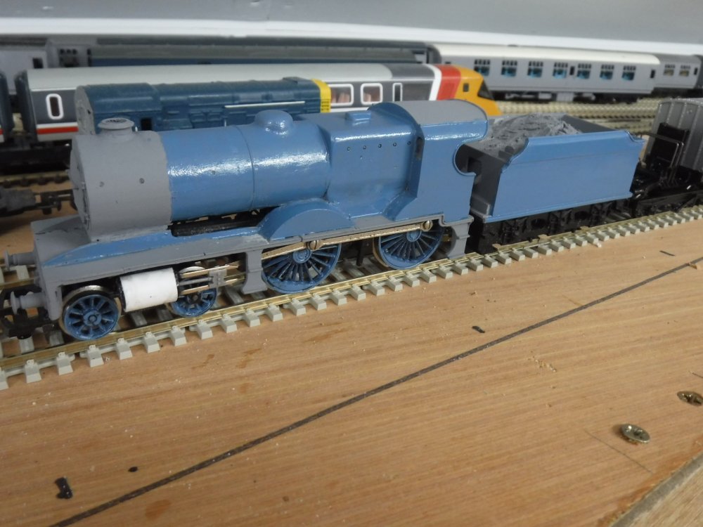

Hi Folks,
I've been painting things today, see below:
Merlin 85 in Humbrol 48.
Underframes painted black on the ten Road-Railer wagons and also the two of the conversion trucks, the third is in light grey.
The Mk1 postal vans had their second coat of blue along with the underframes, corridor ends and roofs painted appropriately. The blurred photograph does make the painted window frames look that bit better !
Tool and riding vans have had a second coat of red after filling the side where windows had been filled, they will need another coat yet as the colour is not very solid as may be seen.
BR Std Cowans Sheldon 35 ton crane has had first coat of red to be going on with. I took my time getting around to this particular job as I built it about five years ago at least.
Second coat of red for the POP II train, this will also require a third coat as it still has a touch of undercoat shewing through.
I have also painted an LMS 35 ton crane black and a Dapol Presflo wagon into grey to match several others that I built a while back. I ordered some more paint the the main part of the APT project however it has not yet arrived so that is one reason for paining all my other stuff that should have been done previously.
More red paint in the main tomorrow hopefully three coats will do the trick.
