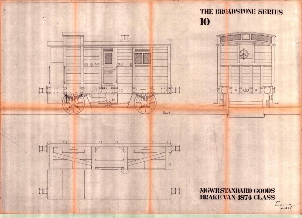

The prototype in question. Anyone have any idea what liveries these wore or how long they lasted?

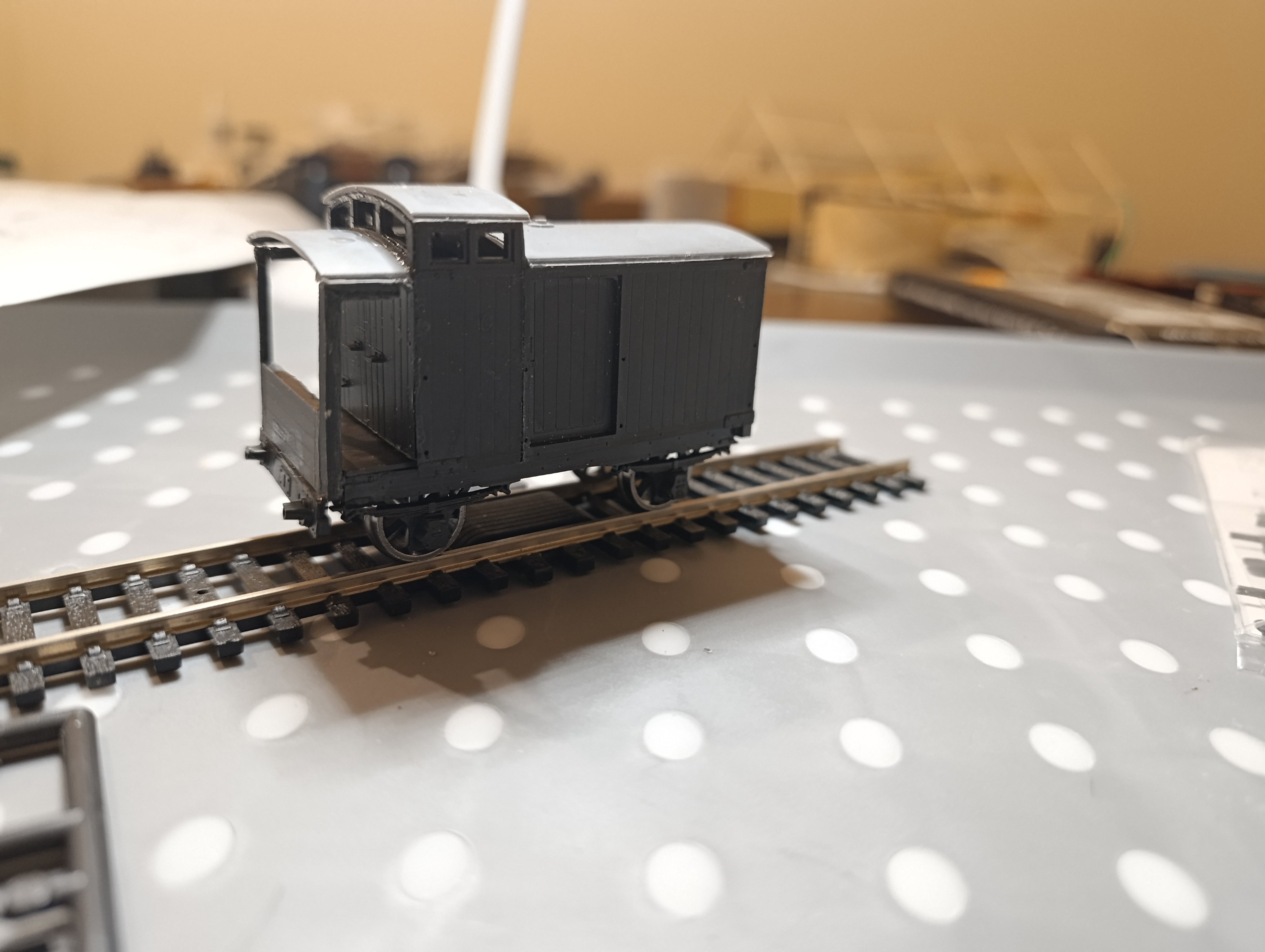

The kit, unfortunately lacked a balcony. An extensive rebuild was required.
The end result, not too shabby, but I'm just after realizing the steps are still on the side. Bit late 🤣. I won't tell anyone though.... A guard and paint should distract. Handrails and fine details still to be added.
