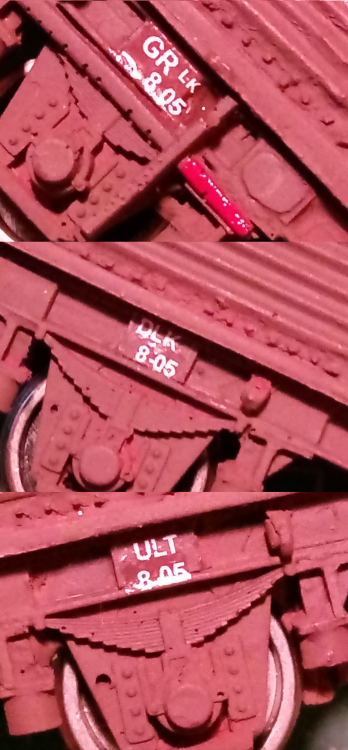

RobertRoche Posted February 16, 2018 Posted February 16, 2018 Would anyone know the following markings that came with the provincial wagons double beet kit mean and where they should go? It's hard to make out more than the 8-05 part on any picture or video I have seen of the prototype.
0 Glenderg Posted February 19, 2018 Posted February 19, 2018 Robbie, Hope the attached photo helps with locations. Open to correction here, but I believe that D-LK is brake test carried out in Limerick, GR-LK is General Repair, and ULT is ultrasonic, carried out in the North Wall. First two are generally grouped together since they are usually done at the same time. R. 1 2
0 RobertRoche Posted February 19, 2018 Author Posted February 19, 2018 7 hours ago, Glenderg said: Hope the attached photo helps with locations. Open to correction here, but I believe that D-LK is brake test carried out in Limerick, GR-LK is General Repair, and ULT is ultrasonic, carried out in the North Wall. First two are generally grouped together since they are usually done at the same time. R. Thanks, that is interesting! Were the markings on both sides of the wagon? The above picture shows the side without the brake gear.. Is it the month and year noted under under each?

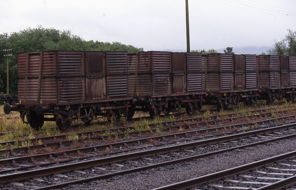

0 Glenderg Posted February 19, 2018 Posted February 19, 2018 Always on both sides, but no reason nor rhyme to placement, so long as they are along the solebar. It's down as 12-04 for the first two (December 2004) and there'd be a few months between the ULT test usually, so it might be ULT 5-05. Interesting to note the alternative placement of running number between lower left and centrally on the doors when compared with my photo above... 1
0 RobertRoche Posted February 19, 2018 Author Posted February 19, 2018 (edited) Many thanks. I am sure that IRM have done their research on this subject I have opted to put the running numbers on the end of my wagons. Edited February 19, 2018 by robbie58 1
