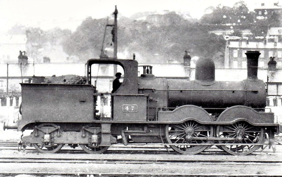

  5. Is there any copyright attached to this image? I don’t plan on using it commercially or anything, but I’m wondering if it would be grand to put in a facebook post.
