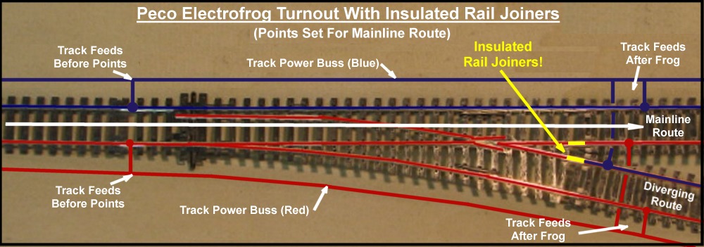

0 irishthump Posted November 28, 2013 Posted November 28, 2013 Do you have insulated (plastic) joiners on the two tracks leading away from the frog? Like in this diagram... Quote

0 irishthump Posted November 28, 2013 Posted November 28, 2013 You need to take the little clips off the point. Quote

0 BosKonay Posted November 28, 2013 Posted November 28, 2013 In your photo, you have what look like Hornby "DCC" clips inserted into the point. See the small thin metal 'wires'? You should be able to pop them out with the blade of a screwdriver, you should be ok then. Quote
0 BosKonay Posted November 28, 2013 Posted November 28, 2013 Also, the frog should be fully isolated - so make sure you have insulated joiners on both frog connections like this image Quote
0 irishthump Posted November 28, 2013 Posted November 28, 2013 Take off the clips and put the plastic railjoiners on the tracks leading from the frog like in the diagram. Quote

0 BosKonay Posted November 28, 2013 Posted November 28, 2013 Take the clear plastic rail joiner on the bottom left rail and move it up to the frog. Then join the point up to your layout using regular metal joiners on all the other rails. Quote
0 irishthump Posted November 28, 2013 Posted November 28, 2013 Move the joiner in the circle to the rail with the other circle. Quote
0 irishthump Posted November 28, 2013 Posted November 28, 2013 And as Bosko said make sure you put metal joiners on all the other rails. Quote
