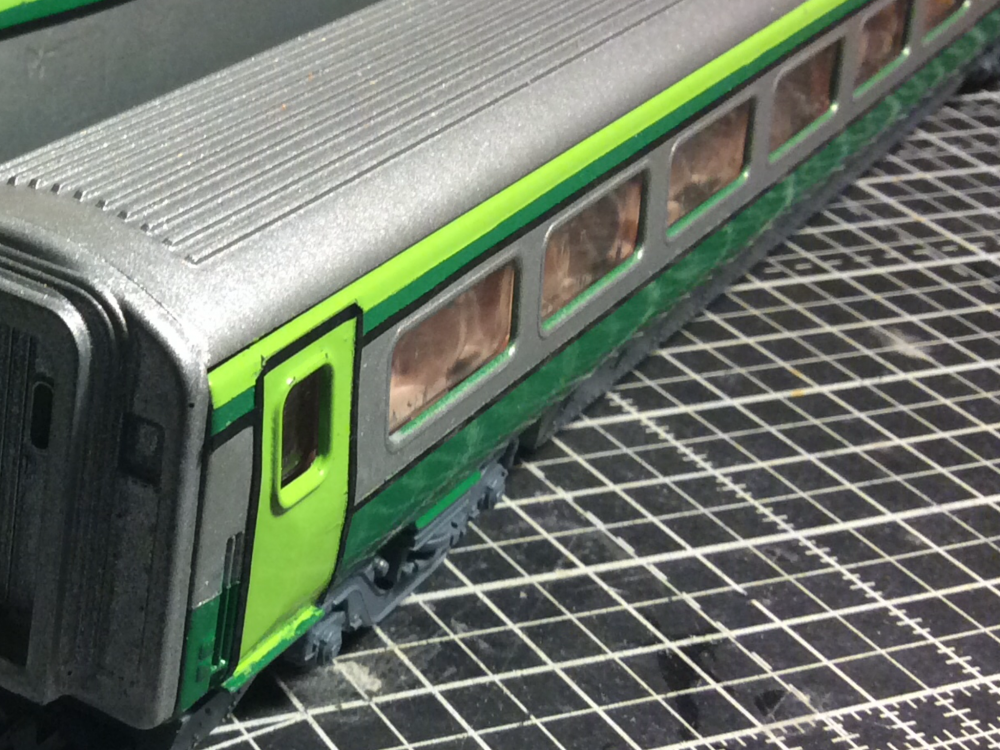

Coach Window Tinting - help ?
Mr Bob
Mr Bob
Take out the glass and use an airbrush to spray lightly a dilute tint on the inside or use one of the tinted stick on window films you can get online, when the glass is out use a Sharpie marker or a Rotring/Mars drawing pen to blacken the frames- carefully!
