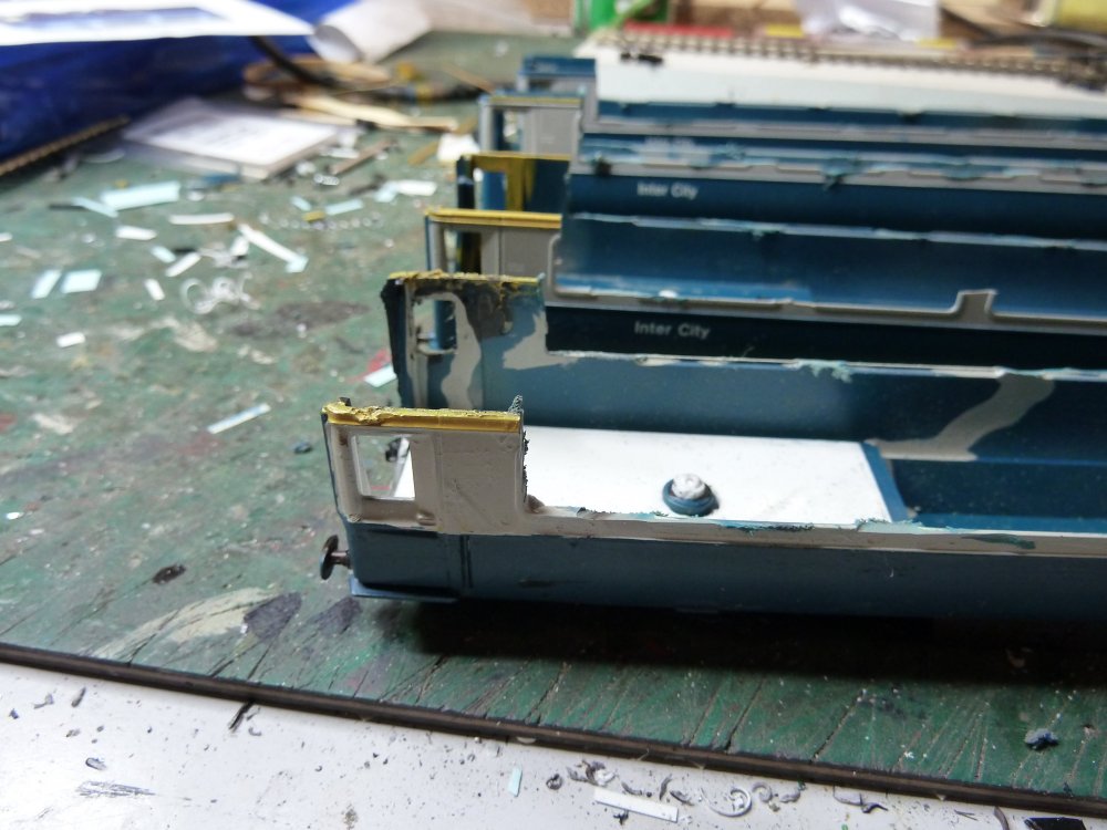

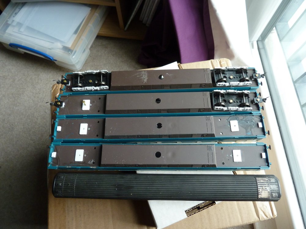

Well got bogies sorted and started cutting the bodies - well two shattered as soon as a razor saw  got to work but two ok , so now off to find too more coaches but at least now have spare buffers and roof units .  One step forward and at least two back, along with IT issue so no pics yet.
Robert
Well first pic looks good with a bogie and No5 couplers mounted on two and two others part modified, and a roof having a first effort of scraping away unwanted ribs so far so good but  lower body has a telling  crack.  The second photo shows after middle section first cut  the two nearest show signs of a repaint, these two shattered on next cuts to remove doors , perhaps a reaction to the thickly applied paint.
Luckily I cut out more than need bogie spacers and able to get two more coaches from evilbay yesterday. Hopefully this will not fall apart.. I had bashed ahead with making 4 the same - but this wrong as well as the BFK  might well warrant less cutting...  so defo a case of more haste less speed.

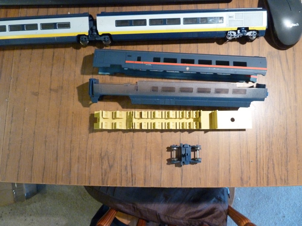

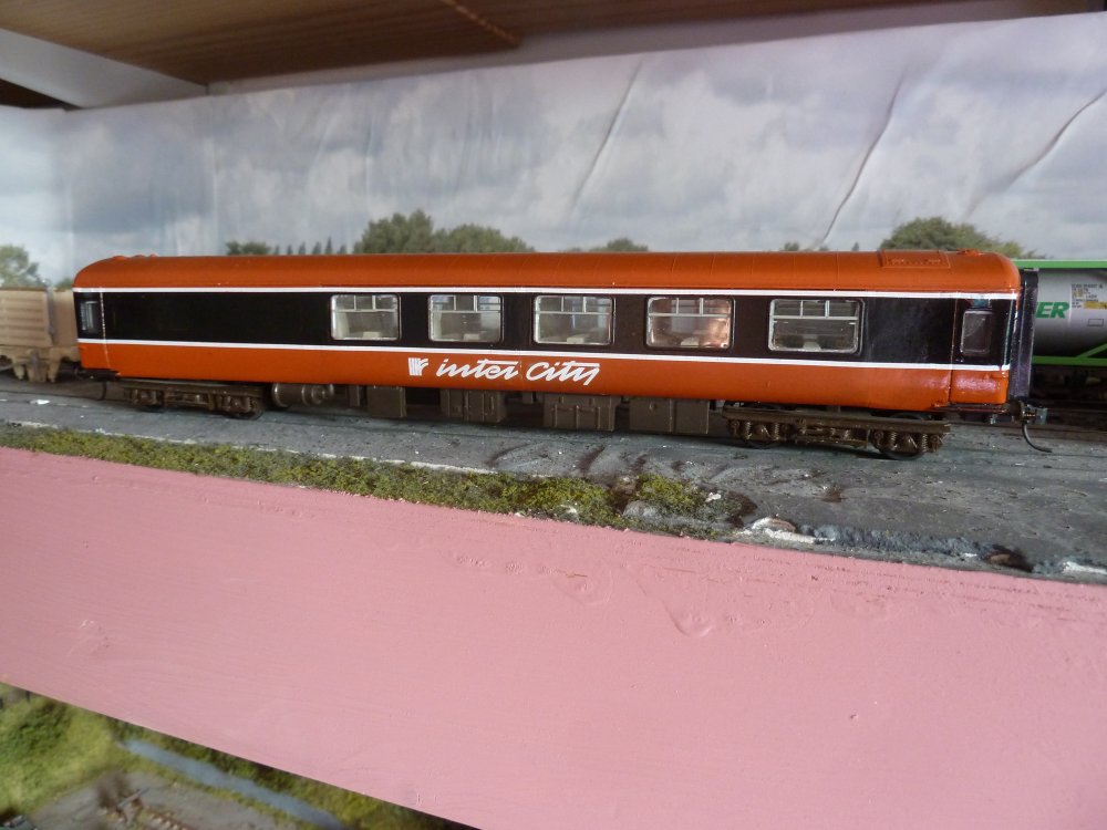

Never liking having stuff finished these resting pending sorting square ends and adding resin doors I started looking at Enterprise stock by butchering Eurostars - got photos and a drawing for dimensions so £30 on ebay for 4 spares and repairs and a power car - which as an aside will give a good supply of grill sides for many a year for 80class etc conversions..  And in a fit of fun fitted Kaydee 5s to a MK2 cut and shunt for a tea car mk2a - Arfix shell with bachman MK2 windows and plasticard. I struggled for a while trying to see why Bachmann chassis not fit, coaches differ by 5mm, so Arifix chassis fitted and Kaydee mounts.
