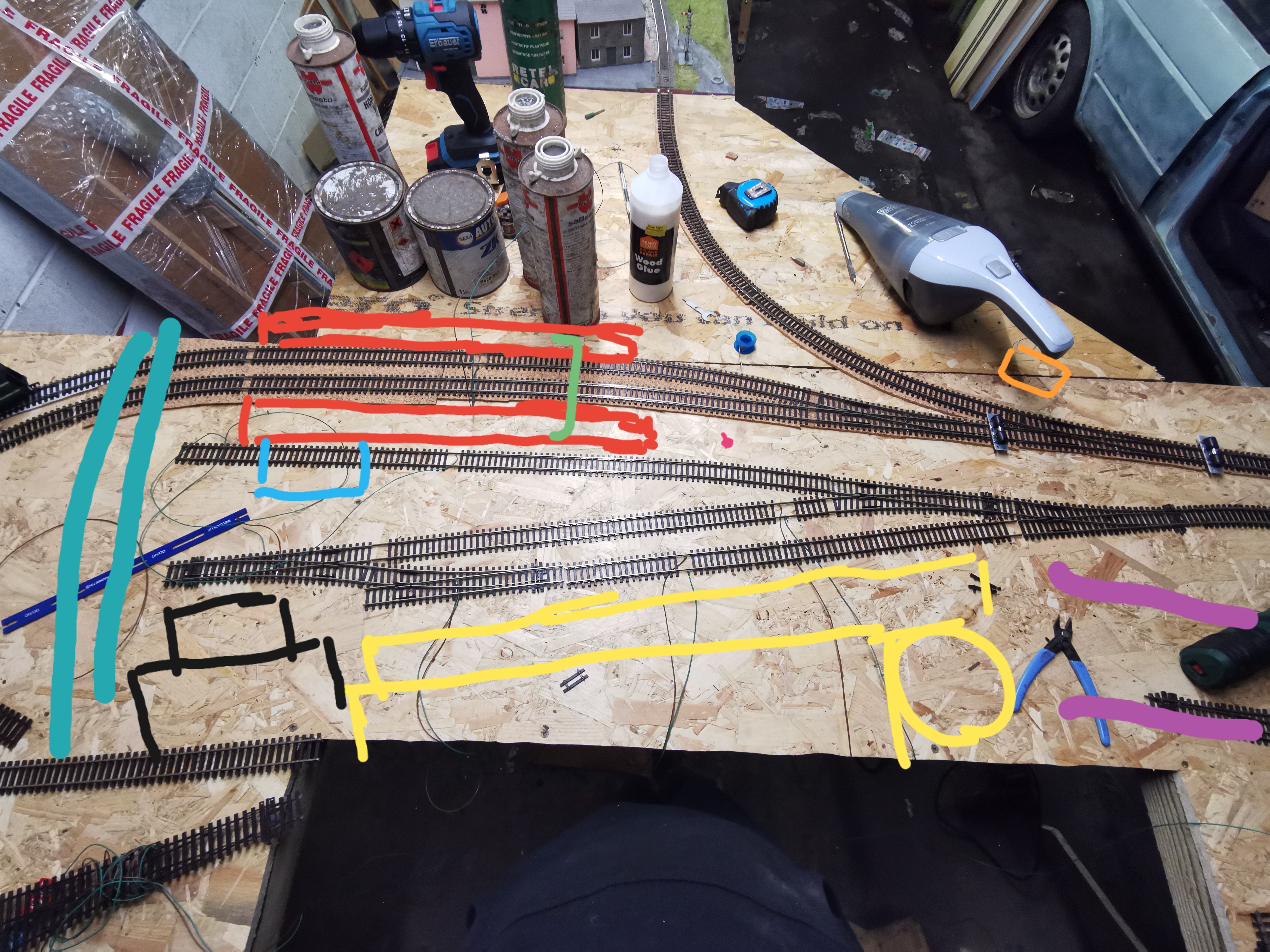

Managed to do a little bit with the new distillery I was peer pressured into working into the layout. Decided to go a little further and expand upon it. To me a distillery on its own doesn't make sense, so I've decided to put a little station/halt, in my mind the distillery would have sprung up, with the advantage of a local rail link to bring in skilled labour from further a field, then naturally expanded into rail service as the industry grew and there was a greater demand for the import of raw goods and export of the fine stuff. So using my advanced, top of the line photo editor on my phone and finger, I've illustrated the plan here. Red is the platform, possibly with a raised station building on a bridge going over the tracks. I've yet to decide. Green is a footbridge Purple is Road access Turquoise is road Bridge. I'll move it to where ever the headshunt will accommodate Orange is Signal building Pink is signals for the platforms. Blue is going to be a now unused goods shed that the distillery originally built before expanding operations to take a short siding directly to the building. Yellow is the original distillery building Black is a storage shed and grain unloading dock built after the original distillery to cope with increasing demand. Likely going to be a half brick, half corrugated building, with a lean to to cover the vans as they're unloaded Hopefully this all makes sense Tracks will extended beyond points to give a headshunt and the loading track. All will be laid on 4mm cork. I've yet to figure out where I am going to place in coupling magnets. More than happy to hear any suggestions Thanks all! -
