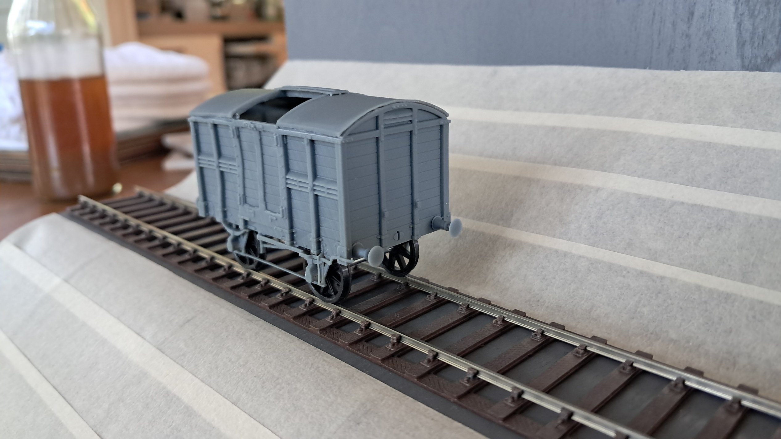

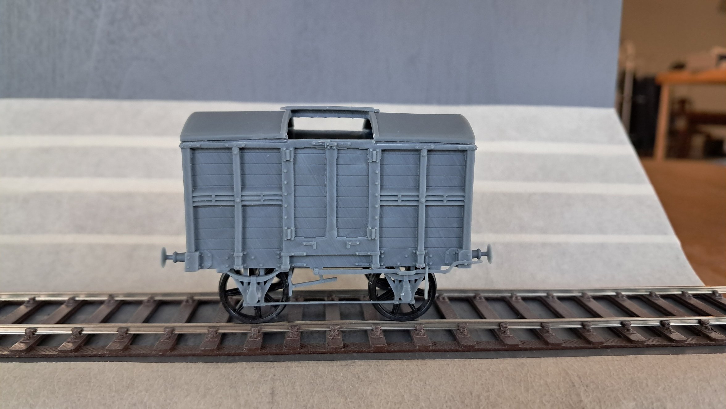

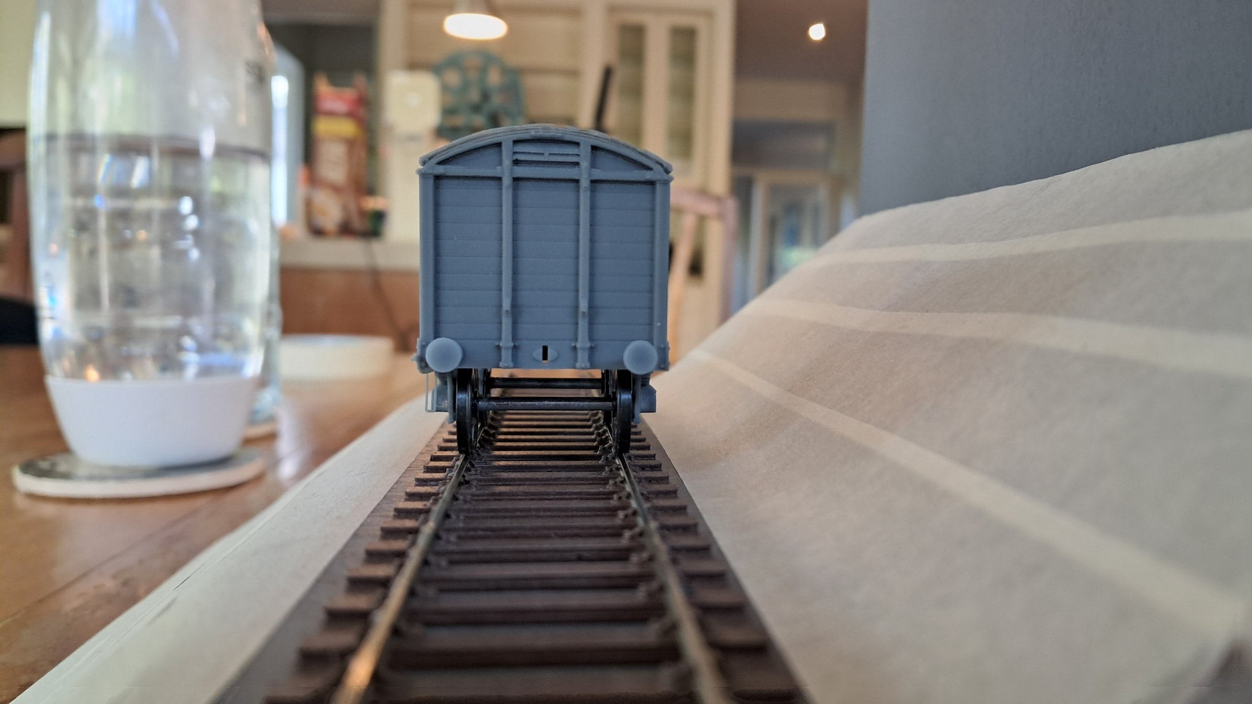

Roof attachment needs re-doing after thickening the walls, which I forgot before I printed it, axleboxes need some slight thickening, I still need to do the lower door latches, and there's still a bit of door warping to resolve, but it's a step closer. In the process of making the axles I've discovered that my drill isn't quite cocentric. Not enough to cause issues elsewhere, hence having never noticed, but enough that there's a distinct wobble in both wheelsets fitted to the wagon. Hopefully there won't be too much more of a wait for 28mm axles from the S4 Society, but in the meantime I may have to get one of my lathe-owning friends to do some for me, as while fine for display purposes these two would be very distracting in operation. Regardless of the issues, it's immensely satisfying being able to look at it and really see the proportions of the correct gauge. Sara
