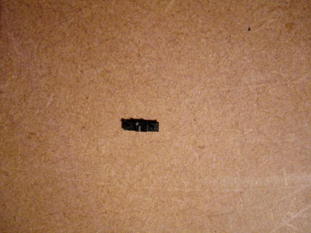

Sorry about the poor picture, this is something that has fallen off a tara mines wagon, its about 2mm x say 8mm, cant for the life of me find out where it goes. I found about three of them on the layout so far.
