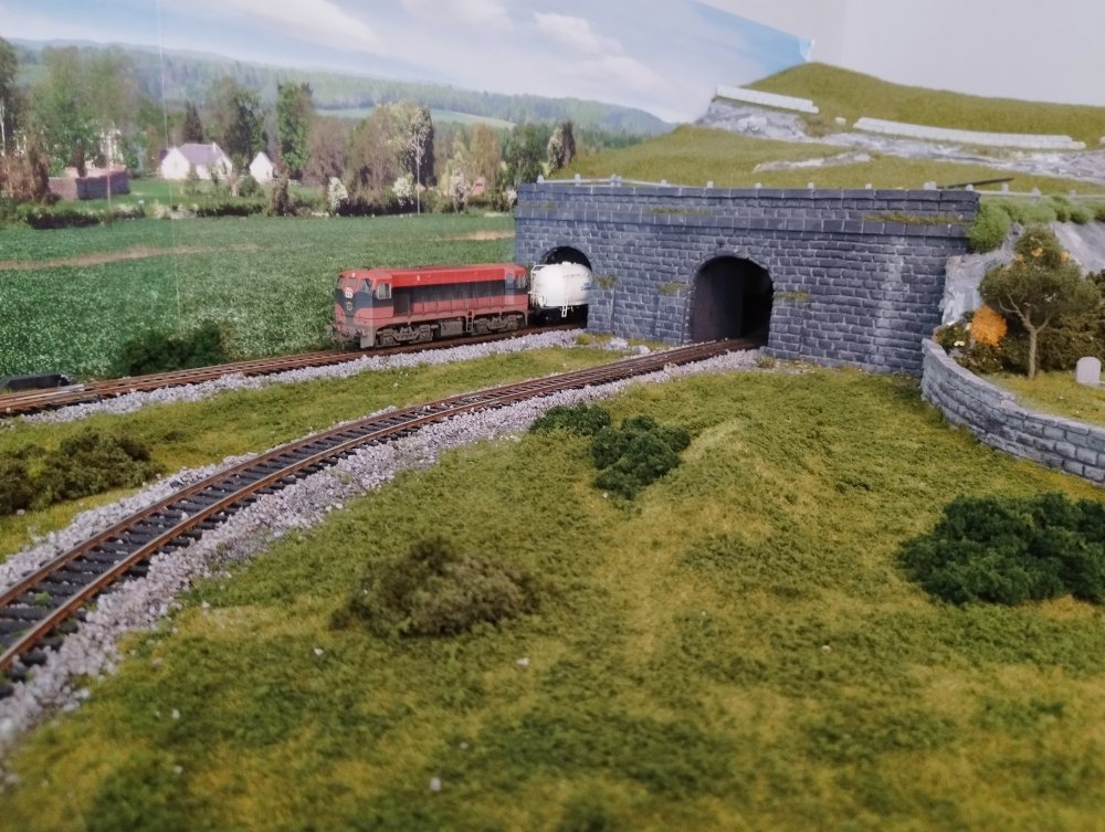

derek Posted May 22, 2024 Posted May 22, 2024 Hi lads, just have a couple of questions on "spray on glue", never having used it before. I have always used PVA for scenic work, but using coarse turf, PVA is not really practical. So, first of all - is Woodland Scenics Cement the only option available? ( I see Marks Models are currently out of the stuff). Does it come in a sprayer or do I need to buy that separately?. Applying coarse turf, do I need to spray layout first or apply turf first? Does overspray disappear completely /does glue dry clear? And finally, would watered down PVA in a spray bottle do the exact same job? Lots of questions I know but I do like to get my ducks in a row before I commence. Any tips would be greatly appreciated. Thanks in advance. Derek 1

Gortalainn Posted May 25, 2024 Posted May 25, 2024 I've seen people use a watered down PVA spray for a number of stuff on their layouts, might be worth giving it a try to see if it still turns your mat black when it's diluted. If you're very stuck apparently the blue Pritt stick dries clear! 1 1
derek Posted May 27, 2024 Author Posted May 27, 2024 (edited) In the end I just went with the ol PVA. I dabbed it on with a brush where I wanted the turf, sprinkled on turf ,allowed it to set and then brushed off the excess. And added some foliage etc. too Edited May 27, 2024 by derek 5
RobertRoche Posted May 27, 2024 Posted May 27, 2024 Nice ground cover, have you considered misting over the completed scene with more PVA to set it all solid?
Gortalainn Posted May 27, 2024 Posted May 27, 2024 3 hours ago, derek said: In the end I just went with the ol PVA. I dabbed it on with a brush where I wanted the turf, sprinkled on turf ,allowed it to set and then brushed off the excess. And added some foliage etc. too Glad it worked out for you, it's looking very nice. You wouldn't even know that it was turning the mat black. 1 1
derek Posted May 28, 2024 Author Posted May 28, 2024 20 hours ago, Gortalainn said: Glad it worked out for you, it's looking very nice. You wouldn't even know that it was turning the mat black. Thanks, that's because I covered all glued areas with the turf, so glue didn't show afterwards. 22 hours ago, RobertRoche said: Nice ground cover, have you considered misting over the completed scene with more PVA to set it all solid? No, not really Robert. Think I will just leave it now and move on. Bridges to be built. Its solid enough as it is I think 3
David Holman Posted May 28, 2024 Posted May 28, 2024 On 27/5/2024 at 7:17 PM, derek said: In the end I just went with the ol PVA. I dabbed it on with a brush where I wanted the turf, sprinkled on turf ,allowed it to set and then brushed off the excess. And added some foliage etc. too That's pretty much the standard way of doing things, though rather than brush the excess away, it is worth putting a handkerchief over the nozzle of a vacuum cleaner to hoover it up and thereby save it for further use. 1 1
