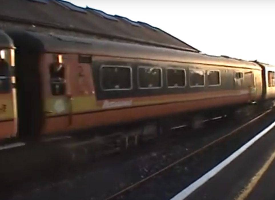

In 2000-2001, carriages 5209, 5213, 5216, 5225, 5232, 5233 and 5235 were refurbished and would wear the "Galway" livery. This refurbishment would include the carriages being completely rewired and treated for corrosion, along with new carpets, seats, curtains, tables, toilet fittings and interior ceiling panels.

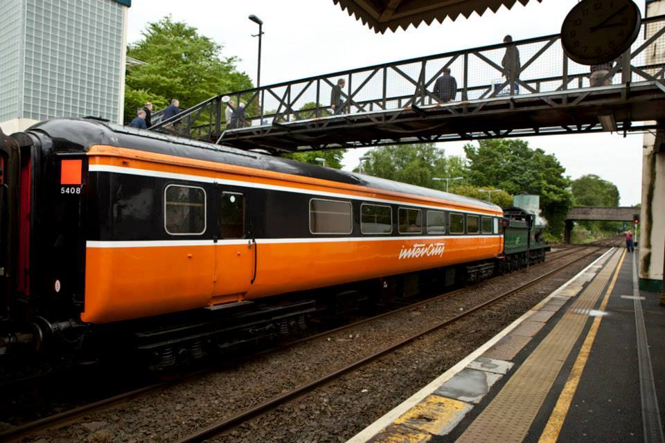

In 1977, 5408 was converted into a Presidential Saloon and was retired in 2011. It is currently on static display at Whitehead Railway Museum.
