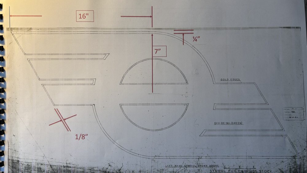

jhb171achill Posted January 19, 2018 Posted January 19, 2018 (edited) This is a good enough quality photo of an ACTUAL transfer, as used on steam locomotives whether green, black or normal grey; on buses, road vehicles and passenger carriages. The green paint is actual CIE green paint. Having seen the original daily for forty years hung on Senior's wall, I can confirm that this photo reproduces the colours accurately. Note the gold lining. For those modelling steam, it's important to note that the "snail" on tenders was this colour, and gold lined, always - never white, as Lima implied on their early and crude models by today's standards. Nor yellow as incorrectly applied by the RPSI to 184 and 461 in the 1990s. This darker shade of green, while seen on steam locos and buses to the end, was replaced on passenger stock and diesel locomotives by the lighter shade seen on RPSI heritage stock, and at Downpatrick on some stock, from 1955 onwards. The original may be seen in Headhunters Railway Museum in Enniskillen. Many of the other mounted coats of arms there (but not all) are mounted also on boards with original paint - Clogher Valley, CDRJC, NCC, GSR (but not GSWR), and Cork, Blackrock & Passage are original paint. So are DNGR, BCDR, and DSER (loco black). One of the GNR ones is, and one is in "works grey" as it was mount on its board in the 1940s when paint was either expensive or unavailable! Feel free to copy and use as you see fit. Edited January 19, 2018 by jhb171achill 1 1
DiveController Posted January 26, 2018 Posted January 26, 2018 @jhb171achillSo just too clarify this is the post '55 lighter green?
jhb171achill Posted January 26, 2018 Author Posted January 26, 2018 No, that's the 1945-55 one as far as carriages are concerned; see RPSI wooden heritage set or the C class at Downpatrick for the later version. Any green steam engines, plus all CIE buses, retained the above until the end of the green era in 1963.
