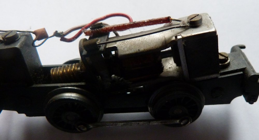

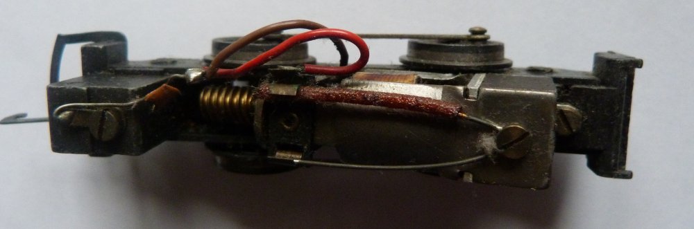

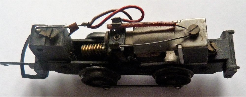

Friend lent me his loco aslong as i fixed it, it wouldn't move, noticed the pick up on one side was missing, so hacked in a little old hornby tank (which had motor problems, i'm going replace that later in 2019) & stole one of its pick ups, the tender loco smoked up. Decided to replace the motor, new one didn't fit in the shell.... replace both pick ups? - No movement & no smoke (its not suposse to smoke anyhow).  Any ideas??
Images show it with new pickups wired in place of the old ones....

P1110226.thumb.JPG.221e16edbaf1b5411a392804efb6c53f.JPGP1110228.thumb.JPG.1c68be7f3f0ef1dcf4e9ad7dbed2920e.JPGP1110227.thumb.JPG.fd17c1a48dbd36eb8bdd77d6a61fd622.JPG
4 hours ago, Joe Keegan said:
No spring to tension brushes on to motor commutator
Insulation sleeve required between spring and brushes
Ah. I think i understand.... So, i need to put the spring clip - with the insulation sleeve - back on the top of the motor?
