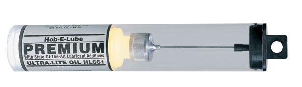

0 Broithe Posted March 20, 2019 Posted March 20, 2019 Woodland Scenics do four grades of their Hob-E-Lube oils, ranging from the Ultra Lite, almost paraffin, to the Gear Oil, like warm Vaseline. Each with a 'hypodermic' nozzle. The tubes will last your forever.
