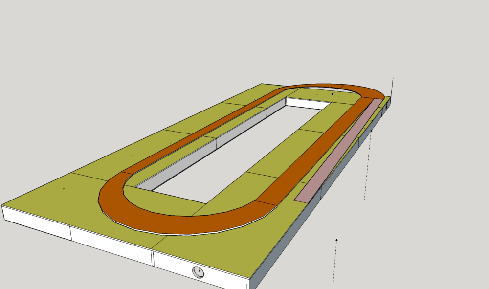

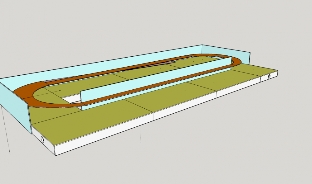

Thanks @DJ Dangerous your comment about a longer run-up got me thinking and I realised I only need the full clearance where the upper and lower levels cross at the front. So I can drop the upper level to ~6cm along the back and have a shallower up-ramp, and I can make up the remaining 3-4cm of clearance by sloping the upper level upwards as it comes from the back to the front cross-over point. I reckon I can achieve a maximum of 2% this way which should be fine for MM locos.

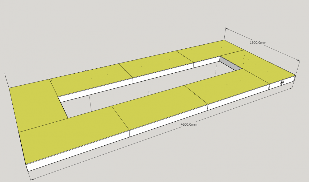

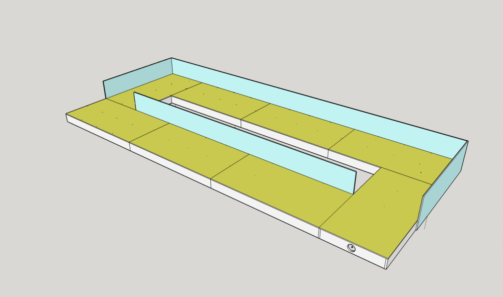

Thanks for all the comments and advice. So far all I have is the plain baseboard, it is ring of eight 600mm x 1200mm boards. I am thinking I will put a back-scene support around 3 sides and the main scenic area would have most of the track at base-board level with an elevated "branchline" at the rear of the scene which would run in a loop and have an access ramp at the very back. I plan to have scenic breaks at the left and right of the front portion, at least one of those would be a rail over-bridge I am thinking, and I have to use that retaining wall kit somewhere I am not big into shunting hence the desire for multiple roundy-roundy levels to allow me run multiple trains simultaneously. I would like to have landscape on the sides and some at the back maybe. I would prefer to keep point work on the upper level to a minimum so that I dont have to worry about failing point motors in inaccessible places. The more complex track work would be on the lower level with point motors easily accessible from under the baseboards. The clearances are really only critical where there lower level main-line crosses under the upper level line at either end of the front scenic section. I have been following Charlie Bishop's Helix build on Chadwick and he had to reduce the gradient on the helix alright and used the 'powerbase', hopefully i can get away with more as my trains are shorter than his. @Broithe mentions 4in/8ft (~4%) without too many problems, that sounds encouraging and I have the space for that. Once I get the backscene boards on I can do some trials when there is less chance of a loco taking a dive over the edge.
I am looking to build a two level layout with an incline to move between levels and I was looking for advice on clearances between levels. I have been measuring my rolling stock (MM locos and IRM wagons) and they all seem to come in around 60mm give or take in height. I also have a plastic kit retaining wall in the parts box which is about 70mm tall. So I was thinking if I allowed about 80mm (plus 10mm for the plywood) clearance for the upper road-bed would that be enough. I have about 3.5m of a run to climb the 90mm giving about 2.5%, by moving up to 100mm it would be creeping up towards 3%. The rakes will be short - max 5 coaches or 6 wagons typically - and they are all modern locos which should cope with 3%. But if it is too tall then I would have to build-up the ground under any kit bridges or tunnel portals so no point in going too high. Has anybody on here used tunnel portals or bridge kits, if so what seems to be the standard heights for loading-guage underneath and/or the height of the bridge deck.
