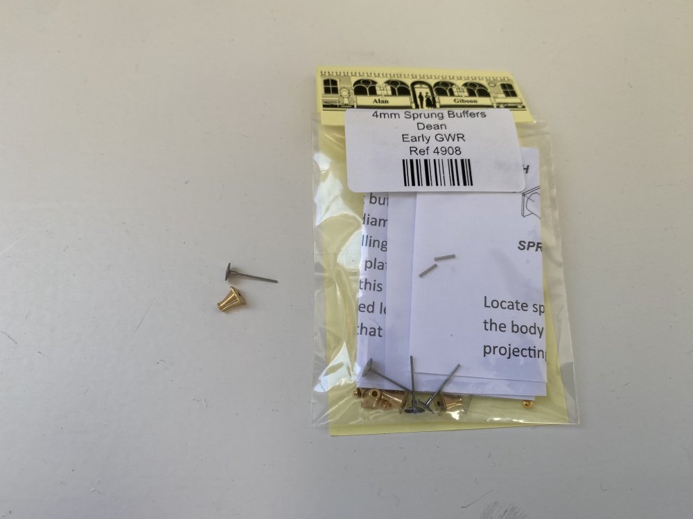

Buffers: Alan Gibson (workshop) : Part No 4908 Early GWR Dean buffers. I've found these a good match for some Irish locos.
http://www.alangibsonworkshop.com/

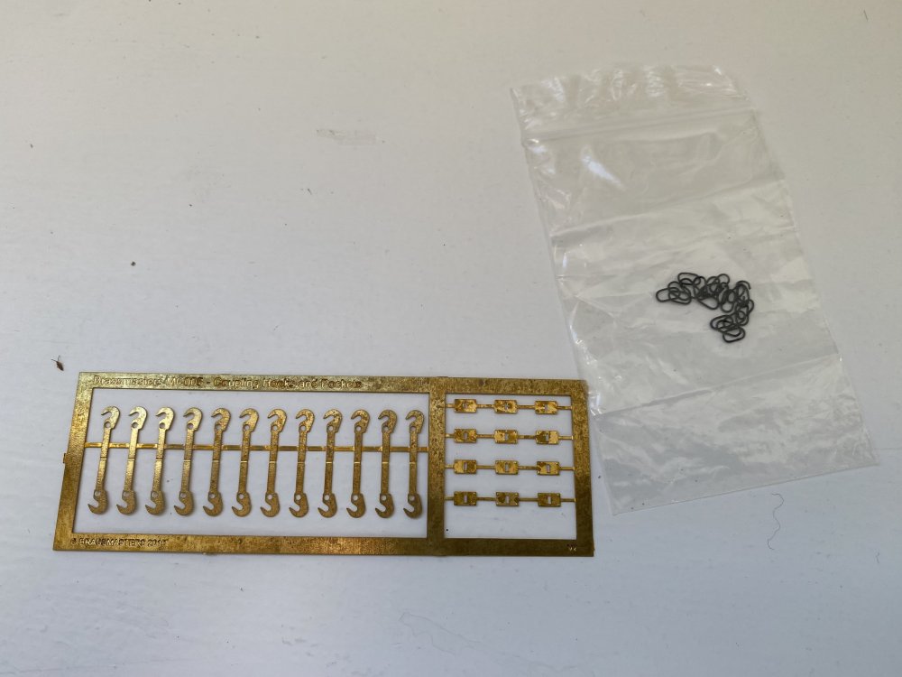

Hooks: Brassmasters etched hooks and chain
https://www.brassmasters.co.uk/3-link_couplings.htm

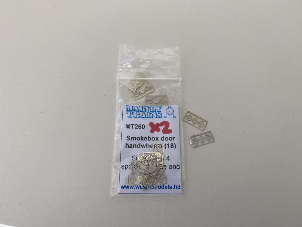

Smokebox door wheels : Wizard Models MT260
https://www.wizardmodels.ltd/shop/buildings/mt260/
