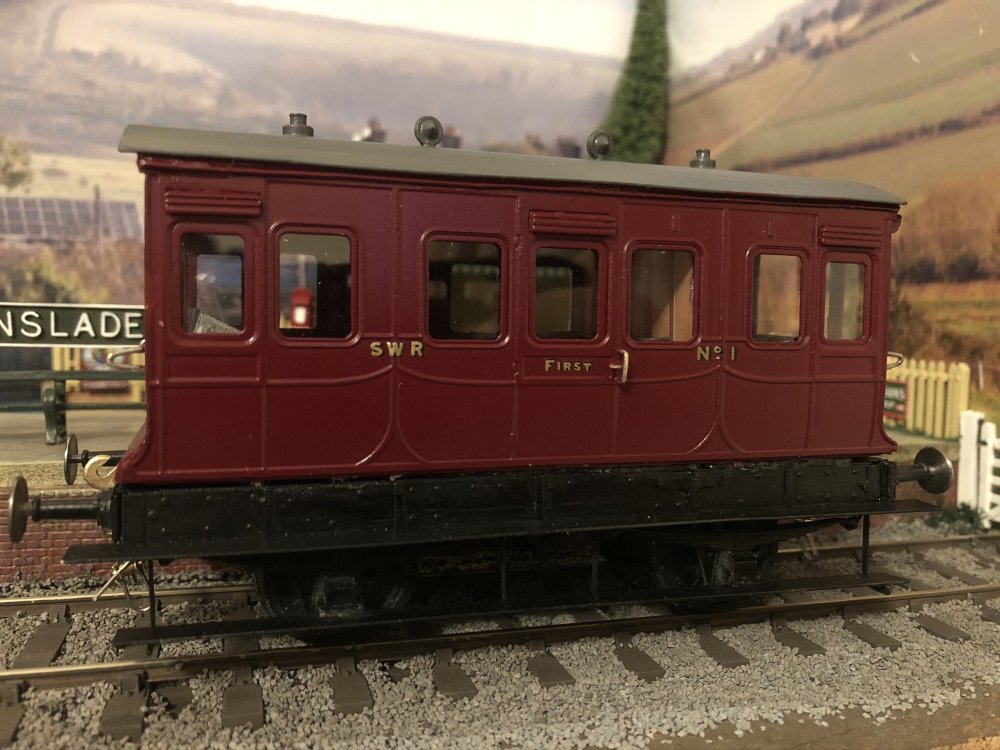

Galteemore Posted January 15, 2023 Posted January 15, 2023 I’ve used Rover damask red for that kind of thing. Any solid maroon should work ok. Make sure you use red primer. I think Halfords may call it ‘nightfire red’ now. 3 Quote
jhb171achill Posted January 15, 2023 Author Posted January 15, 2023 1 hour ago, Galteemore said: I’ve used Rover damask red for that kind of thing. Any solid maroon should work ok. Make sure you use red primer. I think Halfords may call it ‘nightfire red’ now. 2 hours ago, Pete00018 said: Thanks. I spent a good 20 mins looking at the the colour shades in MarksModels during the week, just wasn't able to find a faded maroon shade to match the LRTL tour photos. The etch primer and then maybe a spray and light primer might help lighten it before applying the livery. But will I've some brass frets to test on before applying anything to the body. Yes, the green on carriage 11L is also faded, that's another headache for later to see what colour to try match that up with Would you have a suggested what to use for normal GSR marron? Cannot seem to get the Phoenix Precision spray shipped over. I seen a recommended a Halford Rover maroon? {cant recall the one} on this forum, but couldn't find it stock in Halfords anymore. For GSR the above is a bit on the light side - the shade they (PLUS the NCC & BCDR, as it happens; I've seen actual examples of all three!) used was as close to 1920s LMS maroon as makes no odds. Any English supplier of authentic pre-British Railways colours could presumably supply that? By the way - Galteemore - what IS that absolute beauty of a coach? Quote
Galteemore Posted January 15, 2023 Posted January 15, 2023 22 minutes ago, jhb171achill said: For GSR the above is a bit on the light side - the shade they (PLUS the NCC & BCDR, as it happens; I've seen actual examples of all three!) used was as close to 1920s LMS maroon as makes no odds. Any English supplier of authentic pre-British Railways colours could presumably supply that? By the way - Galteemore - what IS that absolute beauty of a coach? Thanks JHB. Is an LSWR royal saloon (Alphagraphix kit) now sold on to a purchaser in SE England. Lovely little kit with compensated chassis, which I finished in a fictional light railway livery. The chariot ends were a challenge…..The real life one is here ;https://colonelstephenssociety.co.uk/rollingstock topics/royal saloon.html 1 Quote
