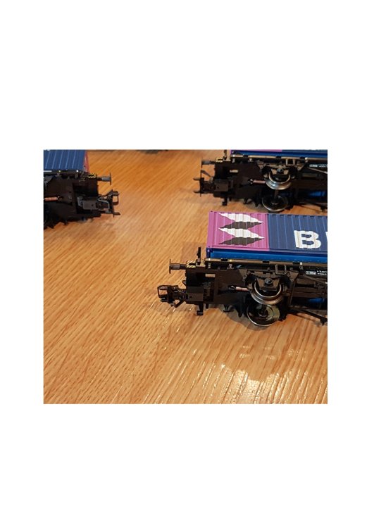

brianmcs Posted February 14, 2022 Posted February 14, 2022 Hello , can anybody help , is this an NEM pocket ? it is a Marklin wagon .
0 Thomas Posted February 14, 2022 Posted February 14, 2022 It looks like it is a NEM socket. Remove the coupling by pinching the 2 lugs that protrude out the back of the socket and pulling out the coupling at the same time.
0 Old Blarney Posted February 14, 2022 Posted February 14, 2022 Unfortunately, your picture is not perfectly clear. However, having expanded it as best I can, it looks like an NEM pocket! Question. Are there two small pieces of plastic which extend a small way out of the rear? These should be extremely close to the rear of the pocket and be pointing toward an axle. Pulling the tension-lock coupling out from the pocket (Gentle but Firm) should disengage it. If it proves to be stubborn, use a tweezer to pinch the two small plastic bars together and then gently pull the Tension-lock coupling free from the Pocket.

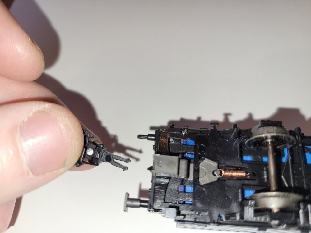

0 brianmcs Posted February 14, 2022 Author Posted February 14, 2022 Thanks for your help guys , does this photo confirm that they are NEM pockets ? 1
