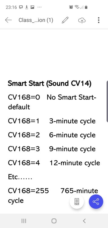

Sean Roberts Posted October 26, 2023 Share Posted October 26, 2023 Has anyone used the F14 sound cycle sequence using CV 168 to either setting 1 2 or 3, I have it activated but isn't actually doing anything, any info would be great 1 Quote Link to comment Share on other sites More sharing options...

0 Past-Avenue Posted October 26, 2023 Share Posted October 26, 2023 Hi Sean. I haven't changed any CVs but I did discover that when F14 and F15 are on the loco will notch up and then down regardless of the speed of the loco witch is a nice feature. Enda Quote Link to comment Share on other sites More sharing options...
0 Sean Roberts Posted October 26, 2023 Author Share Posted October 26, 2023 Thanks Enda, yeah I noticed that as well, definitely a nice feature. Not sure what is meant by smart cycle Quote Link to comment Share on other sites More sharing options...
