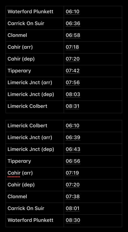

Not sure if a thread already exists for this line (if so I’m really sorry Mods and could you please move this post to that thread) but I thought no harm in having one!
I’m just thinking out loud about what can be done to increase line capacity and usage. Ideally services would be expanded to Limerick Colbert rather than just the junction and a service would leave both Waterford and Limerick with a pre-09:00 arrival at each end and a similar post-17:30 departure in the evening (this, in my opinion, should be the standard for all lines in Ireland, branch and intercity included…) However how achievable is this?
I did a mock timetable and it seems that with the addition of a passing loop and second platform at Cahir (or even just a loop outside of Cahir), the following can be achieved:
A train would leave both Waterford and Limerick Colbert respectively at around 06:00 and the two trains can pass each other in Cahir. The trains would provide a connection at Limerick Junction for:
  • Passengers from Waterford for Cork would join 07:00 Dublin to Cork (which calls at Limerick Jnct at 08:32)
  • Passengers from Tipperary, Clonmel (etc) for Dublin would join the 07:00 Cork to Dublin (which calls at Limerick Junction at 08:01).
  • Passengers from Limerick for Cork would join the 06:00 Dublin to Cork (which calls at Limerick Junction at 07:26) or would simply get the 06:55 Limerick - Limerick Jnct for a better connection time.
  • Passengers from Cork for Limerick would join from the 07:00 Cork to Dublin (which calls at Limerick Junction at 08:01).
These trains will arrive into the two cities respectively at around 8:30 each morning, before the beginning of the working day.

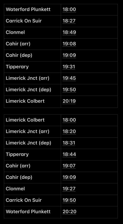

In the evening, the story is much the same with trains leaving both cities at around 18:00 and once again passing one another at Cahir. Each train would provide connections in Limerick Jnct:
  • Passengers from Cork for Waterford would join the Waterford train from the 17:25 Cork to Dublin (which calls at Limerick Junction at 18:23)
  • Passengers from Dublin for Tipperary, Clonmel (etc) would join the Waterford train from the 17:00 Dublin to Cork (which calls at Limerick Junction at 18:27).
  • Passengers from Cork for Limerick would join the Limerick train from the 18:25 Cork to Dublin (which calls at Limerick Junction at 19:26)
  • Passengers from Limerick to Cork would join the 17:00 Dublin to Cork (which calls at Limerick Junction at 18:27).
Both services would then reach Limerick and Waterford at around 20:20 or so each evening
Let me know if anyone has any thoughts on this, if it seems feasible, etc. Opinions and criticism (constructive please…!) would also be much appreciated.
Thanks all,
 Oisín  :))
Interesting thoughts there. It would definitely be great to see an extension of the current timetable, particularly between LJ and Waterford. The line could definitely be utilised more than it currently is, given that Limerick and Waterford both have large colleges and quite a few commuters.
I was only having a discussion last week about whether the semaphores are preventing increased services on the LJ to Waterford line but this doesn't seem to be the case - it may require the cabin at Cahir to be reopened and manned but I can't see that being much of an issue. I'm not sure if the number of level crossings (manned and unmanned) is one factor preventing a service being run during rush hour.
Would it be possible to adjust the timetable slightly to have the crossover at Clonmel, giving that it already has an operational loop (and platform/footbridge)? This could also tie in with the Bus Eireann service that stops in Clonmel (no idea of times though!)
Cahir would need a new loop re-installed and significant works to the existing loop platform - I can't remember if the footbridge is still there!
All hypothetical but it would be nice to see 🙂
