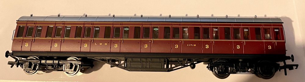

leslie10646 Posted October 10, 2024 Posted October 10, 2024 Are these not better still? https://www.themodelcentre.com/r4800pre You could just stick NCC on them and off you go - at £30 a go, they're a snip. OR: I think this was the coach which which supposed to be like a "Larne Steel". Certainly they are also similar to the coaches JB's Dad took in a moment of dereliction? Hornby R4657A. This one cost me £25 at a Warley event, but they seem to be much dearer now, even if you can find them! I must put this one into service! 4
jhb171achill Posted October 10, 2024 Posted October 10, 2024 4 hours ago, leslie10646 said: Are these not better still? https://www.themodelcentre.com/r4800pre You could just stick NCC on them and off you go - at £30 a go, they're a snip. OR: I think this was the coach which which supposed to be like a "Larne Steel". Certainly they are also similar to the coaches JB's Dad took in a moment of dereliction? Hornby R4657A. This one cost me £25 at a Warley event, but they seem to be much dearer now, even if you can find them! I must put this one into service! Very much so, Leslie! 1
