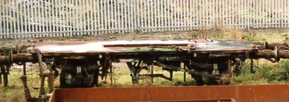

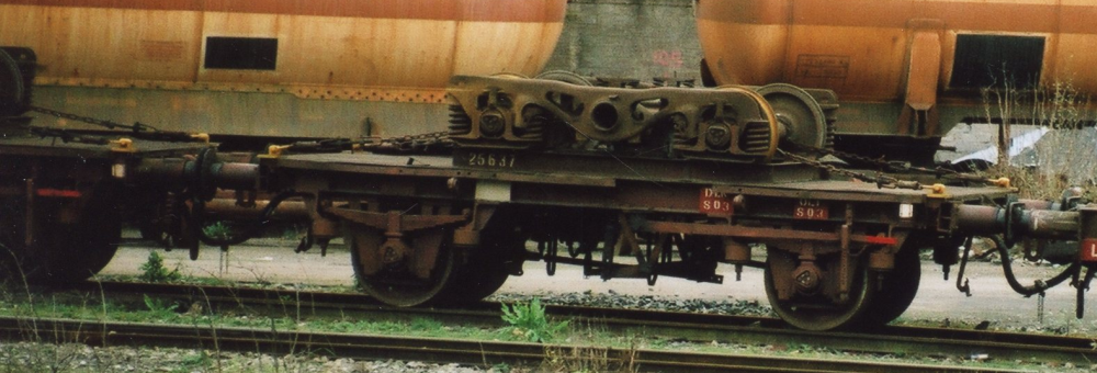

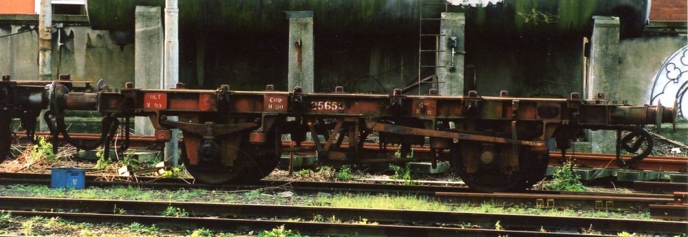

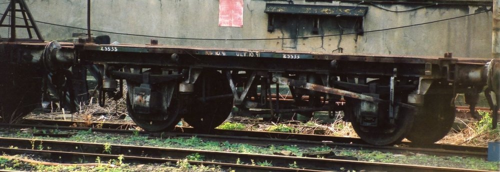

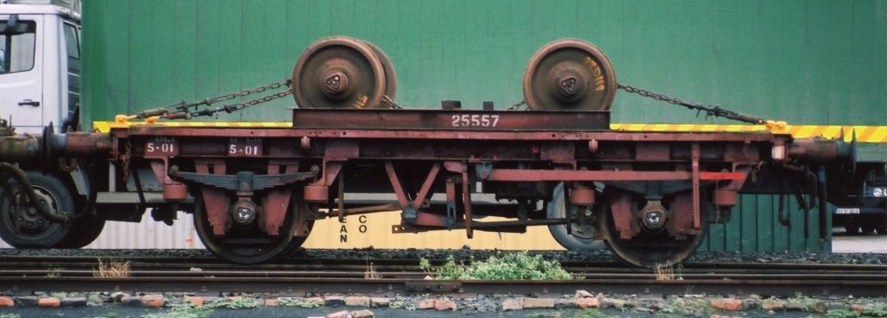

Mol_PMB Posted December 18, 2024 Author Posted December 18, 2024 Here are some of my own photos from the early 2000s. Firstly, here is 25533 and if I recall correctly it was in the sidings at Grand Canal Dock for several years in the late 1990s and early 2000s. The 98th wagon of the batch, it still has plan bearings but has either lost (or never had) the chain pockets and pivoted spigots. An interesting feature of these wagons was that there were two brake shoes, both on the same side (cement bubbles had 4 brake shoes, or even 8 on the first batch as built). Here we are looking at the side with the brakes; the vee hanger is slightly offset to the left of centre and the vacuum cylinder is on this side. Referring back to the three photos in the previous post, they all show the unbraked side, with the vee hanger offset to the right, no vacuum cylinder and no brake shoes. Also of note is the chequerplate floor with its angle-iron edges; in this case the number and overhaul data is painted on the angle-iron. Subsequent container flats didn't have floors at all, as they were only designed to carry loads on the ISO spigots on each corner. Lurking in the background of this photo at Limerick in the early 2000s are a couple more, unidentifiable I'm afraid. The one on the left still has its chain pockets and pivoted spigots, while the one on the right does not. The one on the left sows the arrangement of levers on the brake cross-shaft better than some images - see the cruel zoom below. Note that the handbrake is applied. Â Now to some lightly modified wagons, still basically flats but with some extra features. Firstly here are two views of 25557 modified as a wheelset carrier and seen at Limerick works. This shows the underframe details and the braked side quite well. This wagon has roller bearings and no longer has chain pockets or pivoted spigots (maybe it never did). The ISO spigots have been adapted as shackle mountings for securing the load. Here's 25637, another wheelset/bogie carrier seen at Cork. The unbraked side this time. And finally for now, 25653 which has been converted to carry the later style of Guinness cages by the addition of more ISO spigots. This one has required a small chassis extension at each end to prevent the load overhanging the ends of the wagon: As far as I am aware, none of this series of wagon was modified with extra spigots to carry 10' containers. It was either the original 1x20' box, or 3xGuinness cages. 1

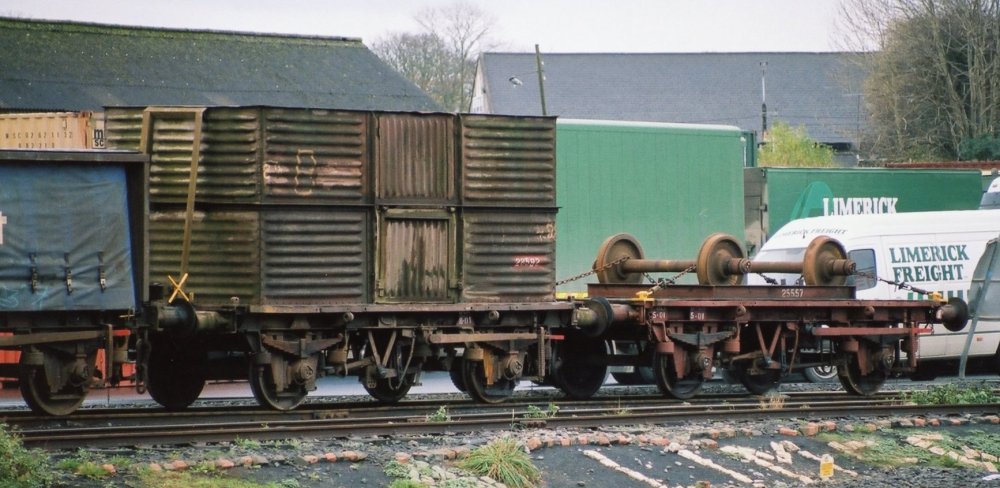

Mol_PMB Posted December 18, 2024 Author Posted December 18, 2024 The 25436 series flats also seem to have found brief use carrying pallets and palletised goods in open-top containers, as shown by these mid-1970s photos by Jonathan Allen and the IRRS archive on Flickr. I think this is fertiliser, and presumably this traffic was transferred to the dedicated palletised fertiliser wagons when they were introduced: https://www.flickr.com/photos/152343870@N07/40234864872 https://www.flickr.com/photos/152343870@N07/40234864722 https://www.flickr.com/photos/irishrailwayarchive/53527323416 https://www.flickr.com/photos/irishrailwayarchive/53511479228 We've already seen that the mechanical engineers adopted a few for moving wheelsets and bogies around; here's another variant on that theme by Jonathan Allen at Inchicore in the late 1980s: https://www.flickr.com/photos/152343870@N07/52043022146 But the S&T people took a lot more wagons for their cable-ploughing train which was involved in many resignalling projects. Here are some early 1980s photos by Jonathan Allen and the IRRS archive on Flickr: https://www.flickr.com/photos/152343870@N07/50880724581 https://www.flickr.com/photos/152343870@N07/49565356217 https://www.flickr.com/photos/irishrailwayarchive/53527641434/ Â

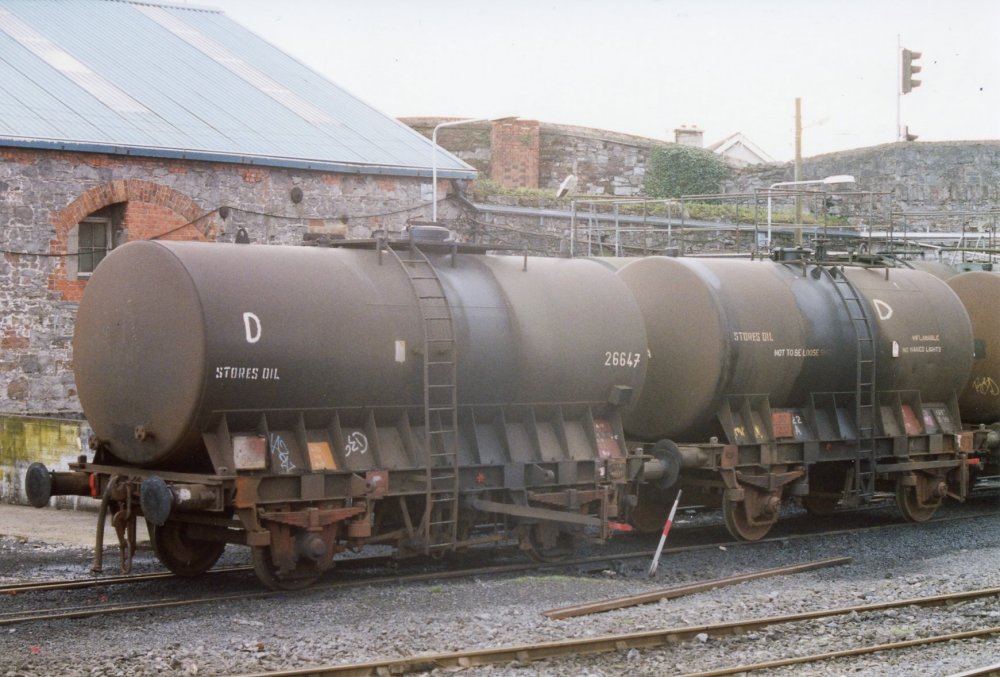

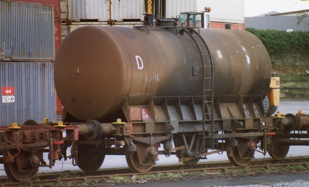

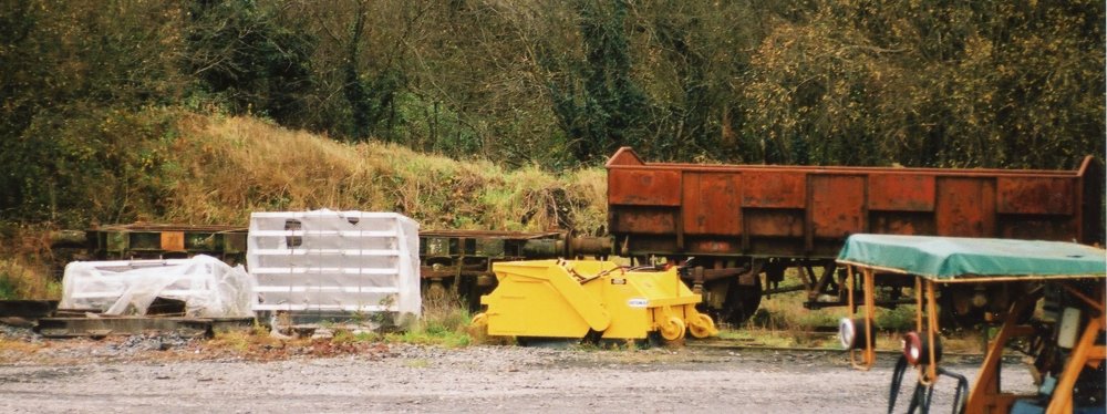

Mol_PMB Posted December 18, 2024 Author Posted December 18, 2024 Bearing in mind that there were over 500 of the 25436 series flats built, what happened to the rest? Well my understanding is that most were 'kitbashed' into other wagon types such as beet wagons, pallet cement wagons etc. I don't have any official data though - can anyone else fill in this part of the story? As far as I can tell the 25436 series all had 'W' iron axleguards rather than the plain triangular plate type, which may be a useful spotting feature for later re-use. For example, this tank wagon 26647 could be on a 25436 series chassis: Â Â

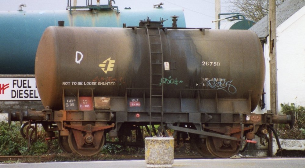

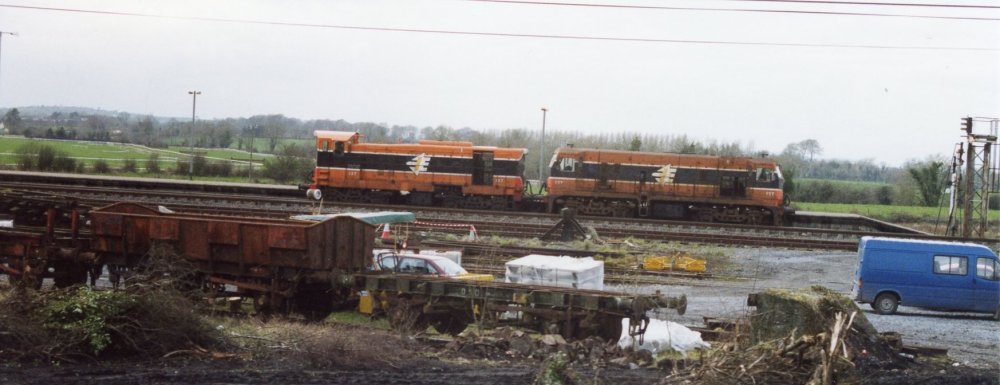

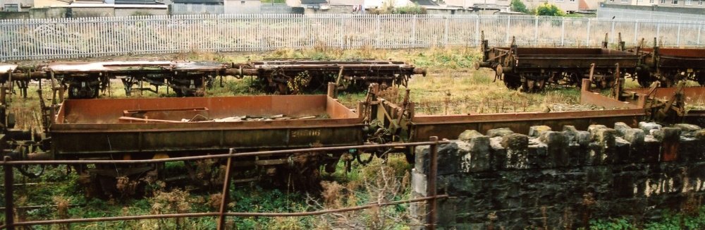

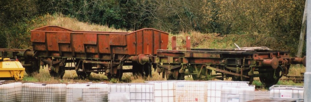

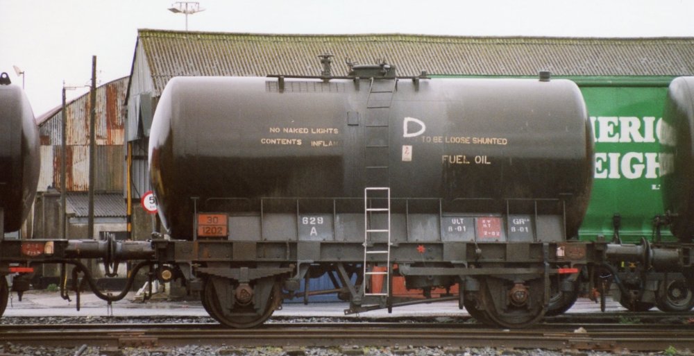

Mol_PMB Posted December 18, 2024 Author Posted December 18, 2024 With only 200 built, these were scarcer than the previous series but still more numerous than the cement bubbles - just less obvious! Going back to my holiday snaps, here's a late survivor in the foreground at Limerick Junction; not the best photo but the ISO spigots, lack of floor and plate axleguards confirm that it is a 27101 series: Also at Limerick Junction, this one has been somewhat modified: Here's the other side of the black one, trying to hide: Â I suspect many of these were modified into other wagon types, but again I don't know the exact details. Looking at the chassis details, these tank wagons could be candidates: 613A: 26750: 629A (also 633A, 622A very similar): Â
