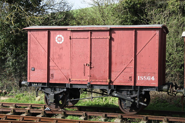

Mike 84C Posted October 18, 2014 Posted October 18, 2014 Would anyone know what the H vans wheel base would be? It looks quite long in photographs and is there any drawings in New Irish Lines before I trawl its archive?
0 Glenderg Posted October 18, 2014 Posted October 18, 2014 (edited) Mayner of this parish posted this photo some time ago, and it works out as 17'4" over headstocks and a 10' Wheelbase. Richie. Edited October 18, 2014 by Glenderg photo link added
0 Mike 84C Posted October 19, 2014 Author Posted October 19, 2014 Thank you very much Glenderg, I asked because they always look as if the wheelbase is more than 10ft, perhapse its because most photographs are taken from an angle and the low roofline decives the eye.
0 Mike 84C Posted November 19, 2014 Author Posted November 19, 2014 Nelson, Glenderg posted this picture that Mayner had posted of an H van which may help you.
0 leslie10646 Posted November 19, 2014 Posted November 19, 2014 To all intents and purposes, this van is the same size as the ex-GN Bagged Cement van which I have sold about 450 of! Same wheelbase and body size. There the similarity ends - the chassis and brake gear are different, the roof flatter and it has "plain" corner strapping - the cement van had a slopping corner strapping on the sides. The corrugated iron ends aren't necessarily wrong, if you simply repainted one of the RTR vans, as I believe Inchicore often used whatever they had to hand and if they were out of sheet steel but had corrugated ....... There's a good pic of one on page 71 of Locomotives and Rolling Stick 2nd Edition. All that said, this van is on my radar, with proper chassis, if you can wait a year. Leslie
0 StevieB Posted November 19, 2014 Posted November 19, 2014 That's music to my ears Leslie - I'm in waiting mode already. Stephen
