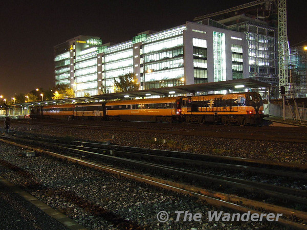

There are only the standard MKIII Restaurant (7401-7413), The 1900 Inchicore - Heuston transfer operated this evening to transfer 6303 and 7402 to Heuston along with Van 1162 for brake force. 190 operated the transfer and can be seen at the end of the train. 144, nearest the camera is waiting to shunt release the stock to the carriage sidings. Thurs 23.10.08

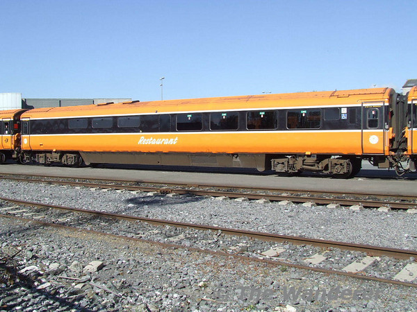

and that of the MKIIIa Cu Na Mara set, 6401 - Mk3 International dining car 6401 stands in the Guinness siding at Heuston prior to working the 1240 to Athlone. Wed 18.04.07
Both are completely different vehicles with the 7401-7413 being the standard unit, generally speaking.
