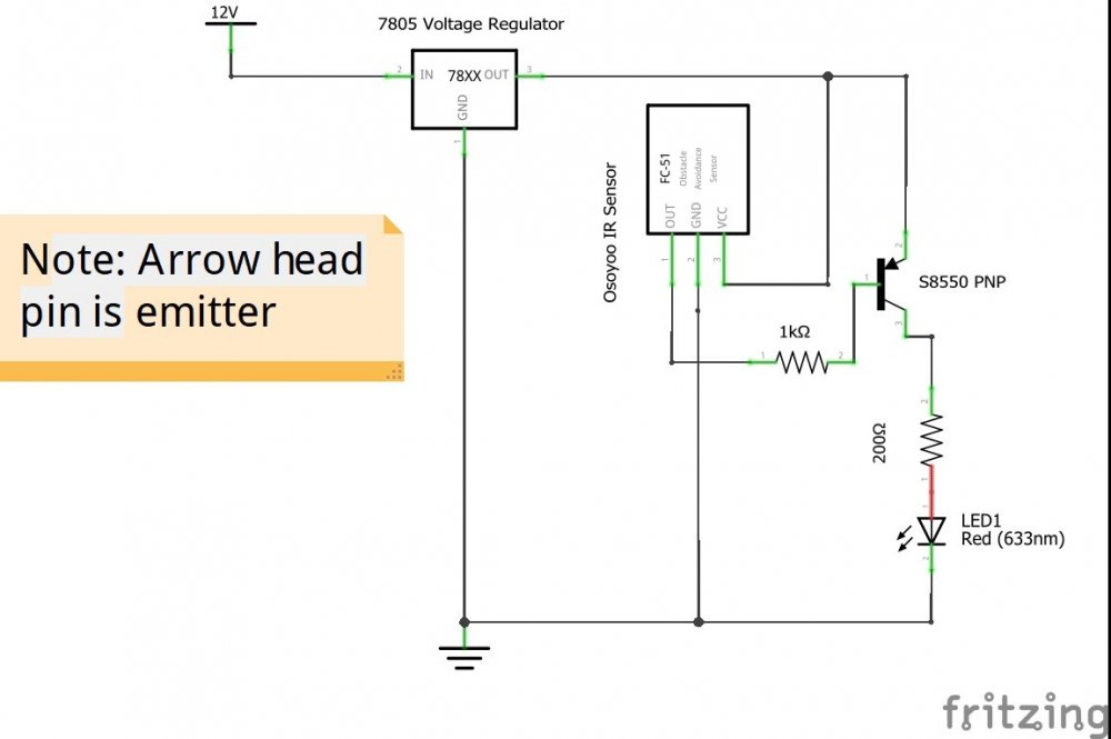

Below is the detailed circuit diagram.
What does it do?
With S1 or S2 = 0 (no train detected) Transistor T1 and T2 are on because current goes to base (b) of transistor and turns “on” the collector-emitter (c-e) circuit thus the relay coil gets 9v. The relay is wired to either side of isolated section on branch-line through the common (CM) and normally open (NO), which is an open circuit, but because the coil on the relay is active the relay switches and the CM-NO circuit closes so we have power to the isolated section.
So this is the normal operating state of the circuit, relay coil active and thus power to isolated section.
Now when a train passes over S1 or S2 (S1, S2 =1) the infrared light from the diode on the left of S1 (the triangle thingy) is reflected back to the right hand side and this activates the transistor circuit in the sensor to “on” so now current is diverted from the base of transistors T1, T2 to ground. This switches off the c-e circuit so no current passes thru the relay coil, which is now in its off state so the CM-NO circuit is now open and no current flows to isolated section.

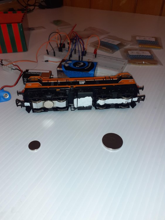

There are some problems with this in practice, the photo-sensor doesn’t work so well on the black undercarriage of our models…so I had to paint them white.
