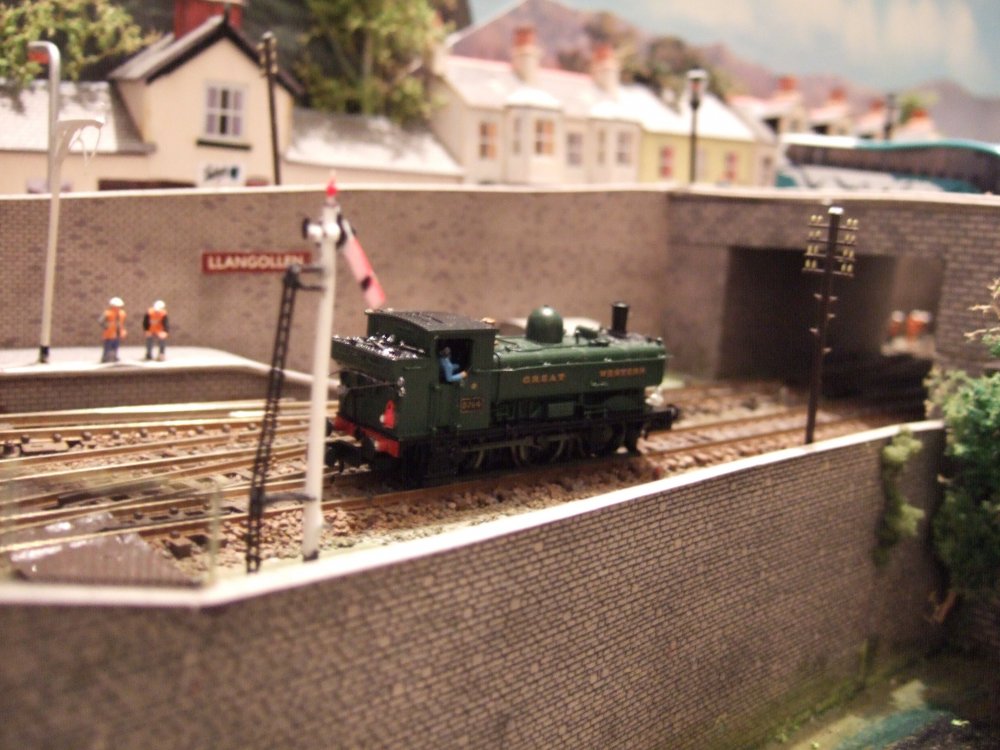

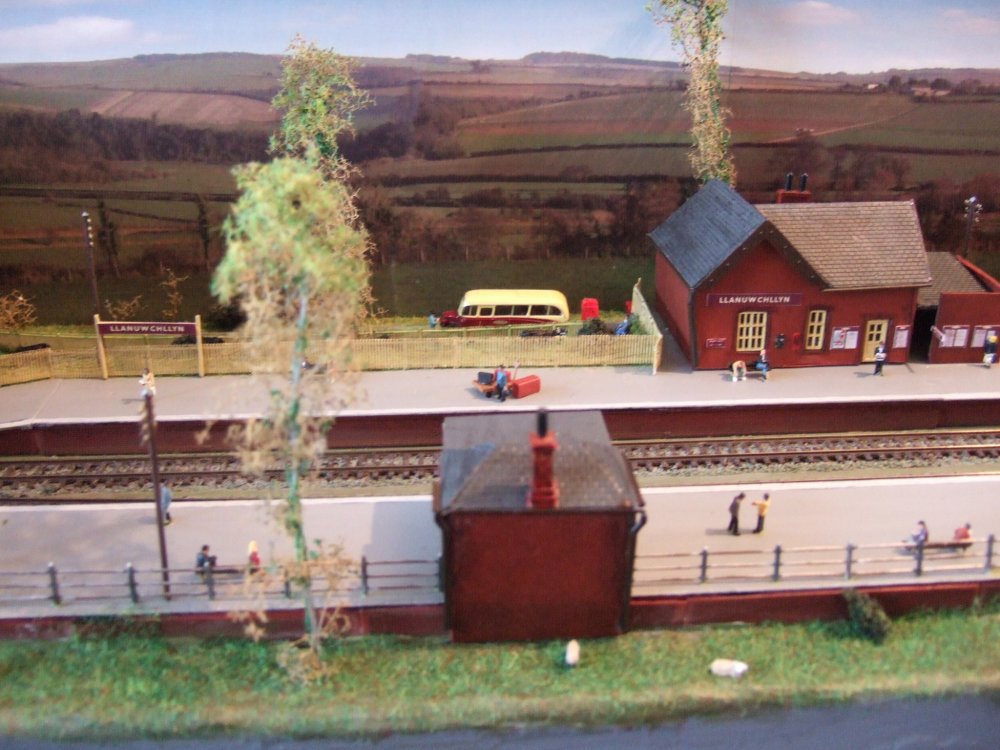

Metcalfe building cards are fine (I used them in 2mm for my Llangollen layout) but if you want relief then the Wills sheets look good in 4mm (I have used them on my 2mm Llanuwchllyn layout). Wills are thick plastic sheets which are more difficult to cut then Metcalfe which can be cut with a scissors.

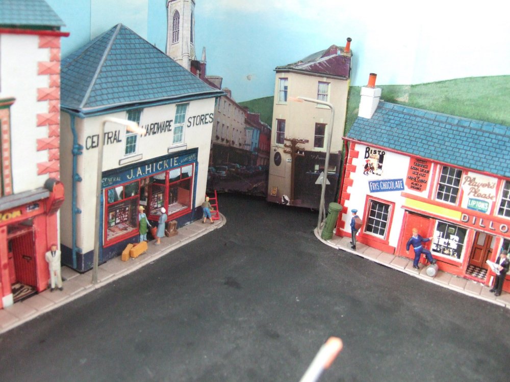

Just be aware also that card structures should not be exposed to prolonged sunlight as they can fade over time. I keep the blinds down when the sun is shining into my model railway room. Many of my buildings on Ballybeg are of card construction and still look good after 10 years!
